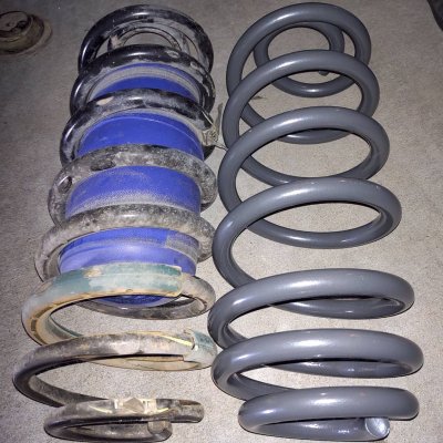

Yanked out the stock springs with Firestone airbags.
Popped in some cargoMaxx HD springs.
Did an oil/filter change.
Tire rotation.

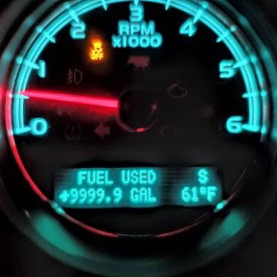

And found out how many gallons I've put in this thing.
