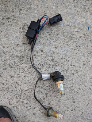

Gotta give a high-five to @kbuskill for the help, blue to blue and red to ground worked! No more led hyperflash on the Yukon only took me 3yrs to do finally do it, lol I soldered those on and ziptied it to the light harness, good to go
:Handshake:
I am glad you finally got it working properly... good job.

I wasn't sure how those resistors were wired inside it didn't make sense to me to run 2 hots with 1 as a ground and I had already blown a fuse, so finally....I'm so used to hyperflash i'm going to think somethings wrong now haha, doesn't help that i'm part idiot but I get by ok usually.
