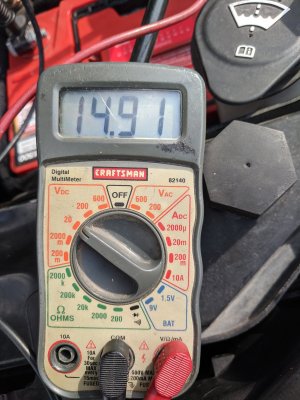

So as a experiment this morning I unplugged the RVC plug to see if my batteries would charge up beyond 12.26v since I had some things to do today, sure enough they went up to almost 12.6 this was after settling for 10-15 minutes, last summer I picked up a nice 1/0 gauge battery cable at the flea market for $5 so yesterday I went by the battery store and had them cut the top post connector off and put on a copper connector so I can replace the smaller factory alternator cable, cable came out real nice and only cost me $23 total and that was because I had to buy a 4 pack of connectors at the hardware store to get the 1/0 size I wanted and the battery store only charged me 2.50 for the shrink wrap and labor to do it right. The new cable has 1/2 ohm less resistance than the old factory cable so I don't know how much difference that will make but I'm going to leave the RVC harness off for now and see how it goes while I wait for the charger to arrive, the mechman is putting out plenty of juice.
View attachment 244335 View attachment 244336 View attachment 244337
It not for reduced impedance (resistance), it's for higher ampacity over the stock wiring, which has been proven to be undersized even for a stock setup. If your DVOM could measure the impedance using ~100 amps at 12-14 volts, it'd be a lot more of a difference than .5 ohm.

ya that was the only method I had to check what the difference is beside weight, it's a nice stout cable, tired of getting low battery warnings after only having the key on a few minutes, always starts fine it just complains to me lol
