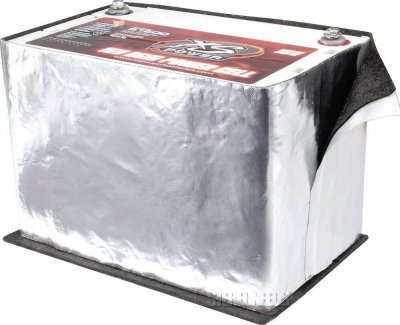

Ordering a couple of these for my 2 battery's to see if it helps at all with my charging issue, dropped off both AGM's to be load tested overnight and picking up the Yukon from the dealer here in a bit, they said they updated all of the "calibrations", I was told initially the one I requested specifically (charging/energy storage) was for the heated seat's, but I questioned that and still no clear answer I guess until I get over there and look at the paperwork.

I just figure even if it helps a smidge better than nothing, I haven't ordered yet I see there is a few different options including a Corvette one that may be better

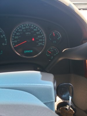

The way they program the charging system is weird to say the least. This was at lunch today, I know it's not quite up to operating temp, but it was 95 degrees when I snapped this picture. Both cooled seats on, both front and rear A/C on full, fogs on, and engine cooling fans were on high. The voltage was where I like it with all that load on. However, later today, it was back down to around 12v or a little above sitting in traffic under the same conditions.
