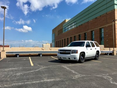

Here’s my wife’s Tahoe in question. Used to be lifted.
View attachment 224786 View attachment 224787
