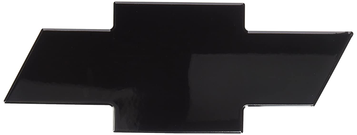

And thanks @HiHoeSilver for helping me spend $30 on a black billet bowtie for the grill...it will be here Sunday.
Black billet ftw..

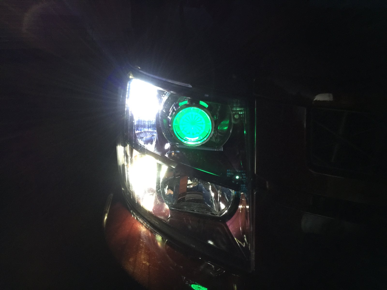

Here's the cutoff at ride height . The demon eye pics will have to wait, it just started pouring. I was relieved that the projectors stayed perfectly level after epoxying them in place.View attachment 194825
Looks good and cut off seems crisp for MH1. Not sure what the flare up in right hand corner of picture is from... The gap between steps at 25' should equal gap between center of each projector. So centerline of projector to projector is 55" then at 25' the step peaks need to be 55" apart. Then when you back up to 100' they are set straight and don't spread apart or come together. Yours appear correct but sharing for others who might take on a retrofit.

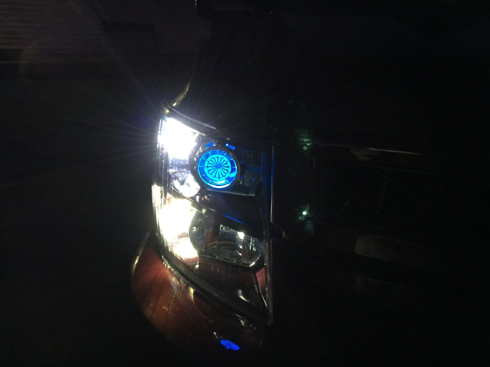

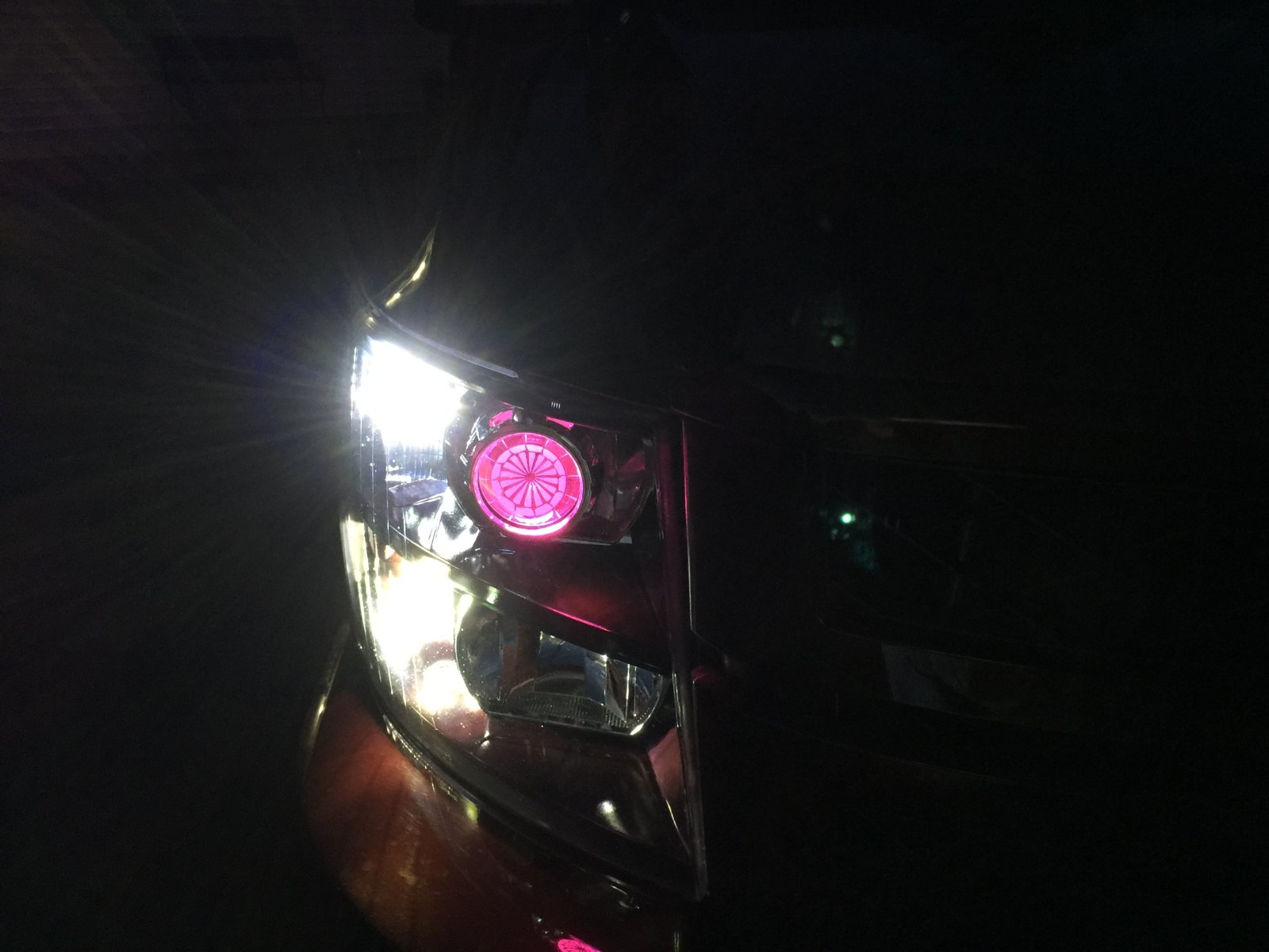

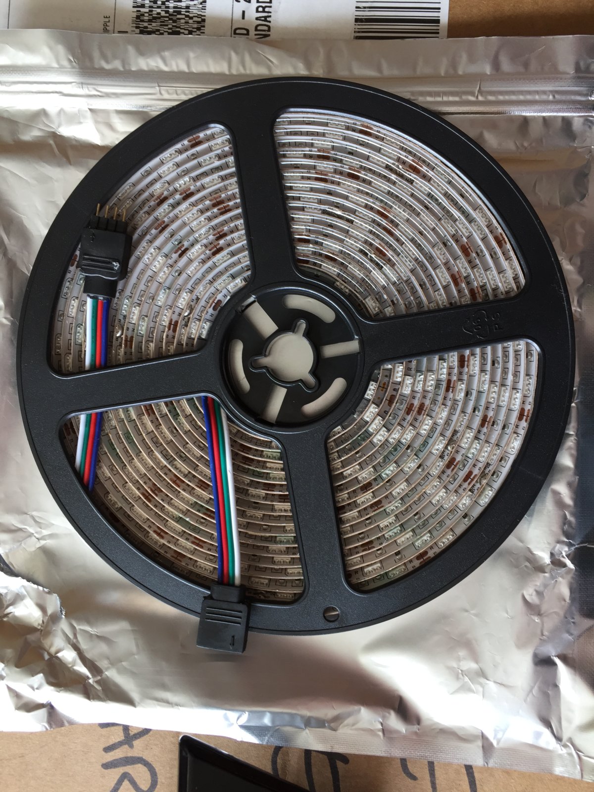

I also got an RGB led strip in today but the connectors I ordered ended up being micro JST instead of regular size so I reordered them. I plan on messing around with the Bluetooth controller for my demon eyes and maybe start with some behind the grill coloring for a start. I still have 2 separate channels with several connectors each to hook leds up to. I can run different colors on each channel or match them all. It’s cheap to play around with since the controller was the expensive part. I'll just solder connectors onto whatever length strips I need.

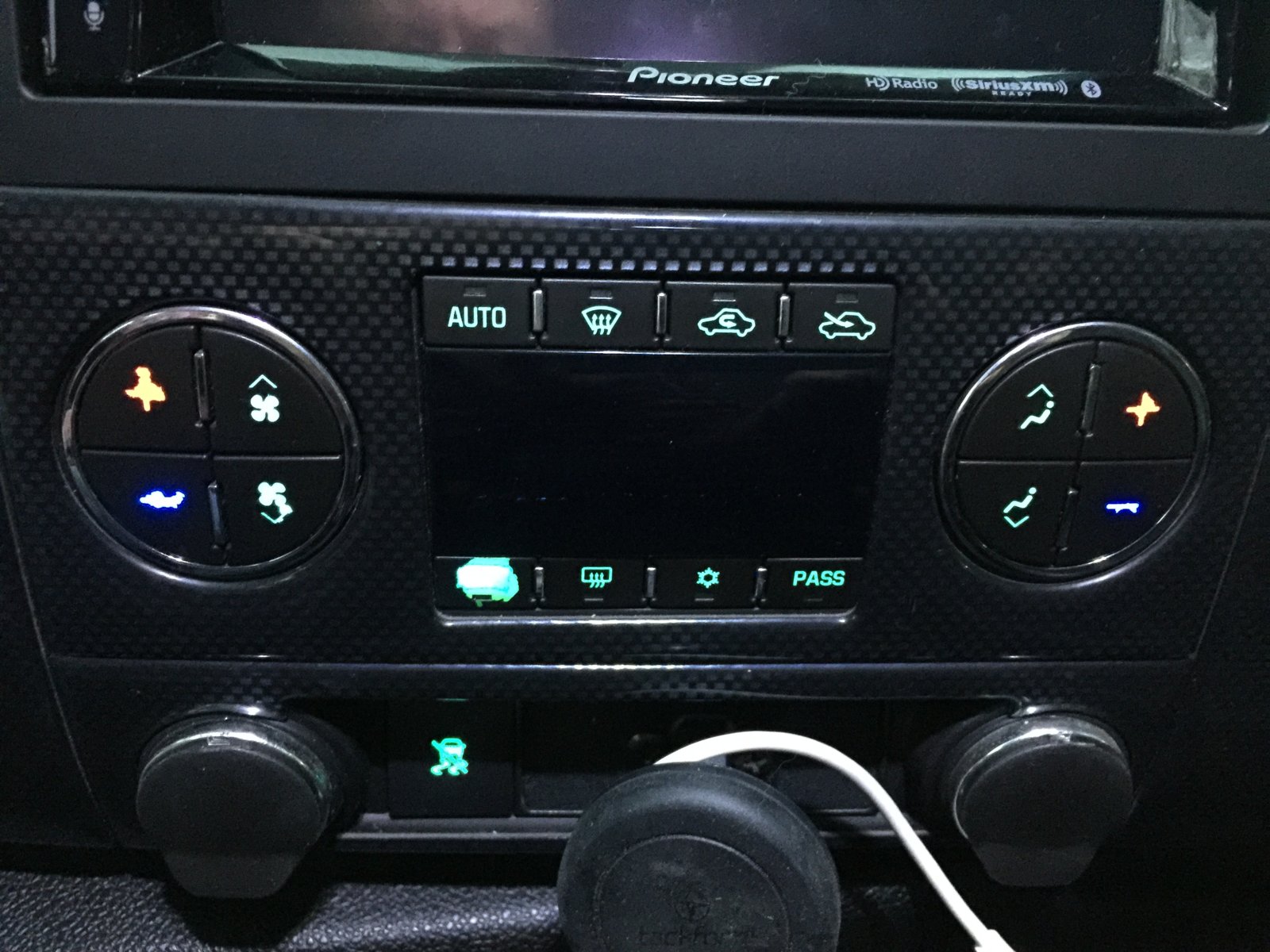

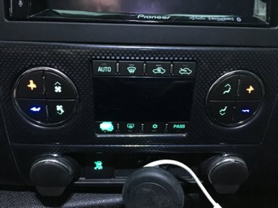

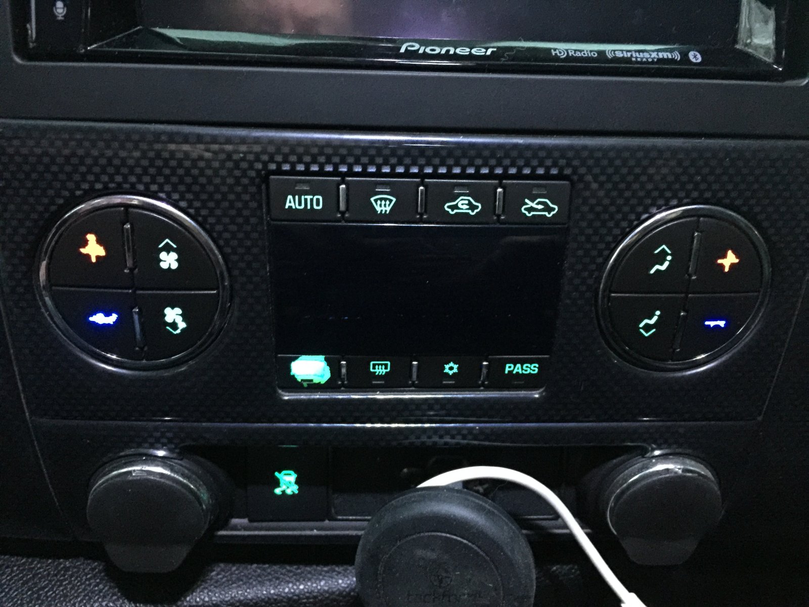

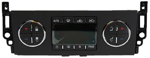

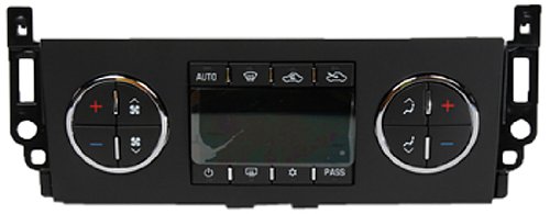

I got lucky with The Beast today and found out all that was wrong was a couple plug wires got burned on the headers right through the heat boots so as a reward I decided to buy a new HVAC control panel since mine has the worn off button look that is common. I had been looking on Amazon and I knew one was about $147 but I decided to see if there was an open box one and found a "used like new" one from Amazon Warehouse for $98. I had been looking at the stickers and read they are OK until the lights come on, which I suspected. Plus I didn't like the idea of stickers on the buttons.
View attachment 195009 View attachment 195010
I went with the stickers on the buttons and have no complaints they look great and still light up just like before. Just FYI.

Those demon eyes look sick!
I vote for a little accent lighting behind the grille I think that will really help set it off.
