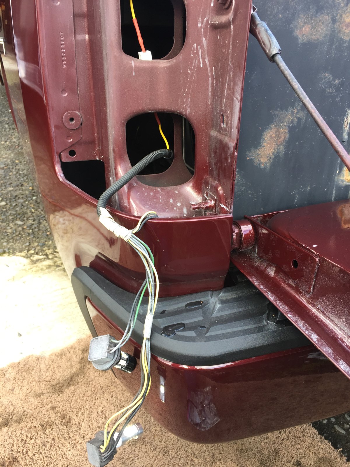

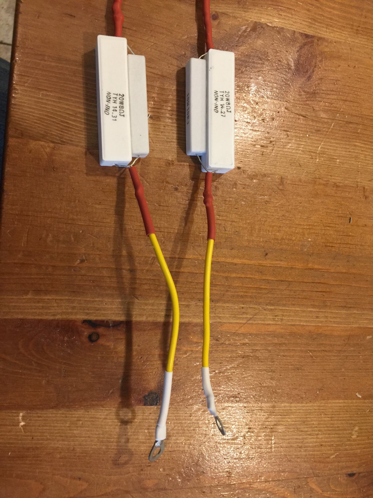

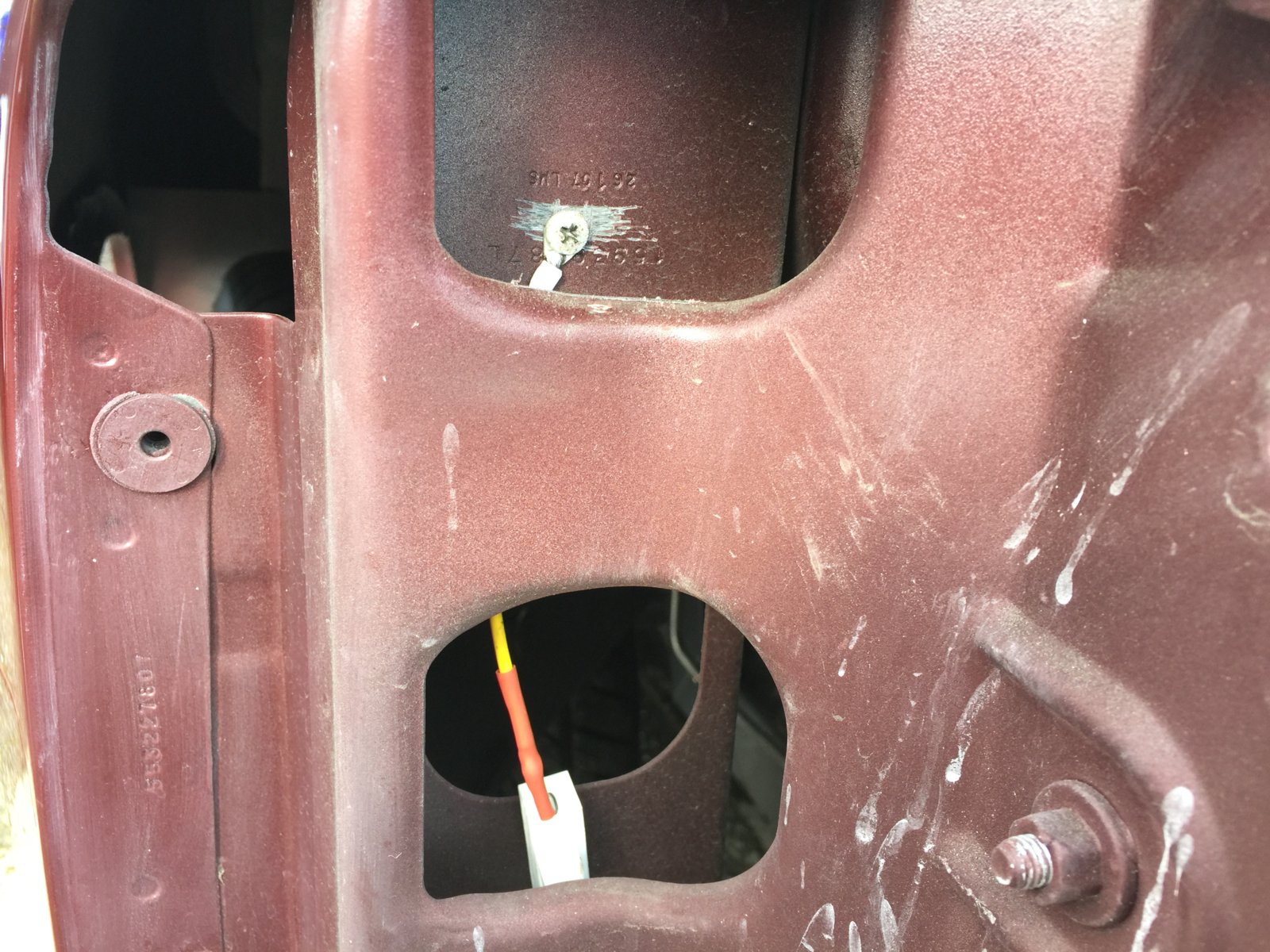

I decided to fix my hyperflash I've had since converting the tails to LED. I had tried adding a normal resistor made for it which I believe was 6 ohms but it had no effect. I found a YouTube on the NNBS Silverados and it said to use a 10 ohm and an 8 ohm wired in parallel so I had ordered some ceramic wirewound resistors from Radio Shack and followed the instructions. I think since the Silvys have 2 turn signal bulbs in each tail light they need more resistance. I mounted the resistors between 2 panels behind the tail lights so they can't melt anything if they get too hot. It worked like a charm, no more hyperflash.

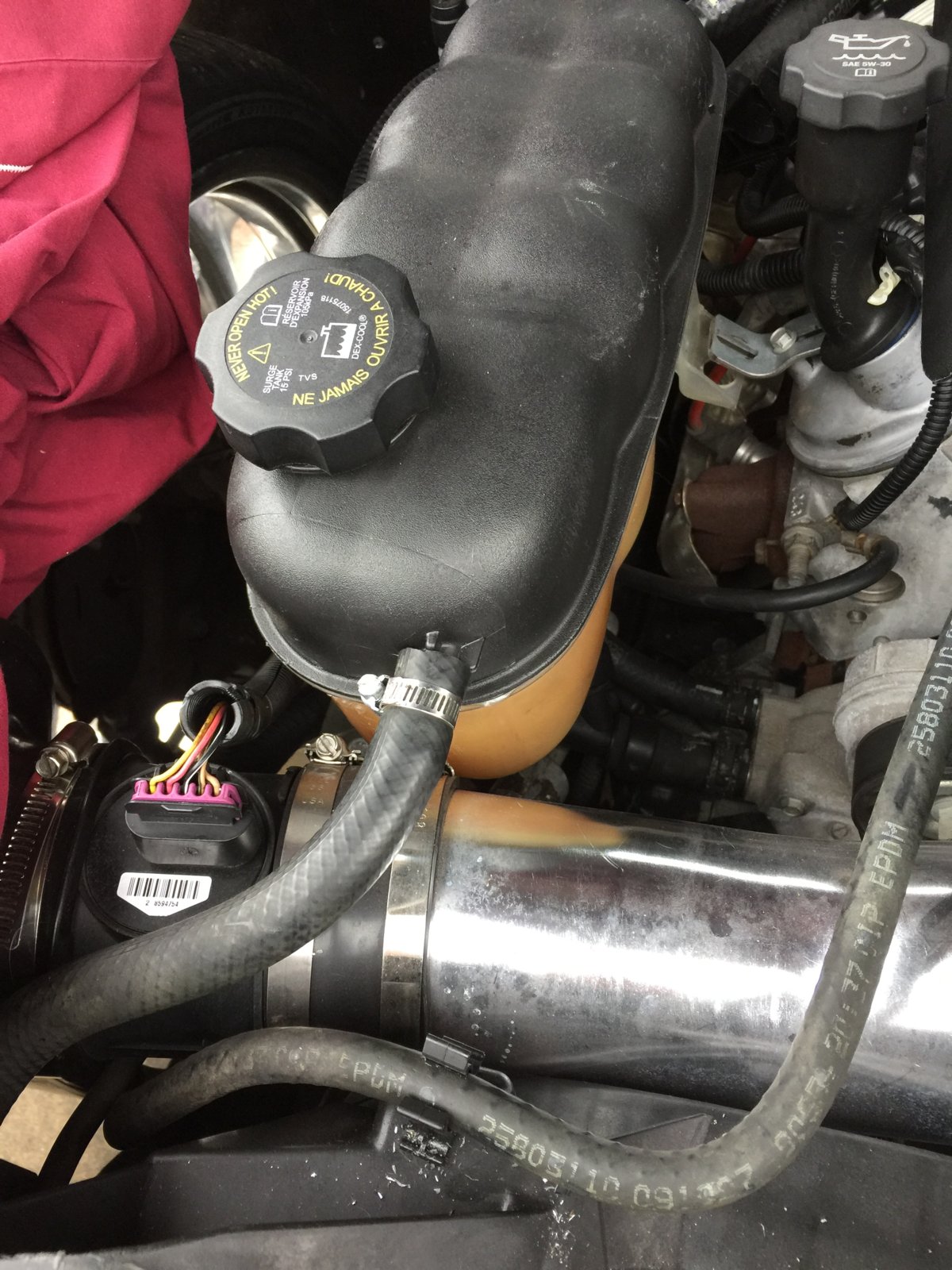

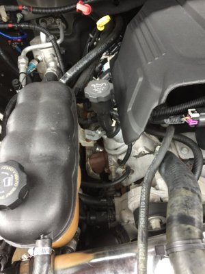

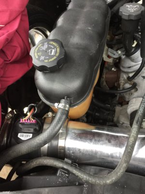

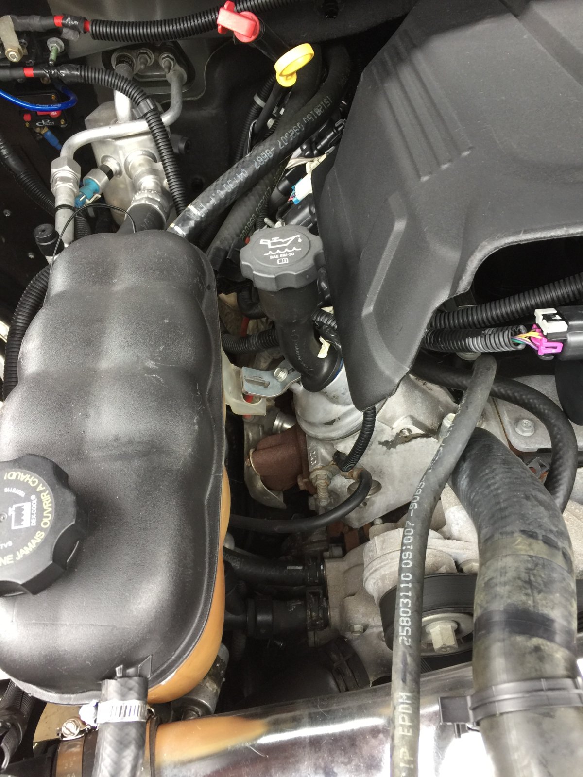

BlackBear got back to me about my tune they're working on and said my IAT's are showing as 200-220 degrees and asked to see my intake. I sent them pics and they got back to me today. I didn't realize that on the NNBS the IAT sensor is incorporated into the MAF sensor and so the mystery is solved. My coolant overflow tank has been relocated due to my wheel tubs and that placed it right next to the MAF/IAT sensor, almost touching it in the position it was in. Which of course is giving it false readings. So I attempted to see what I could do as far as rotating the sensor away from the tank and I think I might be able to make it work, or maybe use some insulating product to separate them. In the process I found out the bracket someone had fabbed to hold the tank was missing a bolt and the tank wasn't solid anyway. The bracket was all kinds of wrong so I re-fabbed it but I ended up breaking the bolt that goes into a valve cover boss and gave up for the day. It started snowing on me and my hands were frozen. I'll figure something out. There isn't enough room to relocate the tank much further away but I'll see what I can do. I'll hook up my Tech 2 and monitor the IAT after I fix the problem and see if I can get the reading down. In the picture, I've rotated it so it's up. Before it was horizontal, touching the tank. I have header wrap I think I'll try.

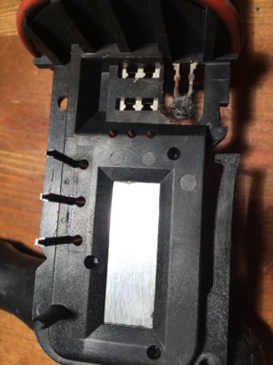

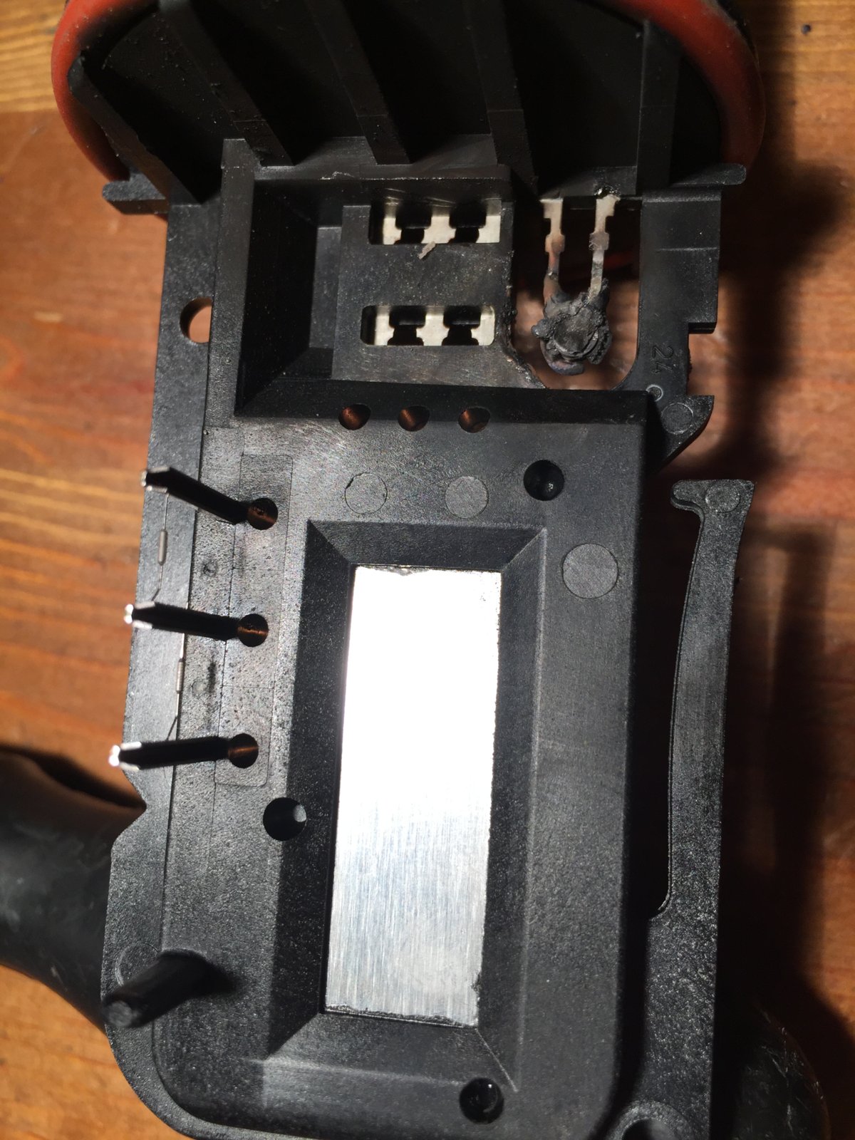

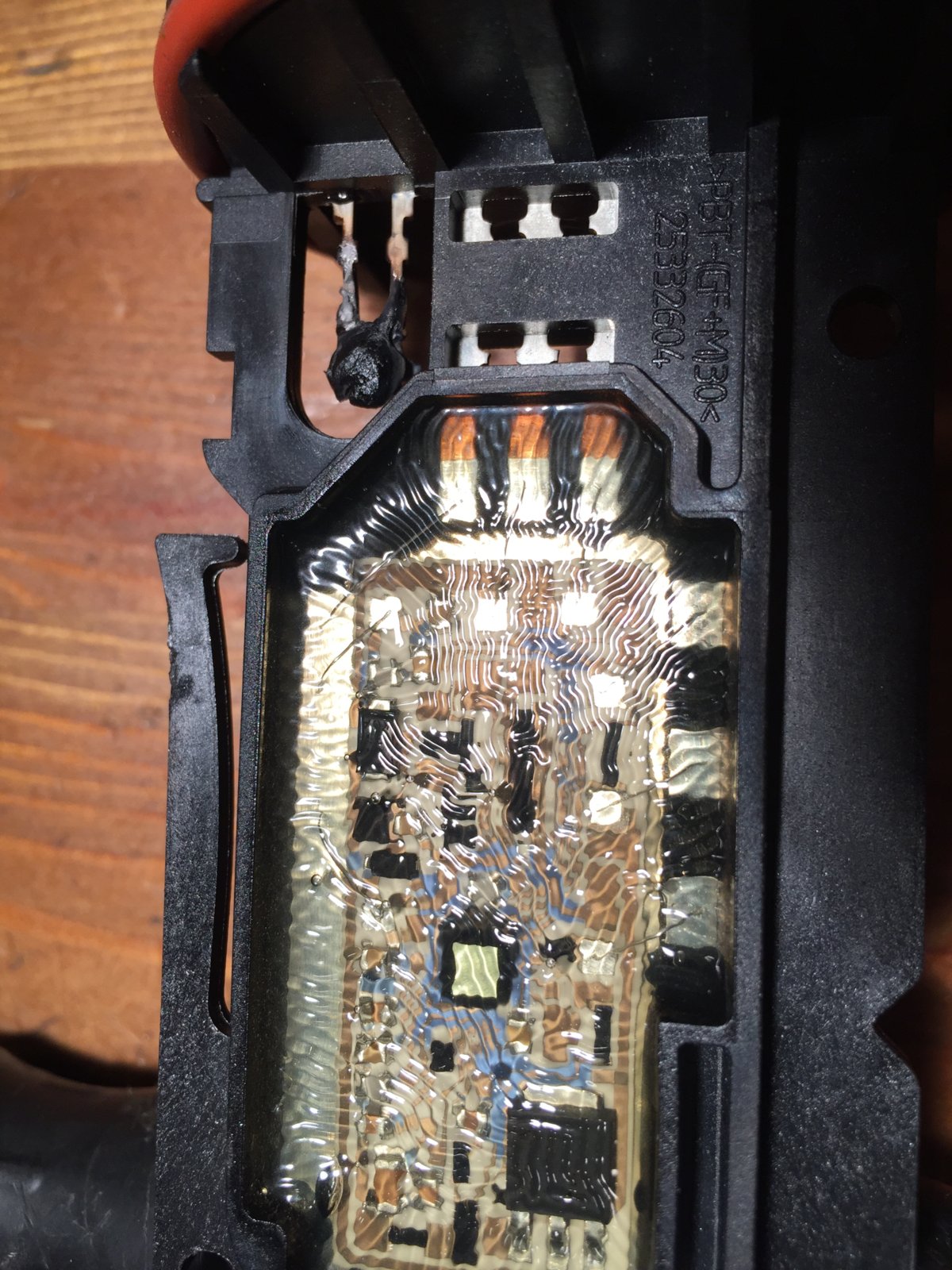

I decided to go look at live data and mess with the IAT sensor. It didn't take me but a minute to decide it was a bad sensor; it read 220 degrees when the truck was cold. I checked the wiring, then unplugged it and it went to -30 like it's supposed to. Went inside and ordered a new sensor. Then I decided to double-check that it was the sensor and the guide I was looking at said to test between pins 1-2 and it has resistance values for temperatures and the sensor showed 120 ohms which meant it should read 220 degrees which it did but it was inside my house and it was 68 not 220 lol. I pulled it out of the housing and there it is- a fried sensor. The thermistor is definitely bad. It's that little crispy black thing that directly connects to the 2 pins.
