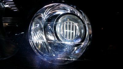

Old and busted, New hotness:
Old pattern on the left, new on the right:
And here is both with the new:

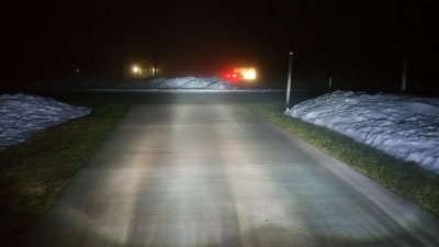

The new lights have a lot less spill above the cutoff, and it looks nice and sharp compared to the old lights.
New lights on the snowy drive:
It has a nice cutout on the left that avoids shining light into the face of oncoming cars.
The driver side light went in like butter, but the passenger side fought me for a few minutes.
I think the plastic they used where the pins go in is made from a more flexible kind of plastic, and that wasn't allowing the bottom hole to line up properly.
I didn't break anything getting it in, but it took a little convincing.
Well worth it in the end.

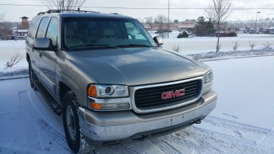

LED (switchback) turn signals, side markers, and DRLs are installed and working, along with brand new turn signal assemblies on both sides!
Action packed video:
The hardest part was cutting off the shroud around the relay with my dremel so the new one would fit.
The EP29N will not fit without removing the shroud around the top of the socket.
If you get 194 LEDs that say they are non-polarity sensitive (got mine from superbrightleds.com), the side marker lights will function like the stock lights (as you can see in my video).
When I swapped out the DRLs, I noticed the sockets were heat damaged. I'm going to have to replace those some time...
