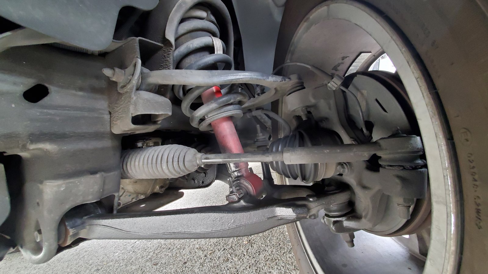

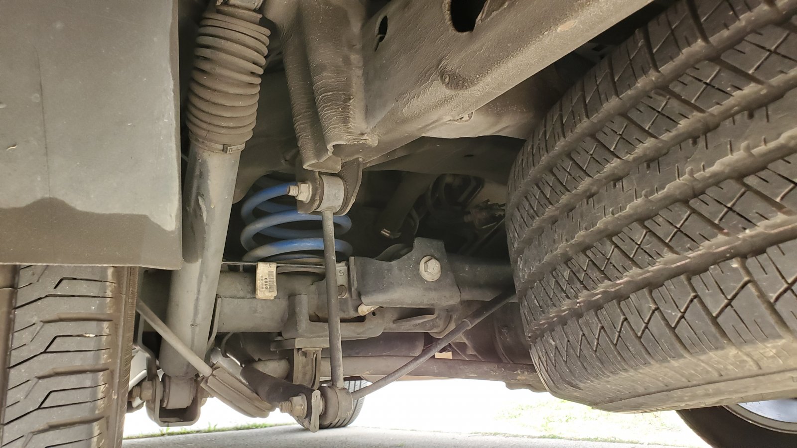

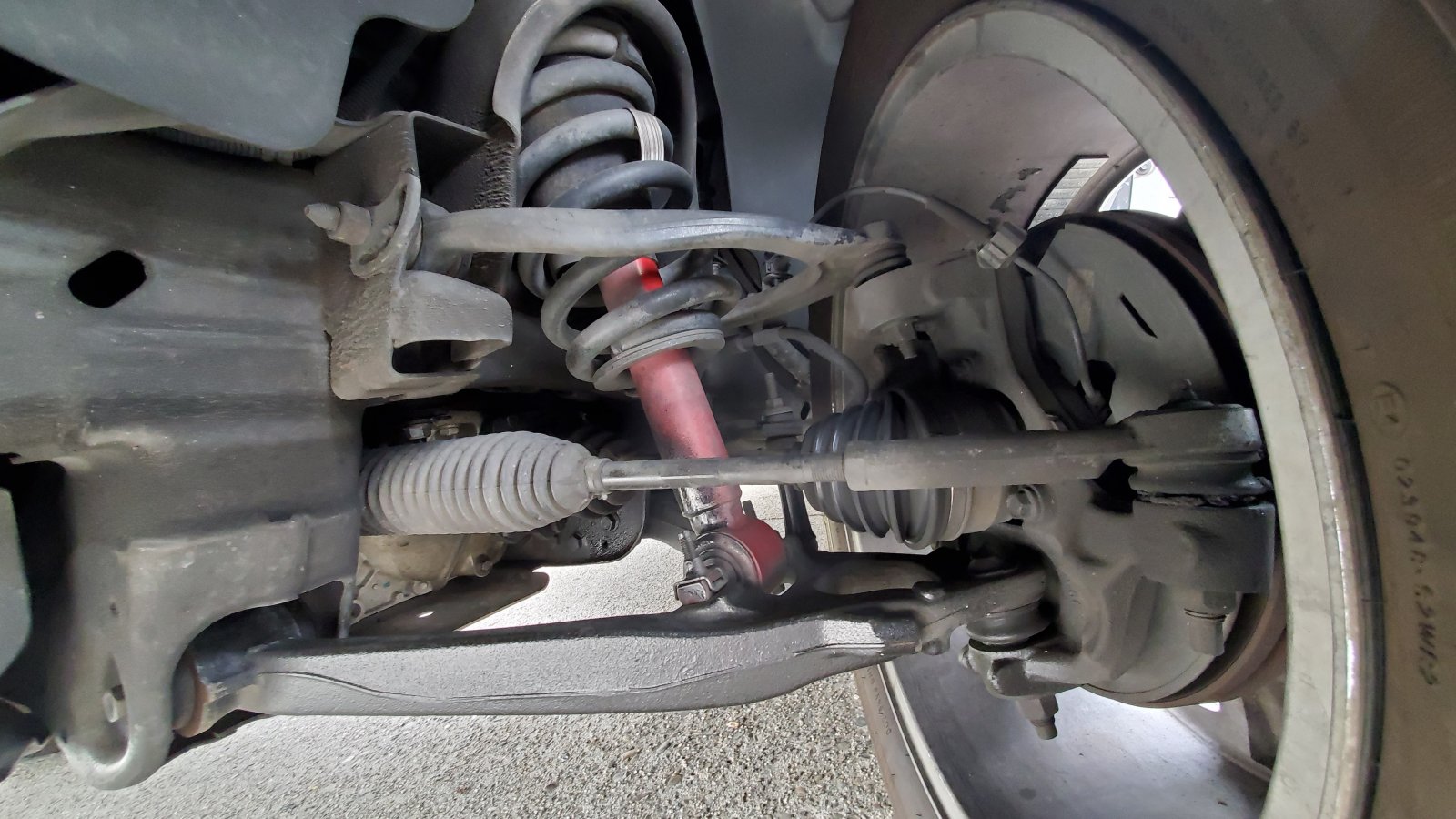

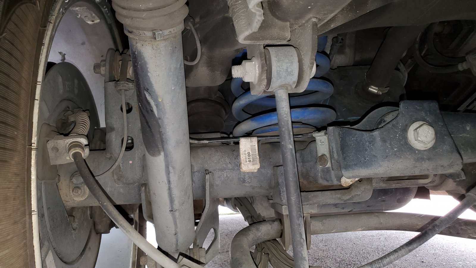

If you can post pictures of the suspension (turn the wheels to full lock and you can get some good pictures of the front without even having to lift the truck), there's a really good possibility we can tell you what all is aftermarket. I've rebuilt almost the entire suspension on both of my trucks, lowered both, and I've been working on these since they came out in 2006 so I know what everything is supposed to look like.

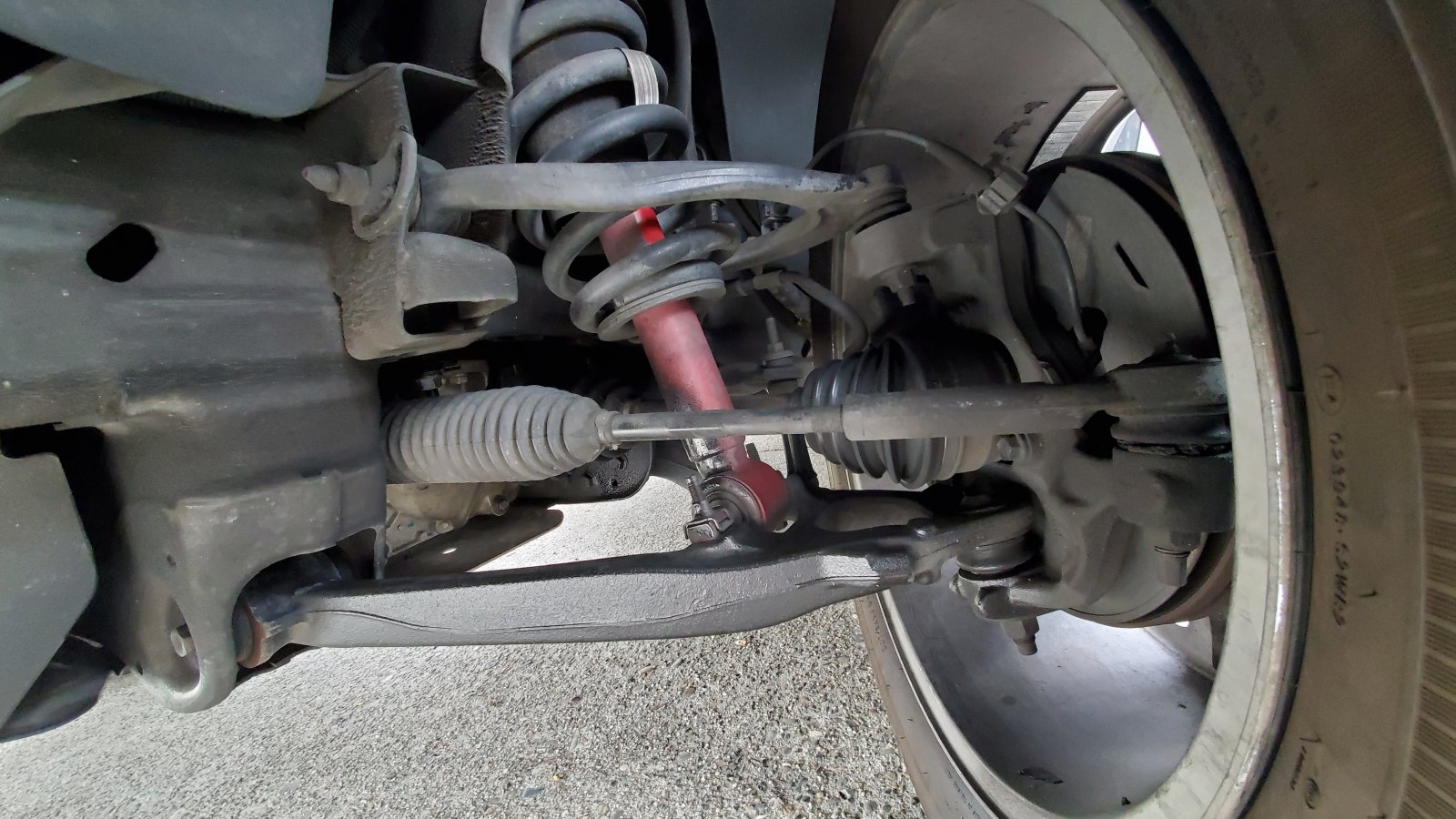

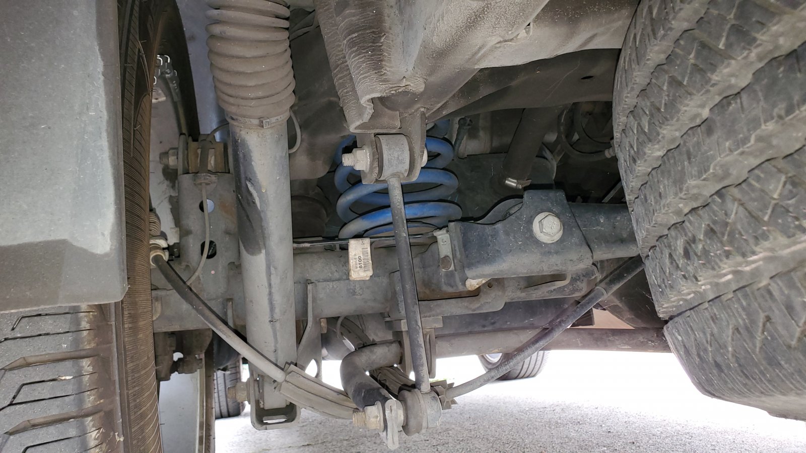

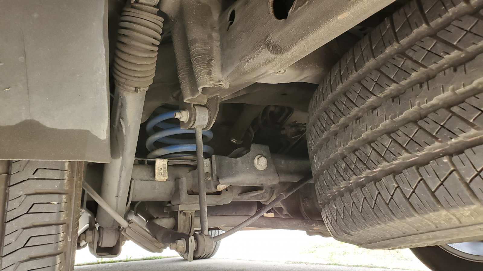

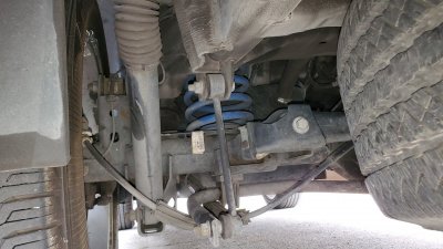

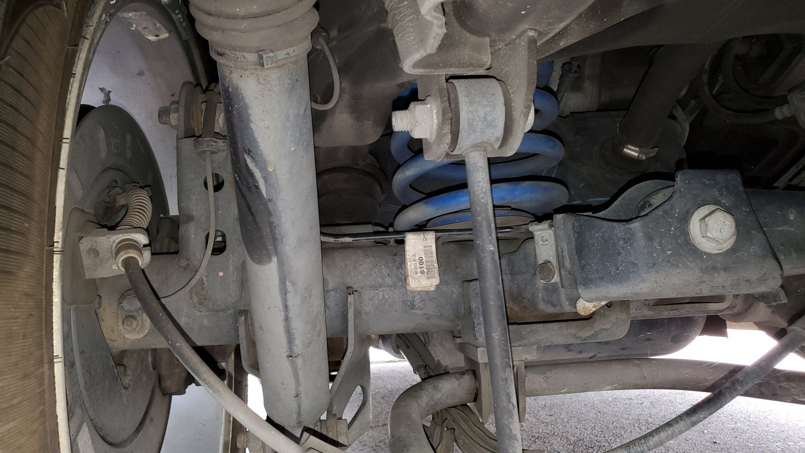

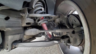

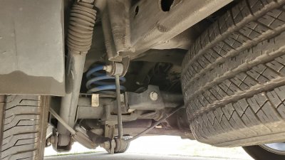

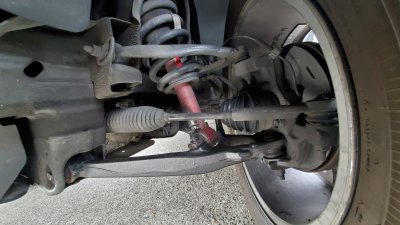

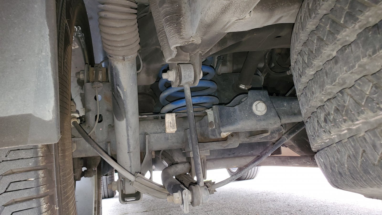

@91RS @kbuskill @1lowhoe04 @swathdiver @massivespl @Keanen55 Gentlemen here are the pictures that I have promised. I wasn't sure what angles you needed but I did my best.
20200323_130702.jpg 20200323_130752.jpg 20200323_130806.jpg 20200323_130622.jpg 20200323_130651.jpg
21,322
30,319
91RS
Nov 15, 2009
2,851
2,299
GA
Definitely all stock in the front. Rear is springs and shocks. Unless you really just don’t like the look, get better shocks (like Belltech Nitro Drop 2) and I’d bet it’ll fix your issue.
