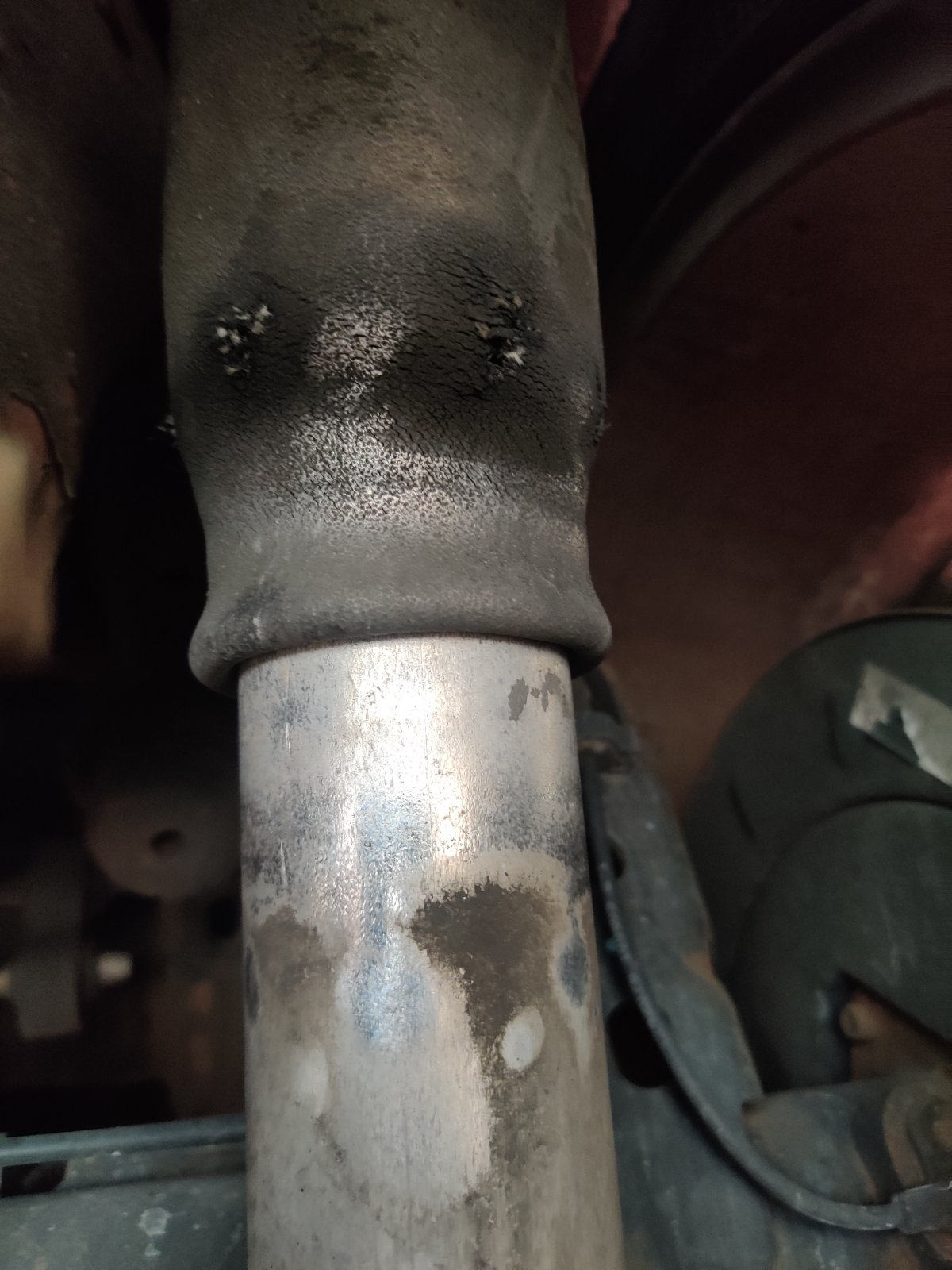

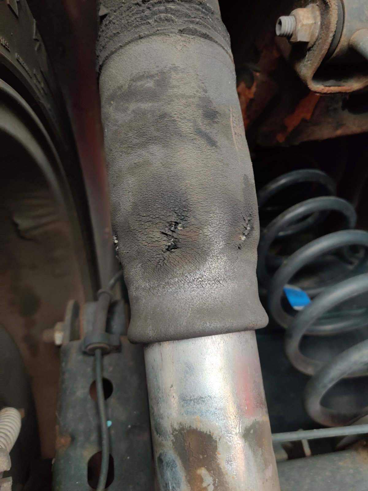

what do you think? it's shot?
30,535
47,970
ya, whatever shop you went to, don't go back......
you can get oem replacements or the arnott replacements for a decent price at rockauto
you might need the airpump as well if it is not working when you turn the key to run.
with those shocks blown out it will ride like shit

the shop actually told me to order them online that it will be cheaper
30,535
47,970
you said in your first post: I had the shop look over the suspension and they said everything was fine
