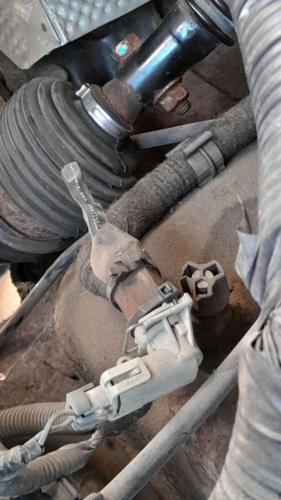

I found that there are heat shrink tubes on front struts connectors, I guess these are the resistors or something... See the pics.
When I turn on the ignition, I hear compressor starts and in a minute or so it stops. I have not checked rear struts if inflated. They are not OEM I guess, there is SACHS sticker on them.

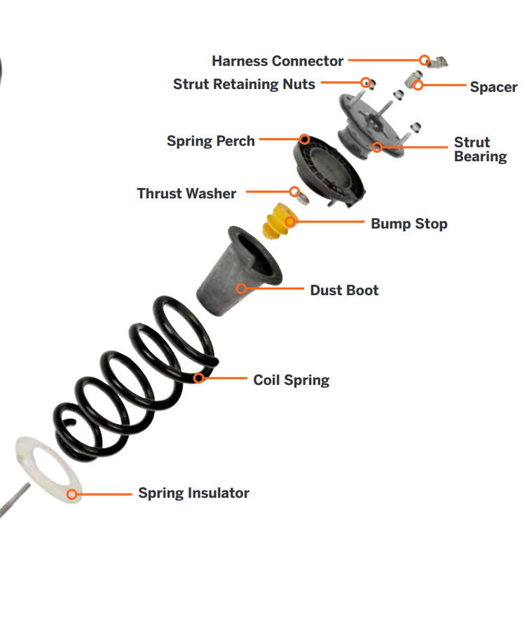

I use this picture from petethepug post as reference:
Everything OEM matching RPO codes is available from Rockauto except coil springs, trust washer and spacer.

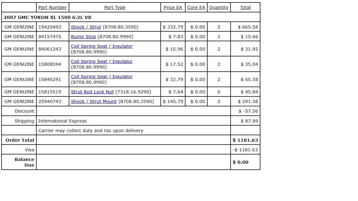

For reference, at the time of this post, Sep 2025, other parts cost $1183.00 shipped to Bulgaria:

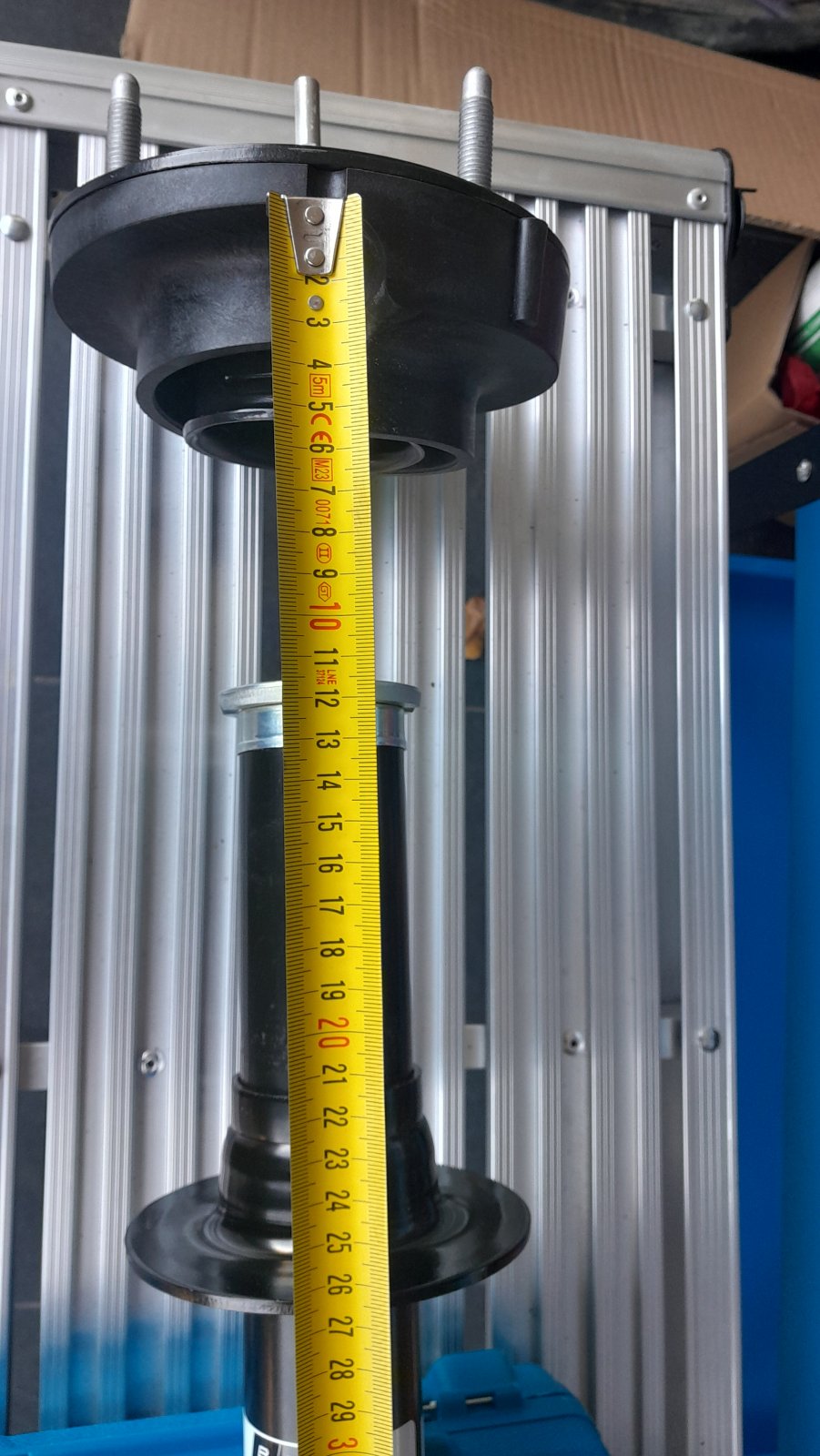

What I see from the firs look is that springs are much taller then the shocks they must be mounted on.
Uncompressed springs are about 37,5 cm (~15,3 inches) and I guess, they must fit in 27 cm (~10,8 inches) space when assembled.
Does it look right or shocks must be expanded somehow?
Can I use DIY spring compressors or I have to look for some professional equipment/shop?

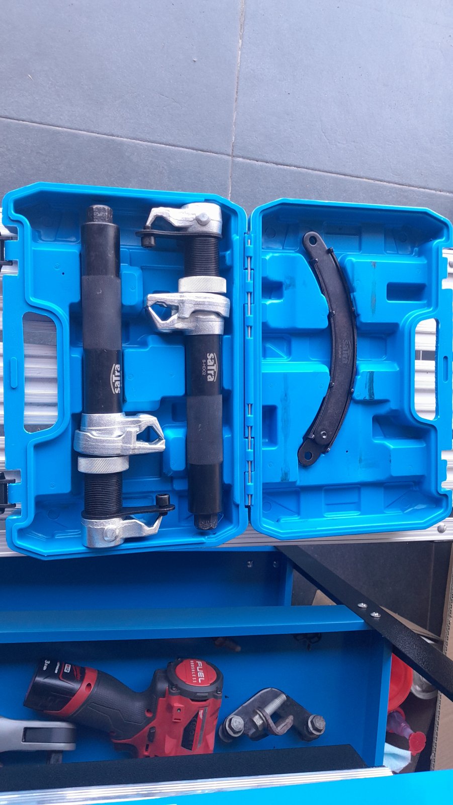

I have this spring compressor:
Thanks a lot for your help!
Ivo
Yes, the springs have to be compressed, in order to complete the assembly of the strut assembly.
The spring compressor equipment that you have looks like it could do the job for you, but you need to be VERY careful, and do the work EXACTLY like the instructions say. The forces that you will be applying to compress those springs will be LARGE, and if you make a mistake, and the spring compressor fails, you have a very dangerous situation, which could result is serious injury to you.

It was my point, I know springs are dangerous. I find useful video and the guy there uses four spring compressors.
I might buy another pair just to be on the safe side.

I have a set of spring compressors like shown above.
I really like them. For a DIY person they are fantastic and are WAY safer then the cheap rod style.

I bought another pair of spring compressors like above and I can confirm, it could be done with four compressors.
