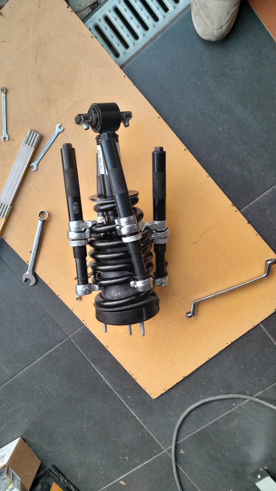

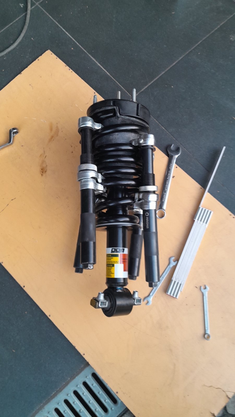

Hi guys,
Thanks for the help. I managed to assemble one of the shocks. It was not that hard.
Is there torque specification for the center nut on the shock?
I tighten it till it stopped but did not put much force since I need to keep strut stem from rotating by 9mm wrench.
Here are some pics:
Thanks for your help!
Ivo

Hi guys,
Here are some pics:
Ivo
Glad to see that you got the strut broken down and re-assembled.
Just curious...... What did it cost you for the second set of spring compressors, and how much time did you spend with only the strut breakdown and strut re-assembly portion of the project?
I'm asking to see if it is worth it in the future for me to go your route (strut breakdown and strut re-assembly) doing the work on your own, versus having a local shop perform only the strut breakdown and strut re-assembly portion of the project. It cost me $50 to have my local shop perform the strut breakdown and strut re-assembly portion of the project.

It takes me about 1/2 hour to R&R the strut from the spring. A guy can do both sides from jacking it up to letting it down in under 2 hours.
4 compressors are overkill. 2 work just fine using that tool but 4 are added safety for sure.
If you are only planing on doing it once i would just pay the $100 and have them do both. The tool is right around $50
That tool has saved me money for sure. I have swapped struts at least 5 times in the last 8 or so months.

Thanks mikez71, useful info.
@ Joseph Garcia
It took me about 45 to 60 minutes to assemble it from new components. It could be done for less but I am doing it for the first time and did many measurements and trials. Spring compressors are about $45 here.
To get old shocks from the car took me about an hour per side.
It is also my hobby, so I am not counting on time and money here. May be I will never use this spring compressors again :)
