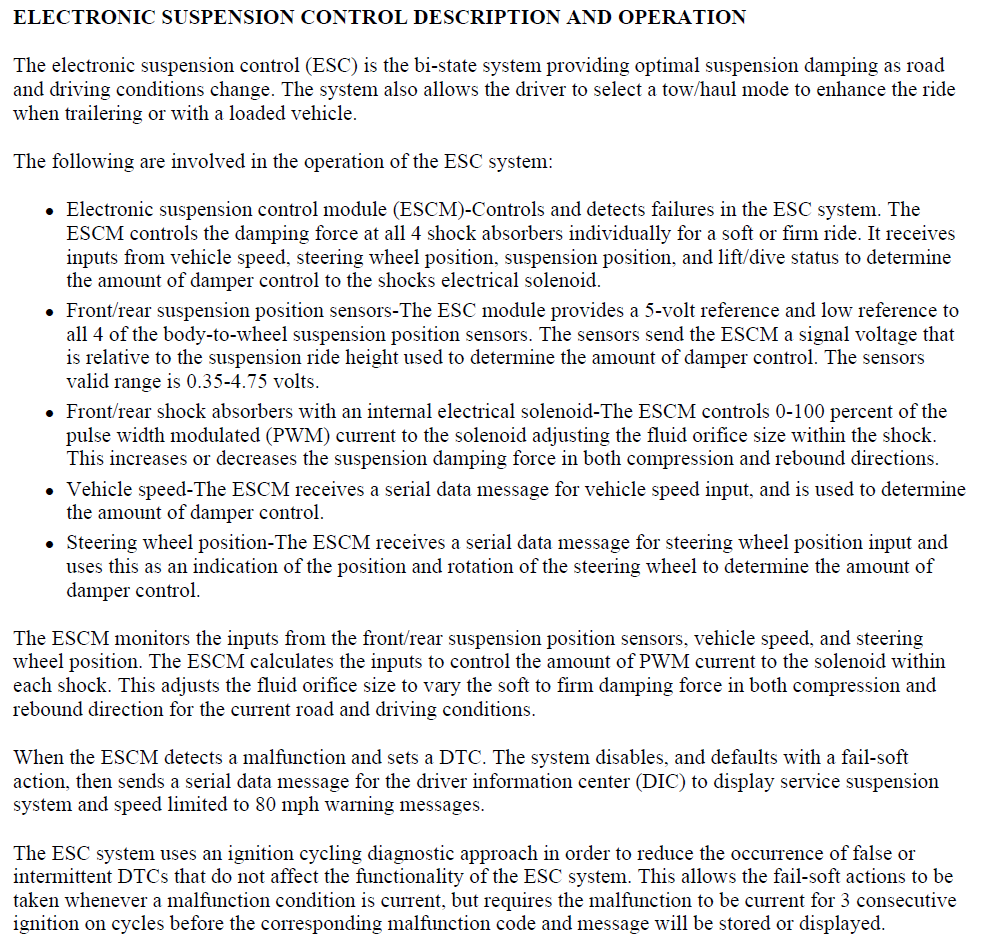

07-14 z55 Tahoe are equipped with GM “auto ride” suspension. 07 & 08 Escalade also have it. In 09 GM went to “Mag Ride” til 2014 only on Escalade.
There’s 3 components to the 07 z55. The factory z55 struts, the communication lines that plug in and the rears have compressed air lines to level the rear suspension. The suspension control module is located under the spare tire.
The z55 suspension is often compromised by copy cat struts without GM part #’s that have connections for the electronics that are disconnected inside.
Research threads about individuals who are installing aftermarket z55 or z95 struts to understand the rabbit hole they go down that leads to an expensive bounce house suspension that never works.
That may be what you’ve walked into, but it can be reversed and made good to last for 50-75k km when restored to factory spec z55.

just to add a little bit of info, the dealer is correct there is no one that can clear the suspension code., because it is self clearing once it is fixed and working or "tricked" into thinking everything is ok. then the code just goes away on it's own.
I would guess that what has occurred is someone replaced the shocks at some point with conventional ones instead of electronic ones in the past and did not use resistors, resistors would be a easy fix in that case.
