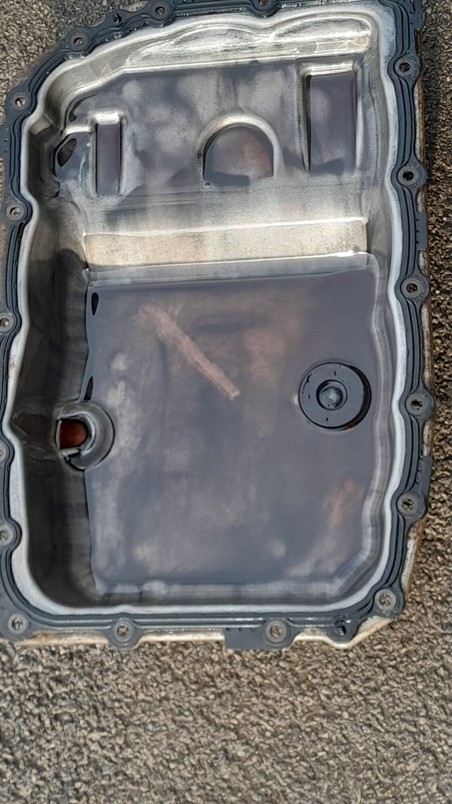

At least, I will have refreshed car except transmission at this time. The oil pan was relatively clean, no metal shavings at all. Fluid was dark.
In Carfax, there were two records:
at 83K miles -Internal transmission repaired
at 101K miles -Transmission serviced
And I guess, torque converter is changed because there was hand writing on it that does not look like factory.

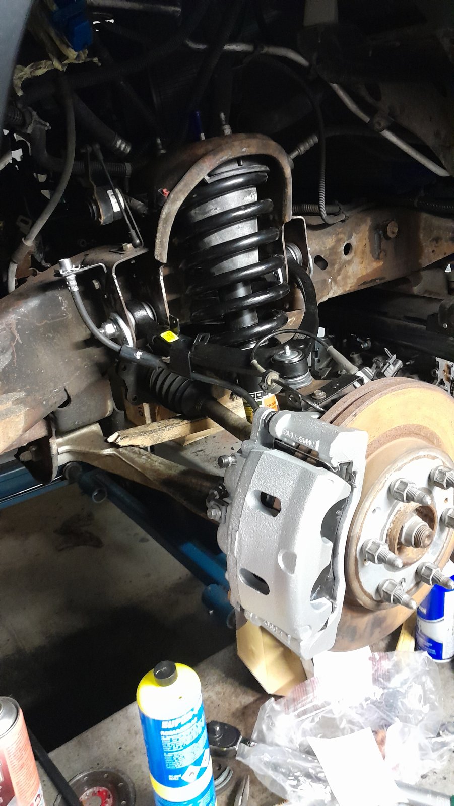

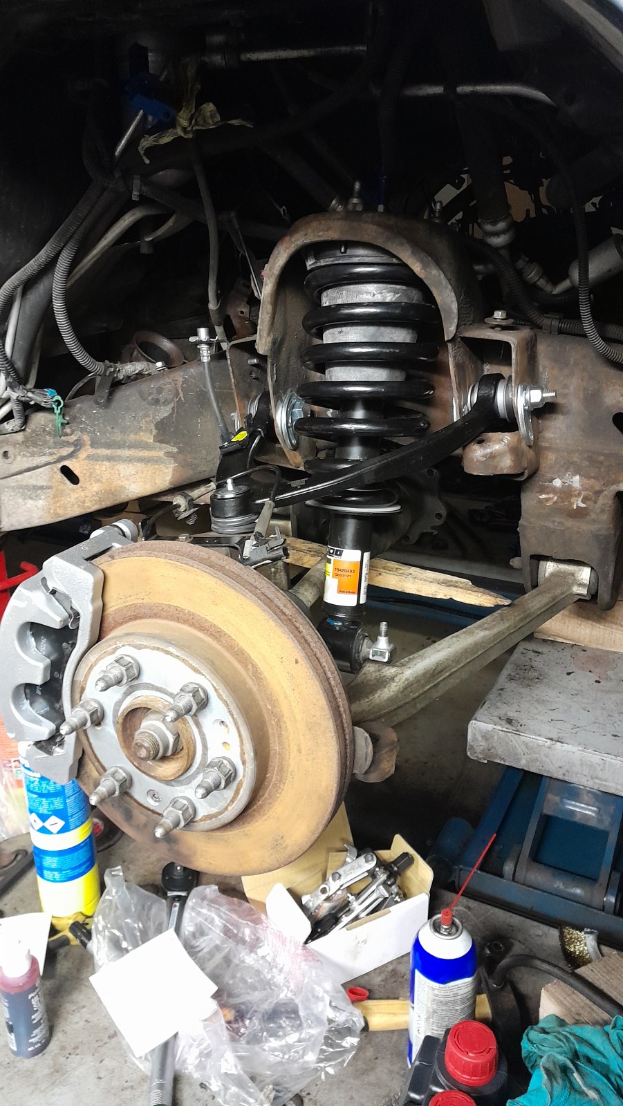

Hi all,
Front end is almost done. See picture of the passenger side :)

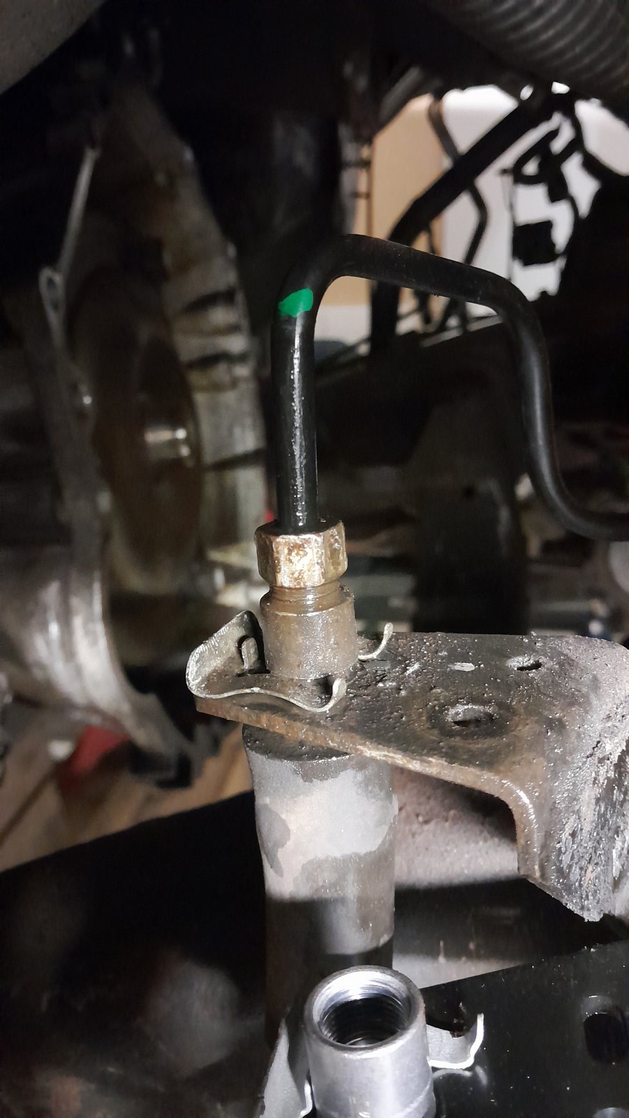

I have trouble with brake lines. I was able to loosen hoses but flare nut is "welded" to brake line. I think it is covered with some type of plastic paint or so. If I apply some force the line starts to bent but the flare nut does not move.
Is there some safe way to free up these nuts?
Thanks for your help!
Ivo
Heat. Dont need to get the nut red hot but get it hot. It should loosen the line up from the nut.
Thanks, this did the trick.

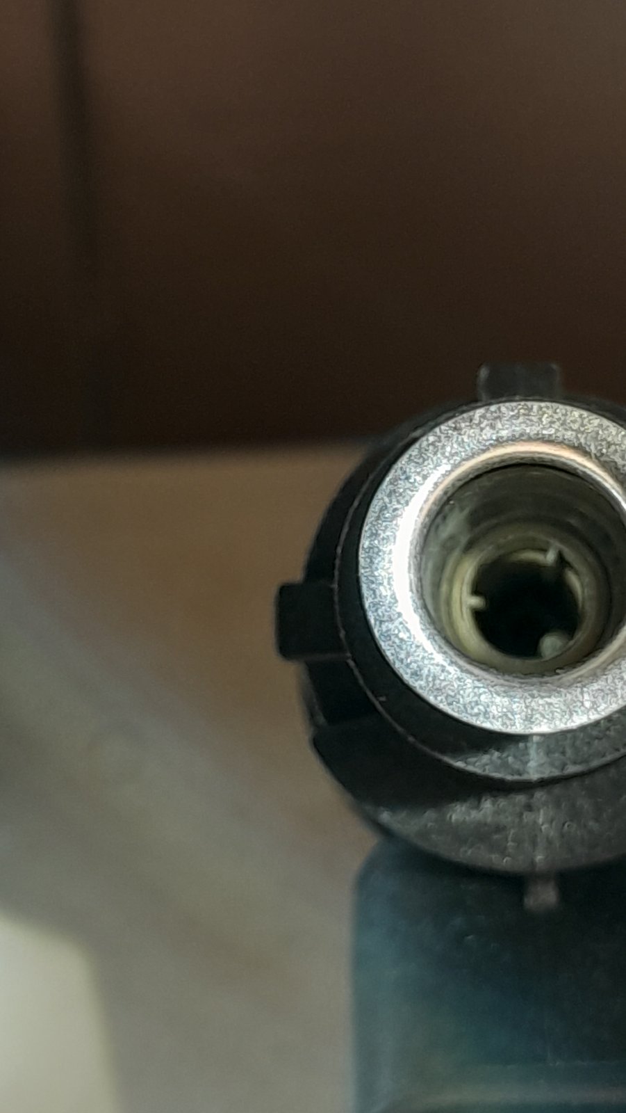

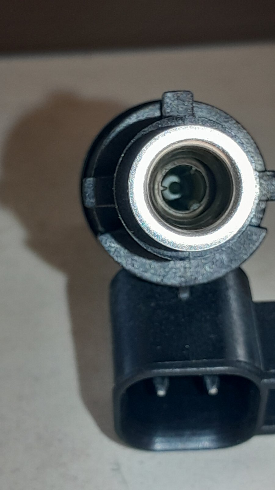

I also cleaned the fuel injectors. I am waiting for micro filters to arrive. On youtube, I watched videos that filter is placed flat with the injector.
What I see on mine i that filters are installed deep in the injector:
What is the correct way to install them?
What I see on mine i that filters are installed deep in the injector:View attachment 480919

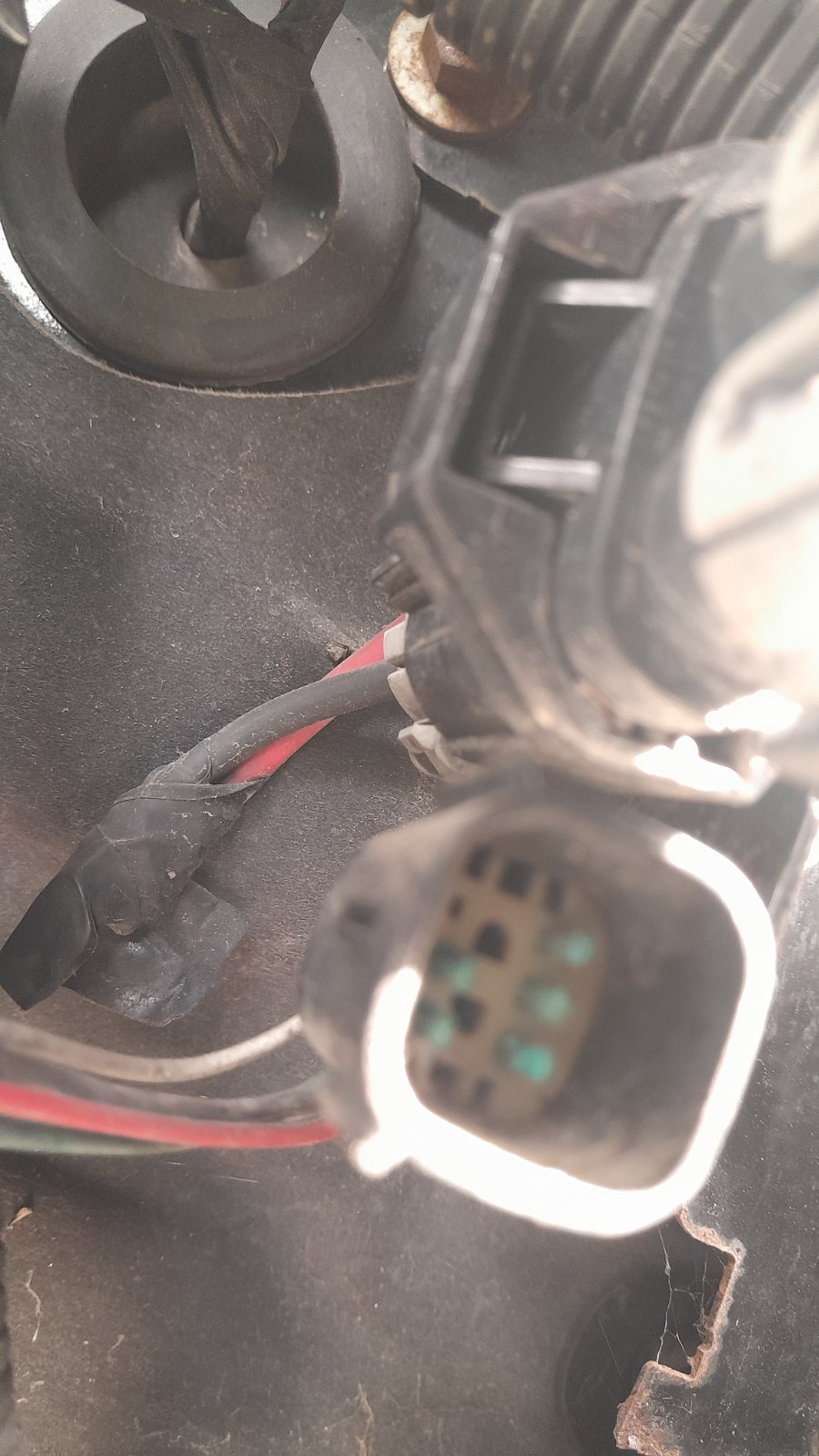

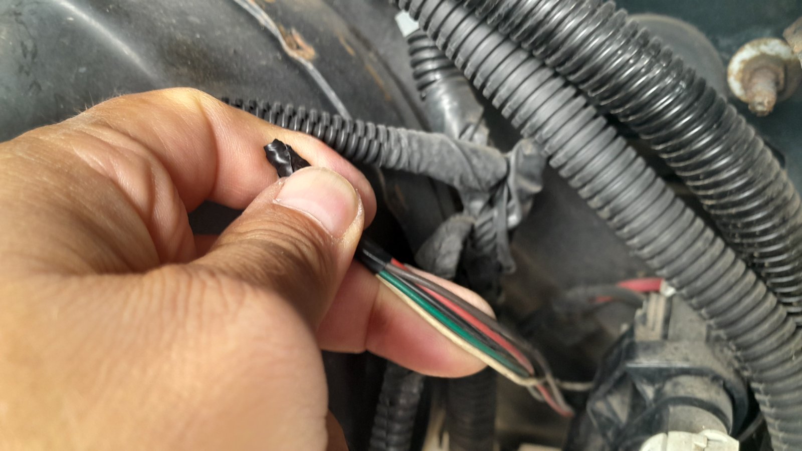

Hi guys,

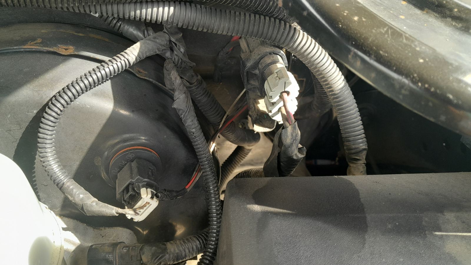

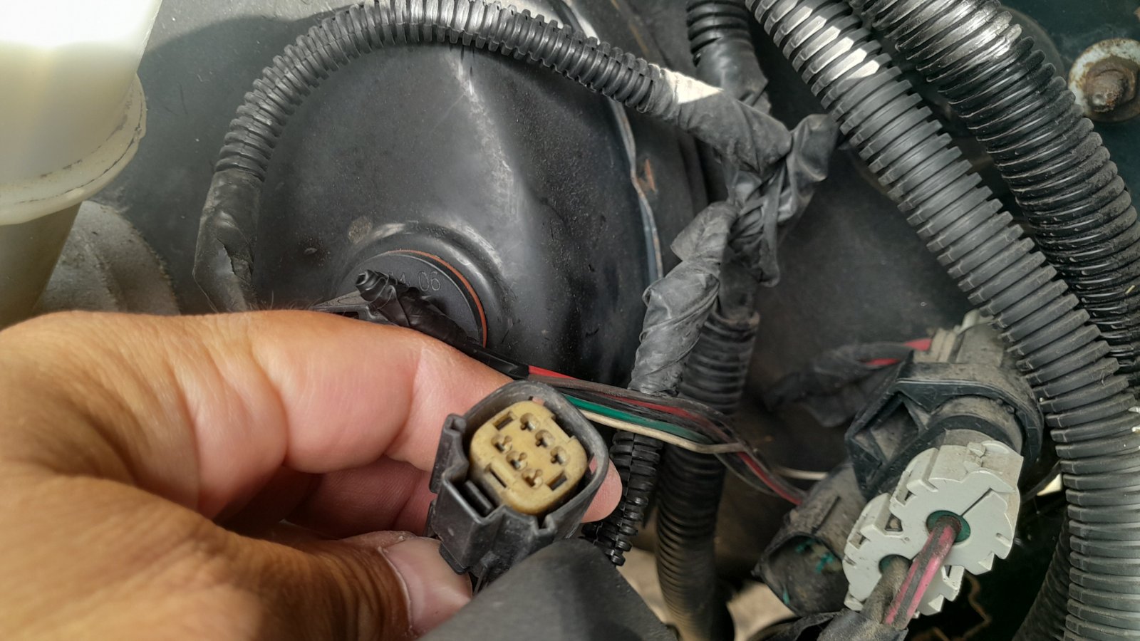

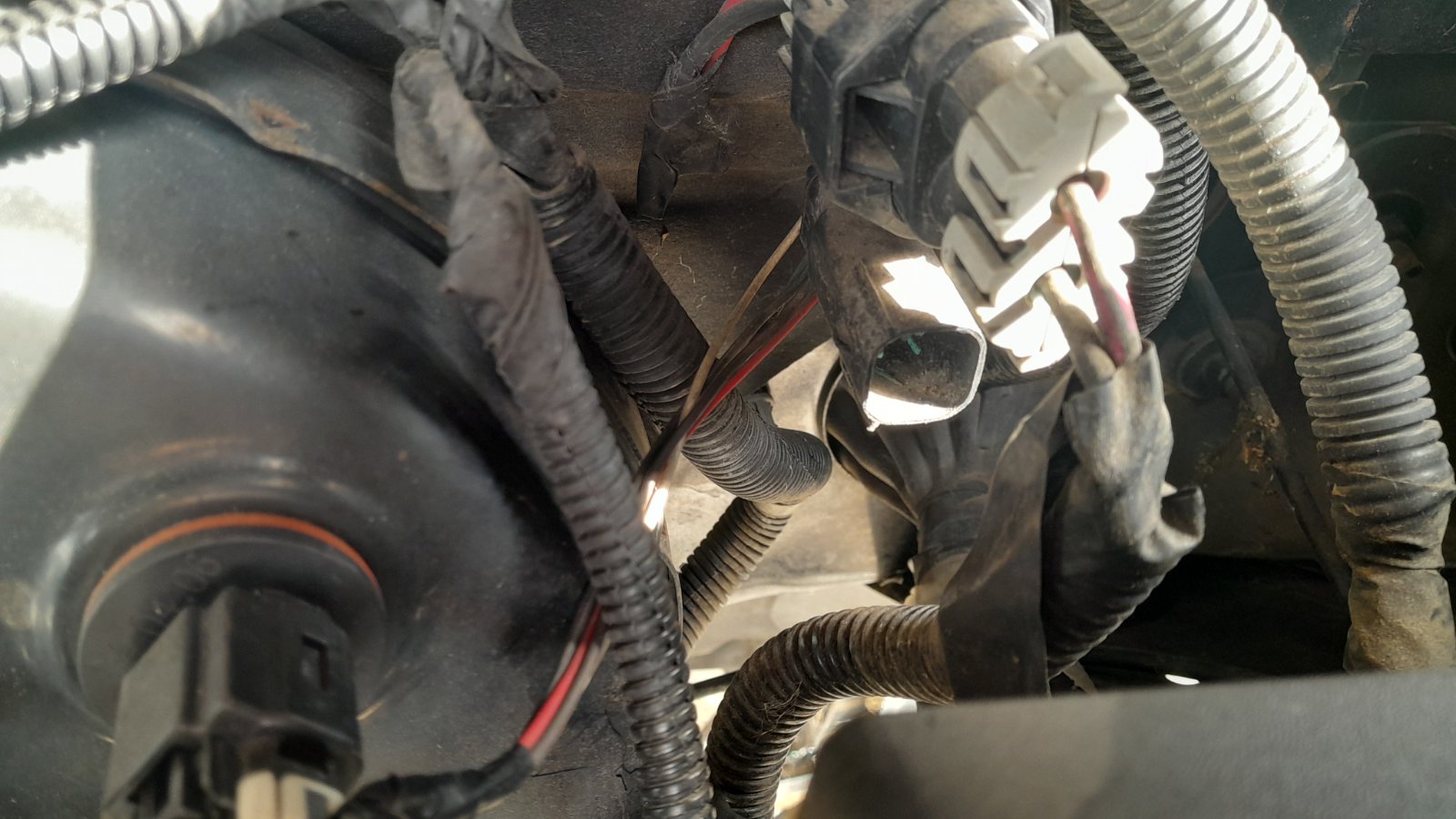

I am changing wire loom tubing and tape as originals fall apart.
I discovered some cut wires. Two of them are thick the others are usual size with hanging connectors. Location is on the right side of brake booster (looking from the front).
See the pictures.
Can anyone tell what they are for? There is aftermarket radio installed. Could it be that?
Thanks for your help,
Ivo
10,551
15,320

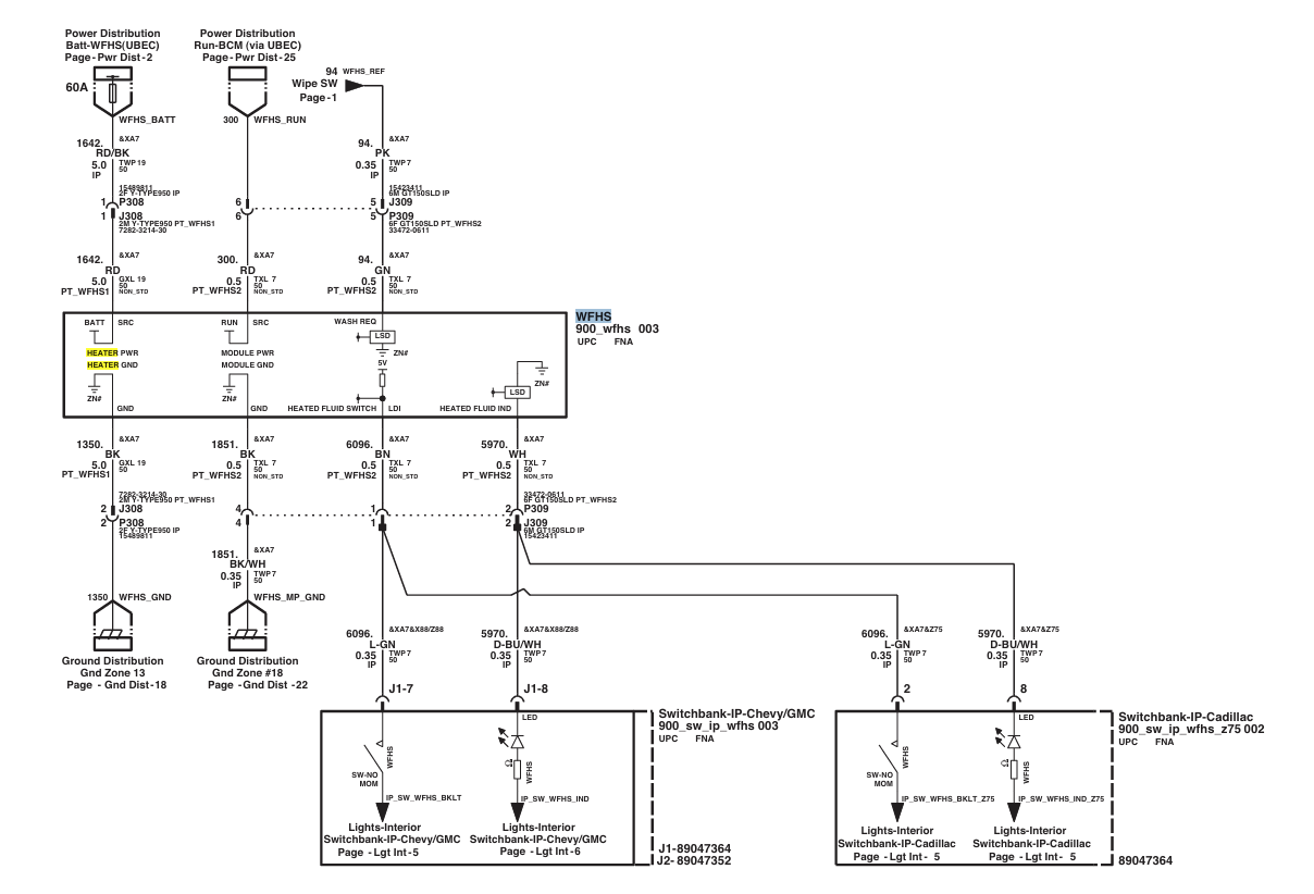

If it is for the heated windshield washer module, as @mikez71 suggested, that module became a safety/fire hazard and was eliminated by GM.
