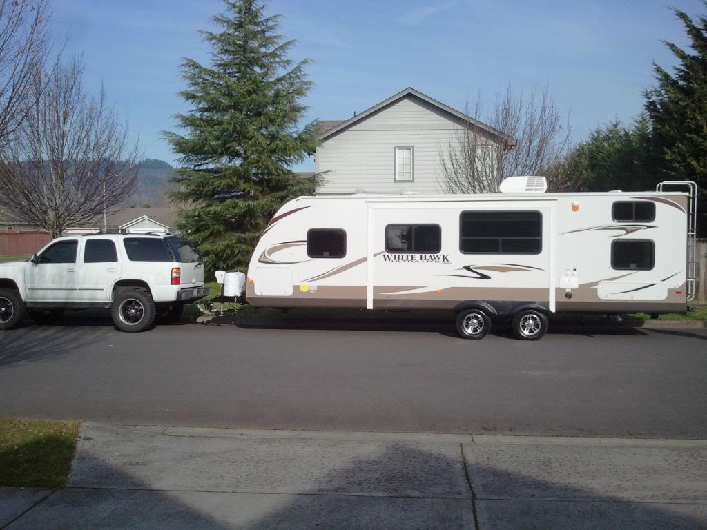

The StormTrooper and my new RV...With my AFE intake and 3" FlowMaster exhaust she tows pretty well!
Trooper your bars should be more parallel. We just had a guy come in snap a bar because they were not level. Raise your head unit up a little to level those out to relieve the strain on the head itself.

This was the way that camping world installed the hitch. I dont have any other clue what im doing. this is my frist RV... Im getting helper air bag just to help with the hole towing ride. So my hitch ball needs to come up? wouldnt this still mean i have to take an up an extra link on the chains?

No your bars need to be level and we have found that camping world installs leave a lot to be desired. Quick tip, level camper and set the top of your ball1" higher than hookup and have bars level to the bottom of the a-frame. Too much lift on those bars the hitch doesn't work together.

Also set them up in a flat parking lot. So you can get camper and to rife perfectly level. Takes little time for setup. But once setup. You never have to do it again. Hitch and roll. And also setup loaded. As the added weight will make a diff on the bars.

also i see my hitch has an angle ajustment so this could be used to set the angle of those spring bars? so if i need more load i can move the hitch so that under load my bars are always parallel? It realy pisses me off that i cant trust people to do good work...If you want it done right you have to become an expert yourself and then do the work youself! no matter how much you spend you can never trust your getting quality work!...thank for some real advice guys!

Yes there is tip. You want a slight tip towards the trailer when not hooked up. So when you put your bars on your ball shifts to level with the weight being equalized. Every shop is different and I know camping world does not push for certification and training. I am certified by the RVIA and we do training yearly so we are up to ***** on new regs. Biggest change is on weight ratings on FW hitches. Everyone needs to limit their liability. Search equalizer brand weight distribution it is called E2. Look for install instructions as they are very good and straight forward and easy to understand.
