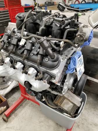

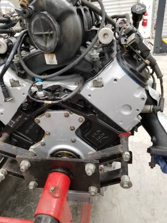

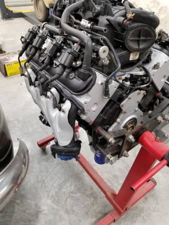

I saved pics of a 5.3 I saw for sale because I liked the color scheme:
It's the stock color scheme except for the painted rocker covers and exhaust manifolds. The clean aluminum of the heads and front and rear covers contrast nicely. I'm really leaning towards copying this for the simplicity.

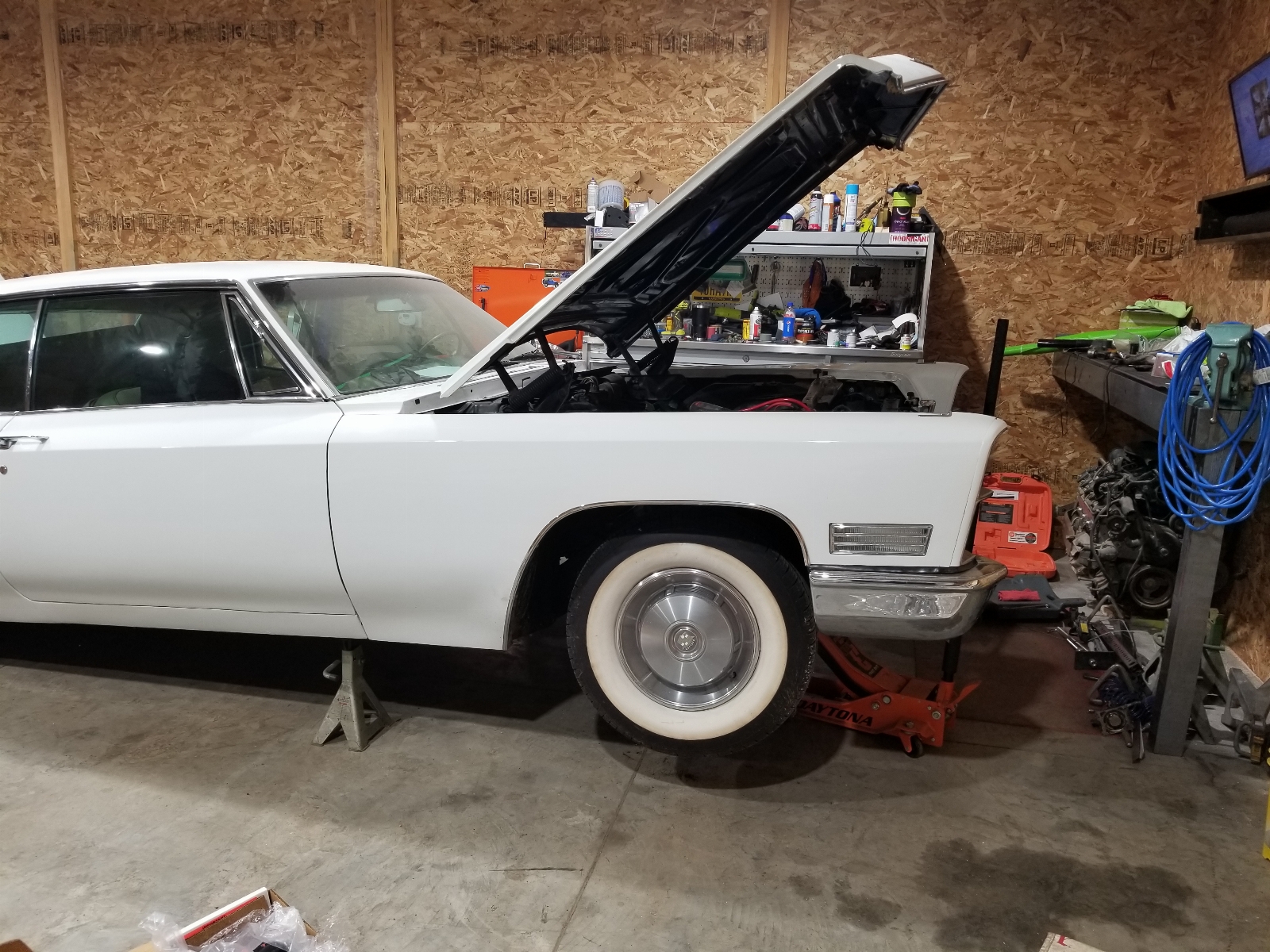

Finally spent a little bit of time on this. Was going to get a bit more done but due to it taking a few hours laying on the ground fighting getting the pitman arm off I only got the steering box and idler arm changed out. It was something I needed to get done though. Have next Monday and Tuesday off to work on the car so going to have the motor in and interior out but that may be a pretty lofty goal.
I did find the ECU so now I need to get that sent off to get unlocked so that I can start the car when the time comes and move it on the trailer. Baby steps...
I also found the sway bar bushings look like poo so ordered some new ones and need to order a new steering wheel but can't decide on the size. Not impressed with the condition of the control arm bushings but it is a snow ball of parts needed when I tackle this so maybe next winter.

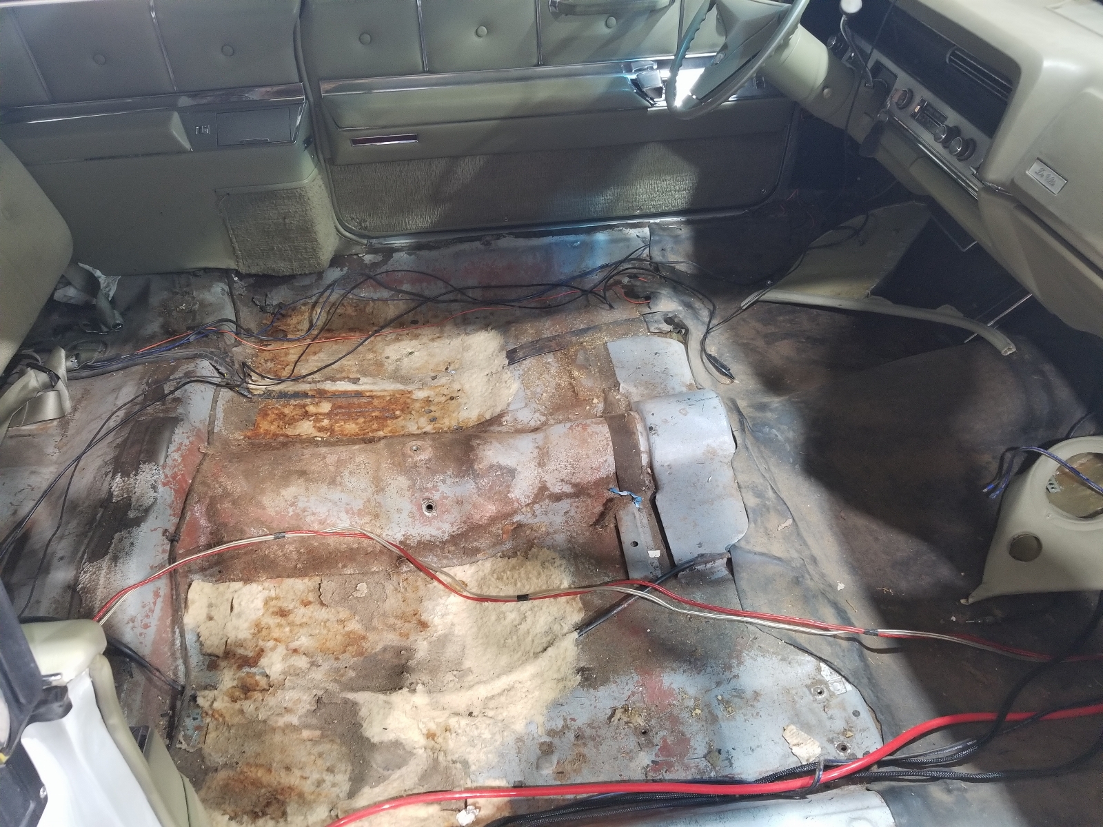

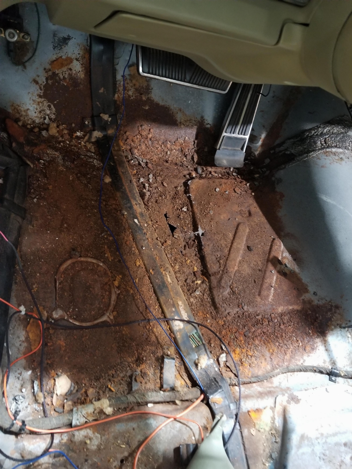

I guess I am sharing the good, the bad, and the ugly with you guys. We noticed a little rust from underneath on the driver side so purchased a new floor pan already, passenger side looked brand new. Going to seal everything up and then put in Dynamat and Dynapad in that I have left over from the white Chevy that Dynamat sponsored back in 2013.

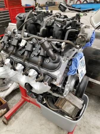

Dropped a bare block block in to check fitment and the motor mounts I have, from when this motor was supposed to go on an S10 frame for a 48 pickup, won't work. Trying to decide if I should cough up the $150 for Dirty Dingo mounts or cut these up and remake some. GTO oil pan looks like it should work with minimal reshaping on the frame. From a quick look we may not have to modify the firewall or trans time tunnel but need to gut one of my 4l60e teams to know for sure.
Progress today, will hopefully get it vacuumed out and the old sound deadening scraped it more. Wires will be cleaned up once Dynamat is down.

Love the high beam switch on the floor!
Whomever built the speaker kick panels covered it over and then is seized up when I got it uncovered. I bought a new one and need to decide whether I want to change the speakers to the doors or move the high beam switch over. I really want to move them to the door but I am having trouble finding reasonably priced replacement kick panels. Either way I want the high beams to work. The car has factory automatic high beams so want to see if it works, lol.
