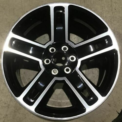

I really like these wheels (22" +22 offset) from 2015 silverado.
but for some reason when I look on eBay fitment, it says it doesn't fit. I looked into bolt pattern and it seems like the same. Could someone explain me what is the difference?
They’ll fit. Any sizing chart will tell you no because 22s was not a factory size on the 2007. So in their eyes they technically are not compatible with a 2007. But bottom line is they fit

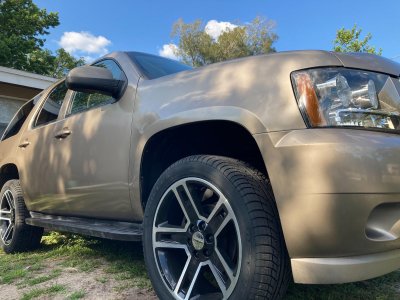

Thanks Tony! Purchased, now just time to wait.
Most of the wheels made for your generation had offsets between 24 and 31 millimeters with the vast majority being the latter. As long as you're ok with them sticking out a little, drive on!

Nice choice. Easy to clean and looks OEM+
