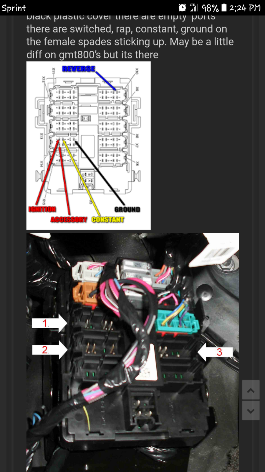

RAP power is accessible in only one place that I know of - at the LEFT IP Junction block. This is the junction block on the firewall between the foot brake and the e-brake pedal.
If you remove the cover, you'll see two columns of ports, some that have plugs plugged into them, as well as a few that do not have anything plugged in (depending on your trim and options).
The 2nd port up from the bottom left should be open (it has 8 metal pins you can slide connectors onto) and is the port that has IGN, 12V CONSTANT, RAP ACCY & GROUND in it.
The pins are numbered from RIGHT to LEFT:
Top row starting at top right: pins 1,3,5,7.
Bottom row starting at bottom right: pins 2,4,6,8
GROUND is pin 1 (top right)
IGNITION 12V is pin 7 (top left)
CONSTANT 12V is pin 5 (2nd from top left)
RAP ACCY 12V is pin 8 (bottom left). It should act the same way the RAP circuit works on the factory radio.

great, do you know if that is the rap for just the drivers door or for all doors

i'm waiting for them to re-write the firmware again as of this morning, so if they cant make it work then I will have to patch in there, mine are all occupied (Denali) so I would have to patch into one of the connectors from behind
