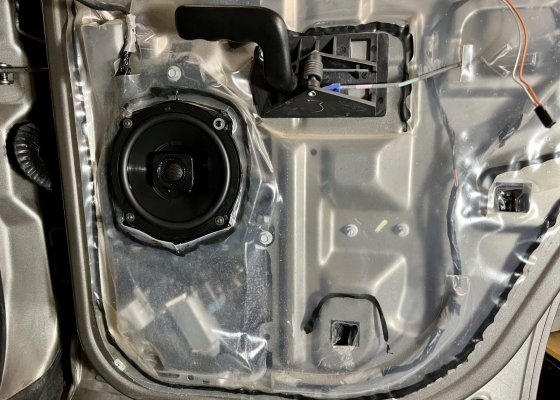

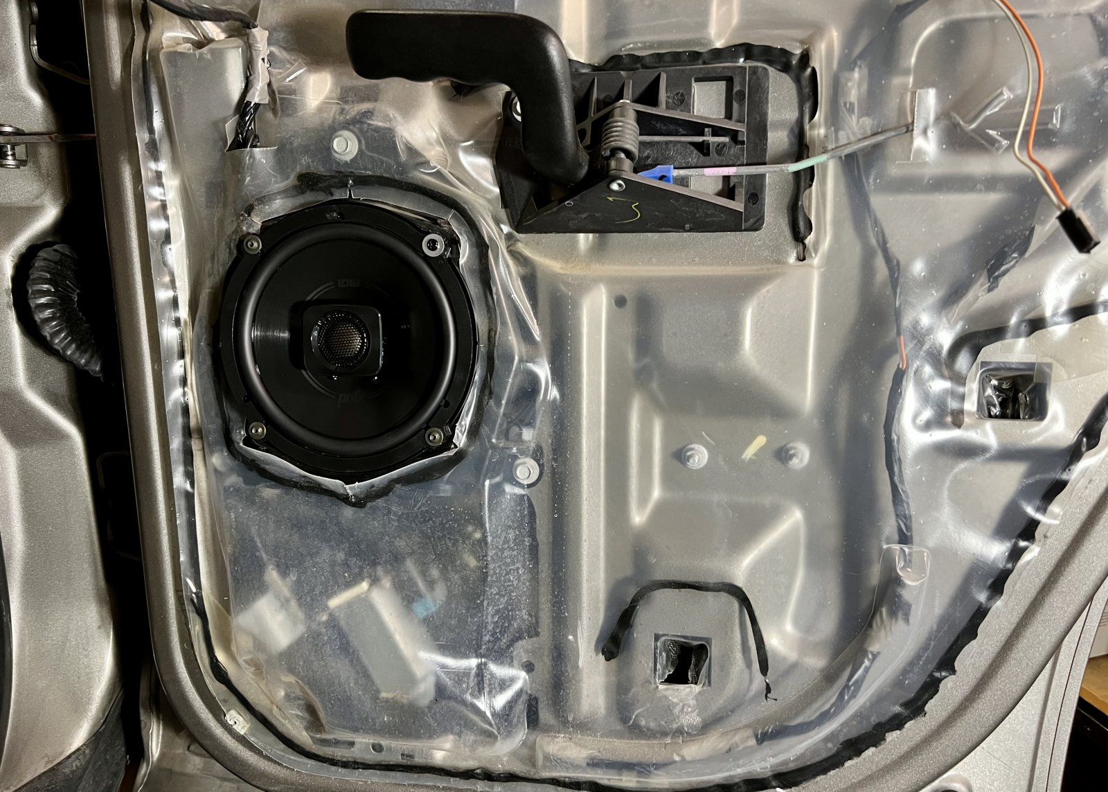

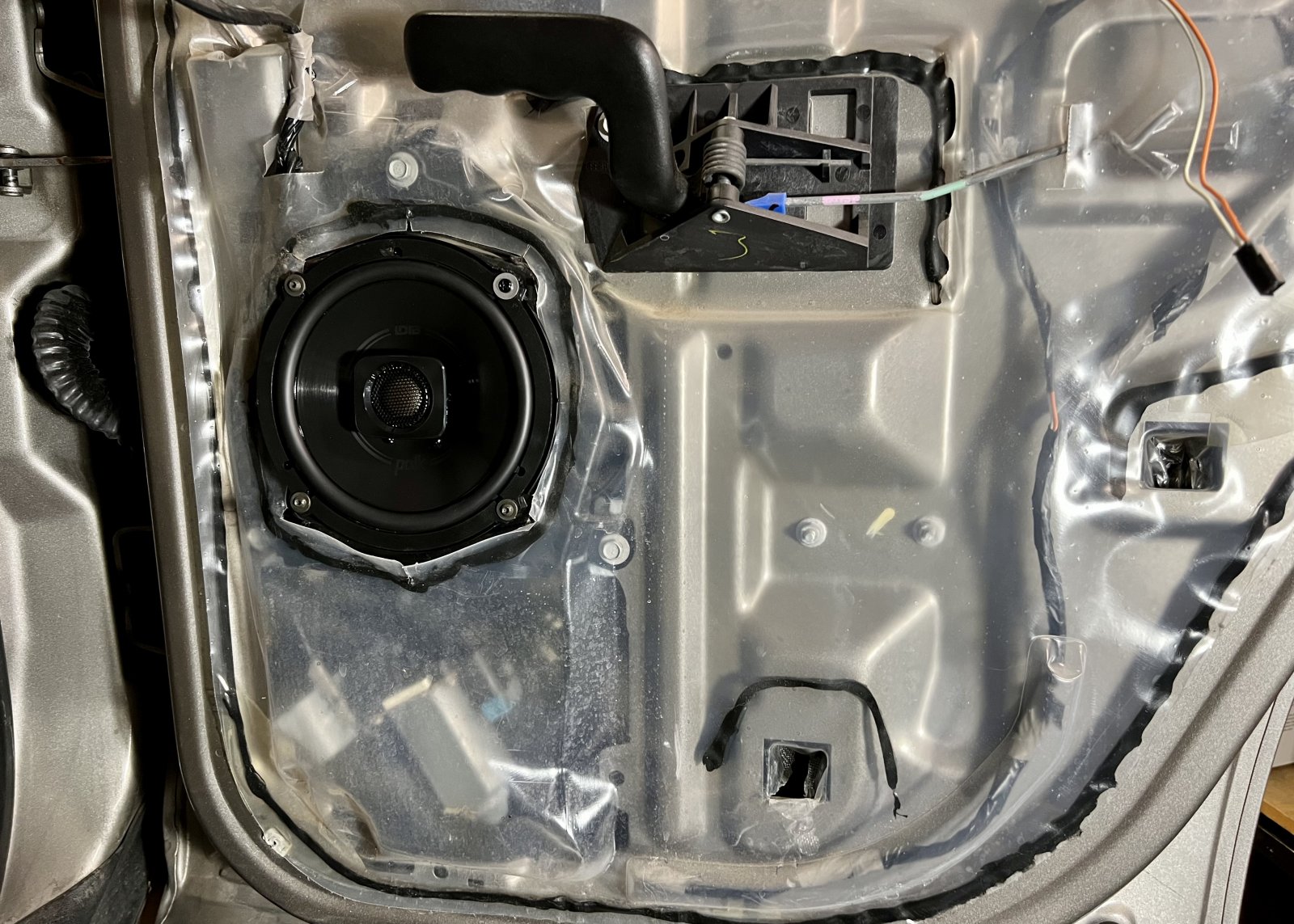

I’ve had to replace the window regulator in the Drivers side front and rear doors on my 2001 Yukon. It’s a pretty common problem and relatively simple fix.
Watch the YouTube videos on removing the trim panel inside the doors. You will need a 7mm socket to take out two screws on each door (….I’m pretty sure it’s two, but different locations front and back).

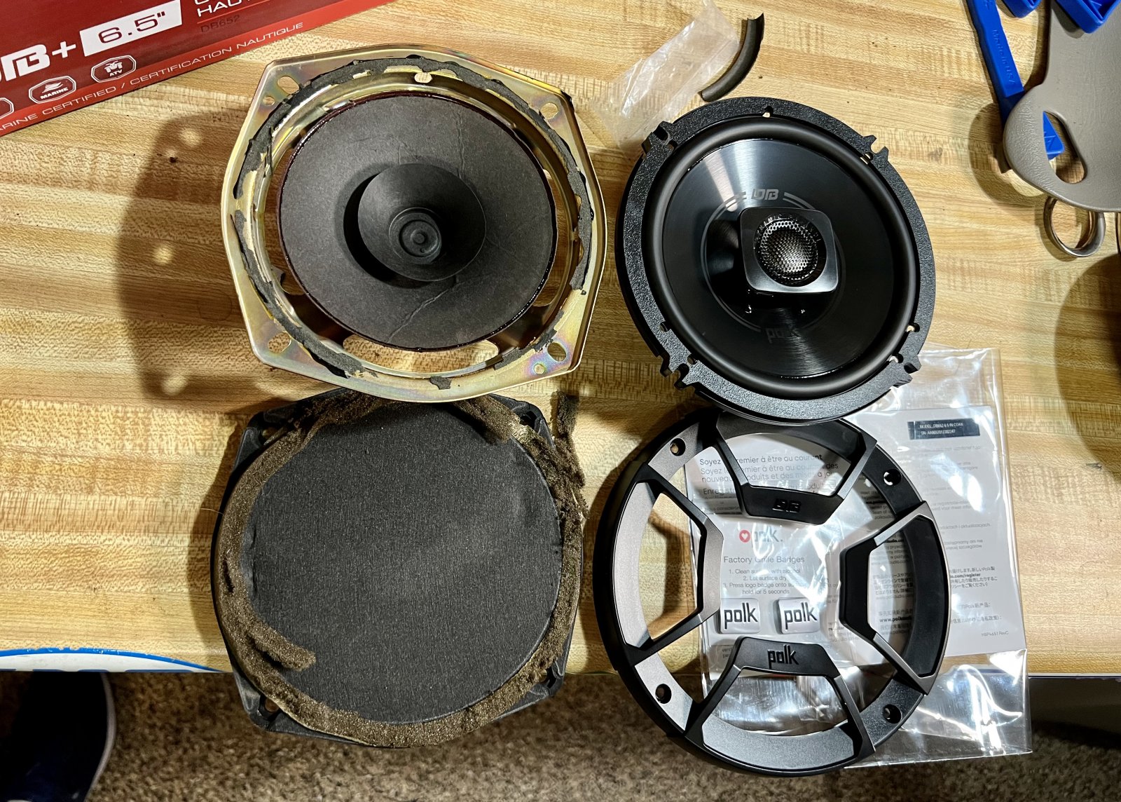

While you have the door trim panels off you probably will want to replace the speaker cone. I’m not positive about the speaker in the Bose system but my front and rear door speakers were mostly disintegrated. The audio system in my Yukon was hugely refreshed with new Polk speakers.
