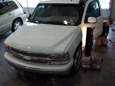

Today was one of the days I didn't have to do any work myself! Got a lot done though:
-Wincos 20% all around window tint (higher end tint w/ 95% infrared heat rejection to protect the interior from heating up too much-black is hot!)
-HD hood painted/installed
And here is a pic of the truck in the PDR shop...this guy has been doing this for over 10 years, one of the best I've ever come across..I took her to him to take out a "few" dents today

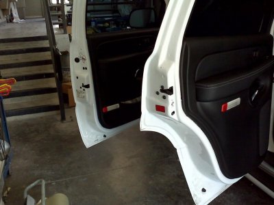

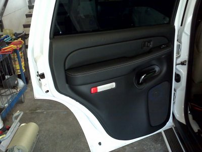

So the doors are finally on, seats go on in the morning...headliner/plastic goes in tomorrow night..I will finish this before Saturday - I hope LOL!
I had so many dents to get out, the PDR guy wanted me to come back the next day so this morning I went back at 8am. He would finish a door and I would hang a panel...it workd out great
The eneven spots you can see unfortunately were already there from the previous owner on the rear pass door. Prolly kids...
I think they came out DOPE as hell

Yeah I busted a nut lookin at the door panels haha. If you ever go to the dealer they will be wondering wtf when they see that interior!

never get sick of HD hoods, looks tight on a white truck too.
ME neither, makes the truck look much more proportioned. Stock tahoes look like a body builder with huge arms and little chest....

I get all kinds of reactions now from car enthusiasts...I catch them looking back and forth at the doors when I go through a drive through or something...I ease the tension and say "Ya they're definitely not stock :)" They can't contain themselves and blurt out "I was wondering!" or "Damn that's wicked!"
Makes it all worth while that someone else can appreciate the work as much as the idiot doing it LOL!!
