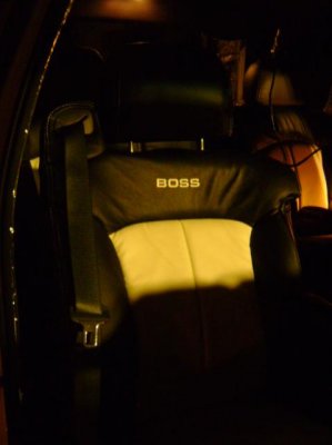

Will have a full album of the entire completed swapout by end of the week...here's a preview..

clean454
May 3, 2009
2,126
i cant wait to see the whole truck!
motivation LOL
how bad does it smell like new pain inside the cabin
or is it not that bad
motivation LOL
SEM Surecoat paint doesn't smell at all after about 3 hours...the truck smells brand new, especially with the leather.
HOWEVER.....the Lloyds mats have a rubber bottom that is actually a fantastic molding, but it stinks like shit for some reason...not sure how I'm going to handle that yet. I might just paint the bastards :waytogo:
