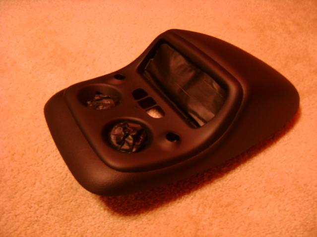

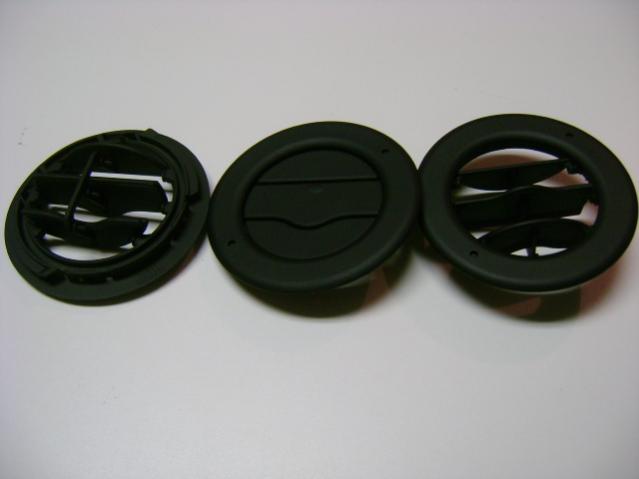

So here are a couple interesting pics of the TOUGHEST pieces to paint, the air vents from the headliner. They are tough because they are so tiny and there are so many angles to hit without globbing up the paint! What I did was tune the settings on my non-HVLP gun to basically allow me to create a airbrush type of spray. I did this by putting a very very tiny amount of pressure on the trigger.
It literally took me no less than 4 hours to prep and paint the 6 air vents...most of the time was painting of course....ugh!
Posting this up too because I think this piece came out really nice, the two textures give it a very cool look:

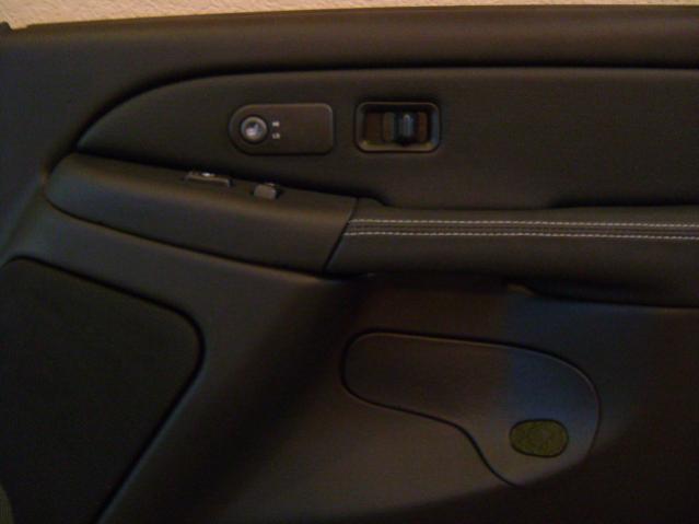

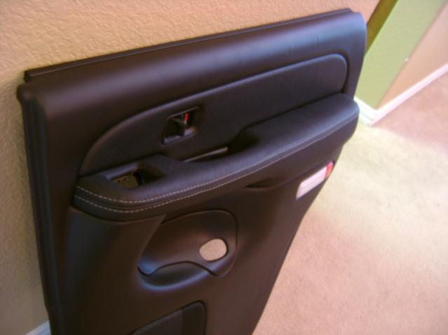

So the doors are done, just need to put in the front door side storage buckets....still haven't put em on because I'm getting the windows tinted Wed.
Front door
Front door close up - I love that white french stitch
Rear door

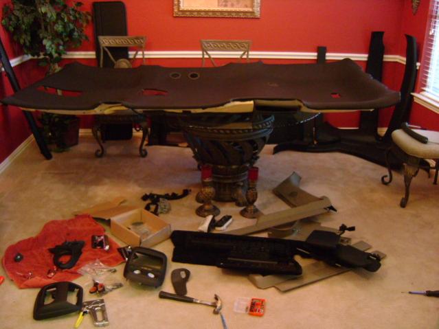

And this is what my formal dining room looks like :waytogo:

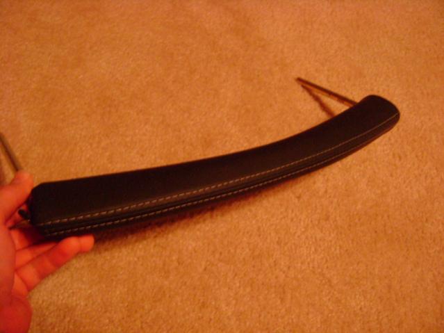

Also re-covered the grab-bar with the white french stitch to match the doors and seats:

Takes about 30-45mins prep per door panel...definitely a little longer on mine because I had to tape off the inserts and carpet. I didn't want to scuff the new paint with all the poking/prodding that needs to be done with the inserts and carpet install. Basically you have to stuff them both inside the crevices to make it look stock.
Door Panel prep:
1) Clean with dishwasher detergent and an non-scuff pad from grocery store
2) Clean with SEM Soap and a green scuff pad
3) Rinse with distilled water
4) Clean with Vinyl Prep
5) Rinse with distilled water
I used distilled water and rags because my water is pretty heavy out where I live. I wanted the panels as free of contaminants as possible. I used about 12-15 rags for all 4 doors..I have to do laundry every time I did a major step in this interior mod :waytogo:
