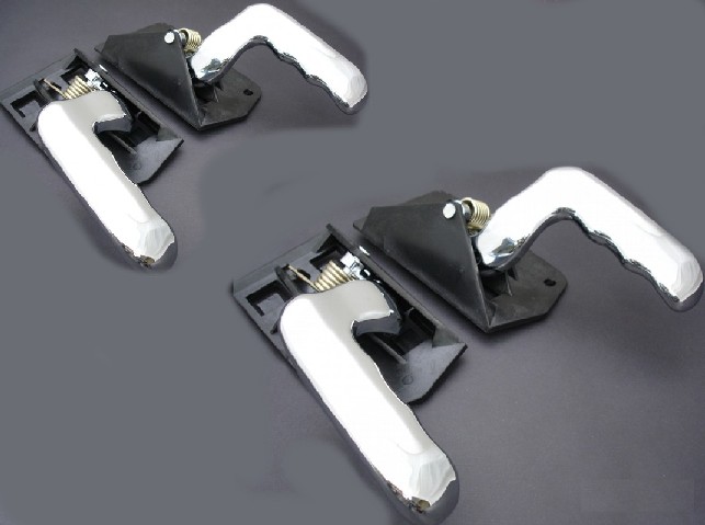

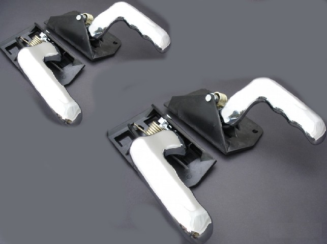

Just ordered 2 pair of these chrome interior door handles to break up the black a little bit, I think they'll look pretty sick against the matte black

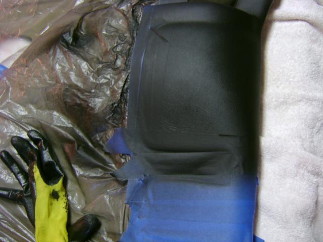

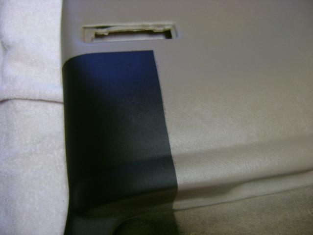

So I sectioned off junk door to test paint with the same mix of black that I used for the pastic, it looks pretty damn good I think. When I test paint these pieces, I always test scratch them in-between coats to see how they are holding up. Even though I did this during the first few junk plastic pieces to get the cross linker just right, I am a perfectionist to a fault....So I use my fingernails mostly but sometimes I'll take out a flathead screwdriver and rub it down the side of the pieces, mimicking something hard brushing up against the interior of the truck. So far so good on the vinyl door with 2 coats, not a scratch. Same process for baking the paint in, use a heat gun on 800 - moving quickly around the piece so as not to overheat. Dries in 10minutes..
I had sectioned the vinyl off on this door so I could test my prep/paint process on the different sections, but looks like I got it right the first time thank god...I needed some time back to do other ****!!

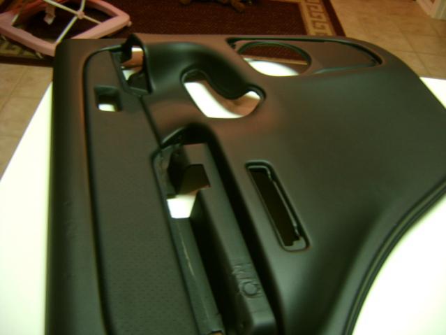

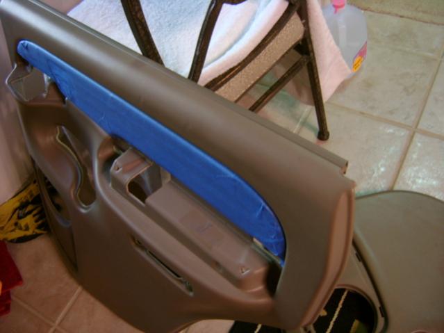

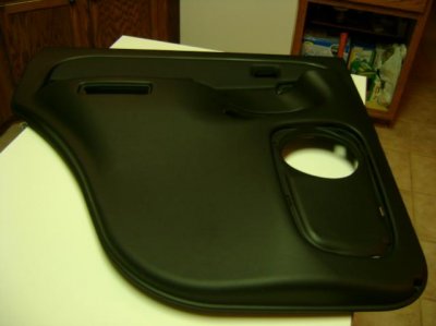

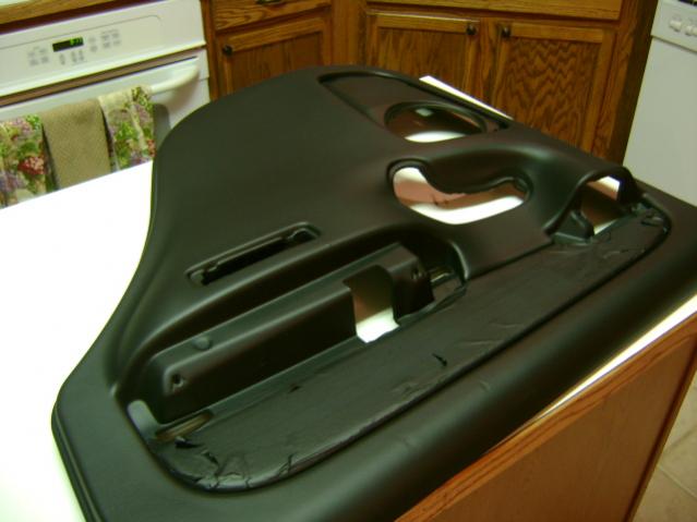

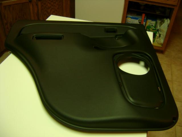

So I managed to get the rear doors painted....this is starting to shape up! All in all the vinyl is pretty easy to paint, I decided not to use the HVLP gun. I didn't want to overshoot my doors and risk uneven coverage whatsoever.
Taping up the perf vinyl inserts:
Fresh out of the booth:
Couple finished pics:

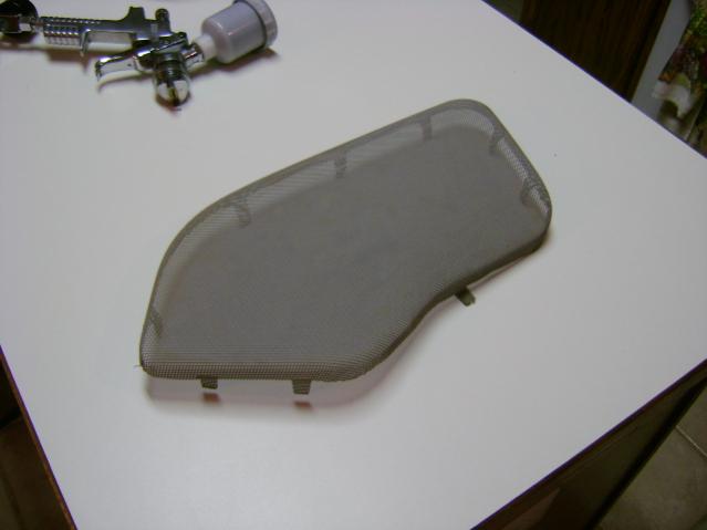

The speaker grills are sandblasted too, not sure when I'll paint em though, maybe tomorrow night. That's the craziness about this swap, it's all the details!

It's a little hard to make out in the pictures, but the perf inserts are just slightly more matte than the door itself...the arm rests are going to be that same perf with a french stitch along the entire outside corner.... in white thread of course ..to match the grab handle and the seats.
