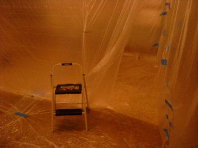

So here's some pictures of the paint booth I built in my 3car garage, it really works well aside from the cold. You can't spray unless it's at least 70deg - well it's not recommended anyway. So I run a portable heater beside the ventilation side and it draws in warm air to heat up the room. I have almost the entire interior to paint and going for 2 coats, so this booth is going to save my ass I think.
It's hard to see from the pictures but the booth takes up almost my entire garage, leaving a walkway to my tools and half of one car space for all my plastic pieces and interior parts.
If any guys in Dallas need something painted, now is the time to hit me up! I'm taking it down when this is all done in December. I've been spending some of my weekends test painting plastic from the junk yard, you have no idea how hard it is to match colors and matte finish when doing this! I've gone through 4 colors of paint trying to get it right from the picture I have in my head.
#001,

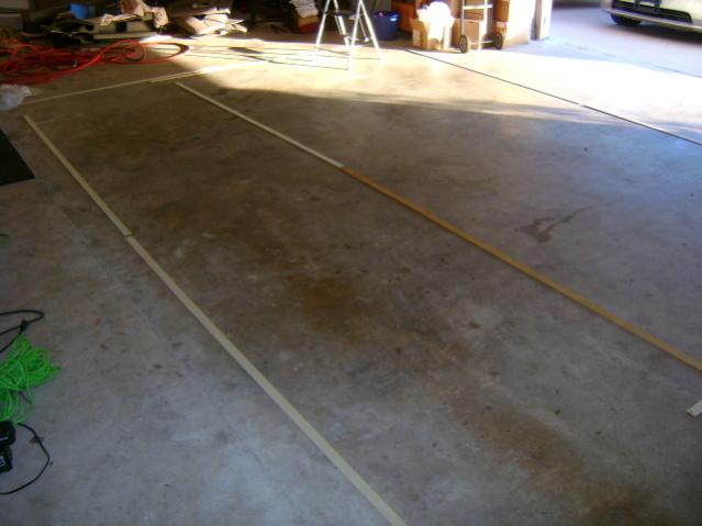

Framing it out (The walls and the ceiling plastic both go under the wood frame inside the actual booth so it keeps the atomized spray from going anywhere except the exit vents , the rest of the plastic is staple gun'd to the frame pieces in the drying room)

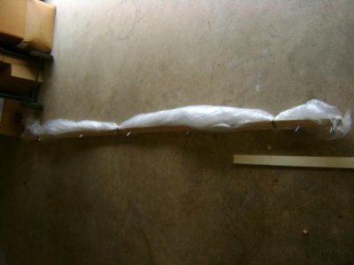

#006
How I installed the frame by myself with pre-rolling the plastic and sticking it on the nails first...there was literally no other way to do this by myself. I would lay the ceiling pieces and a wall piece on the same board and hoist it up myself...serious pain in the ass man

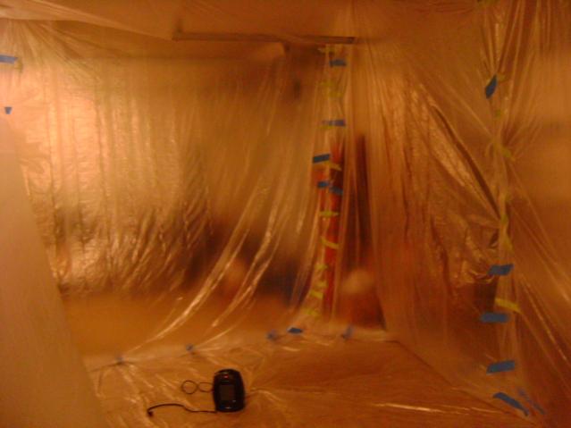

#014

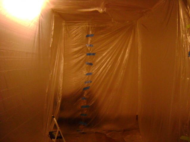

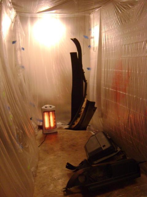

Paint booth room, with heater LOL
#017

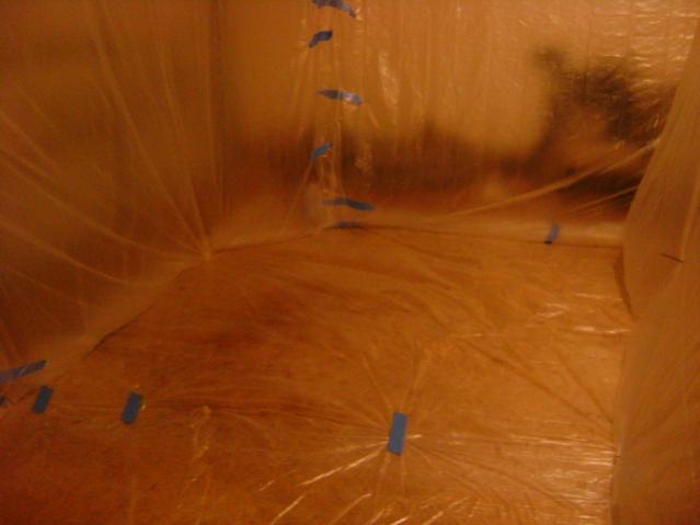

Paint booth - back of the room

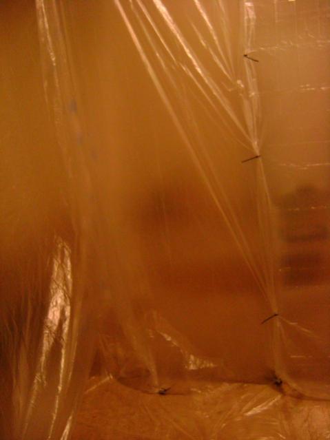

Wall seams between the booth and the drying room

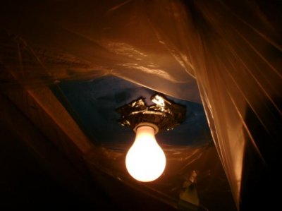

#26
Good ol' Dynamat, keeps the plastic and tape from melting :)

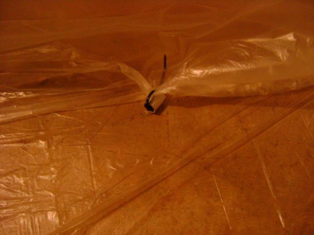

Used sockets and a twist tie to hold down the seam between the booth and the drying room

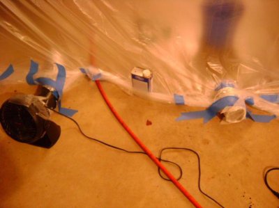

Using a fan and washer/dryer hose from Home Depot wrapped in plastic to ventilate all the paint spray. The dryer hose is rigid so it allows the plastic to be seamed up around it easily. There's 3 vents and a fan vent pulling air out. I use dryer sheets on the vent-in and the vent-out to catch the paint spray molecules and keep them from going in the garage. I learned that trick in the college dorm :)
It's amazing how quickly the room clears when I'm spraying, I didn't think it would honestly. The trick is of course, I have to stay on that side of the room for it to be most effective.

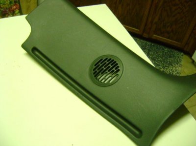

Never heard of it to be honest, I'll keep that in mind. I went with SEM products. They make an elastomeric paint which holds up good to flexing/bending. They have several products to enhance the paint too, a flattener for customizing the look, a reducer to thin it out for spraying and an agent called cross-linker which strengthens the paint against chemicals and abrasions. It will still scratch if you scratch it hard enough of course, but since most OEM plastic is molded, it means the color is in the plastic itself and has more resistance to mild scratching than painted surfaces do.

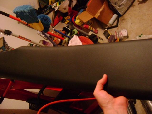

Here's a test spray I did on junk plastic, I think I got the matte % exactly where I want it now. This is actually listed as a GM black color, although you can clearly see it is NOT a black....adding to the frustration of getting colors correct when you are just going by charts and eyeballing what you want in the result. This one is by no means any perfect piece, I had taped it off, test scratched it throughout 3 coats over a 4 hour period to test different concentrations of cross-linker, repainted it etc. The final coat is a 20% matte finish. I think it's flat enough for my look. :)

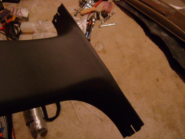

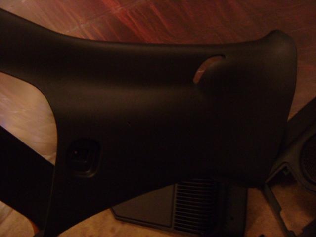

All of my panels are now semi-matte black:

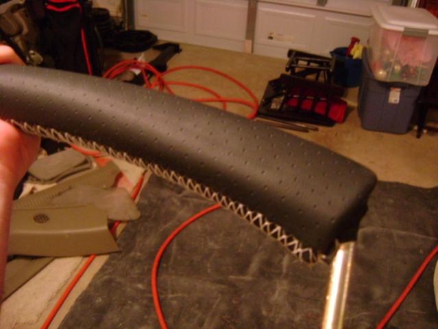

Covered the grab handle in the same perf vinyl with a white double stitch like the leather:

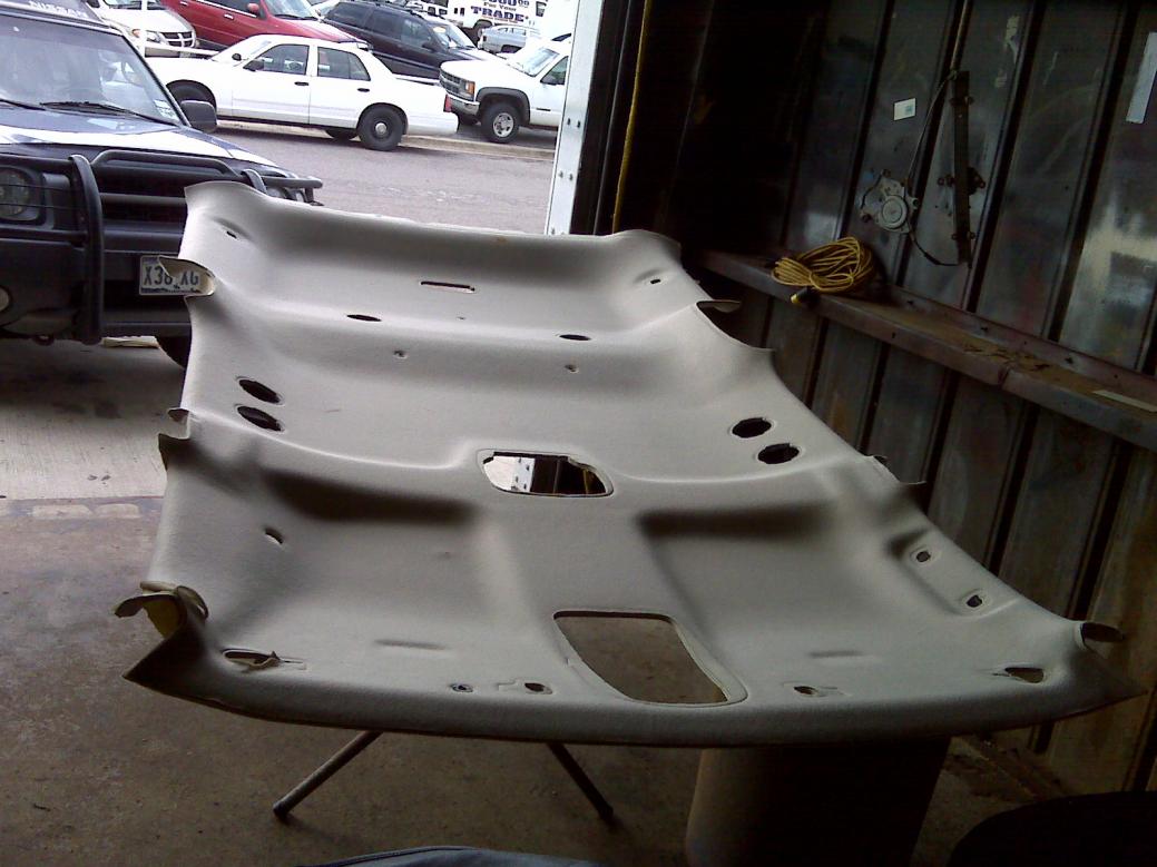

Here are some more progress pics of the headliner, I chose the stitch material from Lexus:
Headliner before...ugly ass light tan:

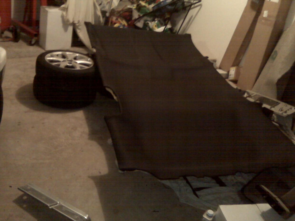

Headliner without cuts yet...you just make X cuts and pull them tight/glue on the backside:

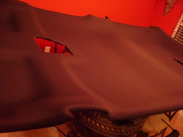

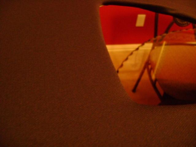

Headliner close up:
After cutting holes for the lights..sorry for the crapass picture:

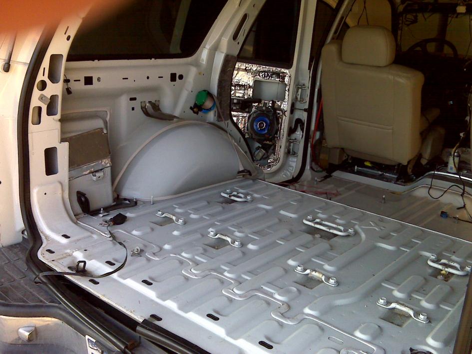

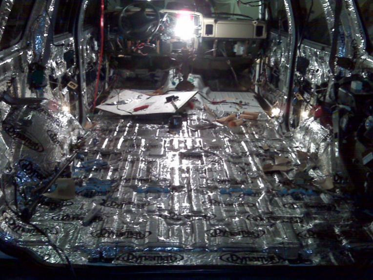

Some of the dynamat work....ended up with something stupid like 180sq ft inside and out of the truck!
Most of the interior pulled:
Dynamat in:

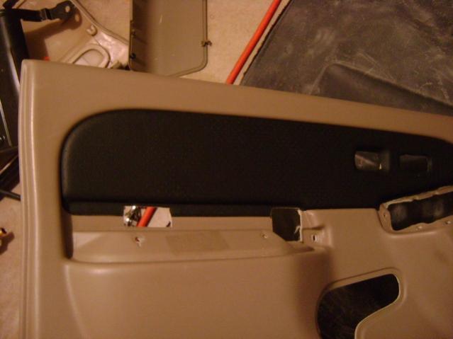

When I get the doors done today I'll post em up. I'll try to include some better information as I go with how this is all done with painting etc.
The doors are vinyl, they're very hard to recover due to all the curves etc. I'm prepping the vinyl and painting with the same semi-matte black that I used for the door panels.
First thing's first, going to clean/prep/paint a tahoe door I got at the junkyard to make sure I know wtf I'm doing :buffer:

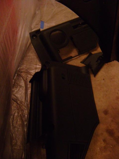

Took a break to eat some lunch...here's a couple cool pictures:
Panels Drying - you really should use a heat gun first to gradually dry them out, it takes me a bout 15 minutes per panel on 800 deg. Move around alot to avoid heating the paint up too much - it will bubble, learned that much already! I also suggest putting in a portable heater too as I did in the drying room, it will help the paint bake into the plastic a little more.
Couple panel shots:

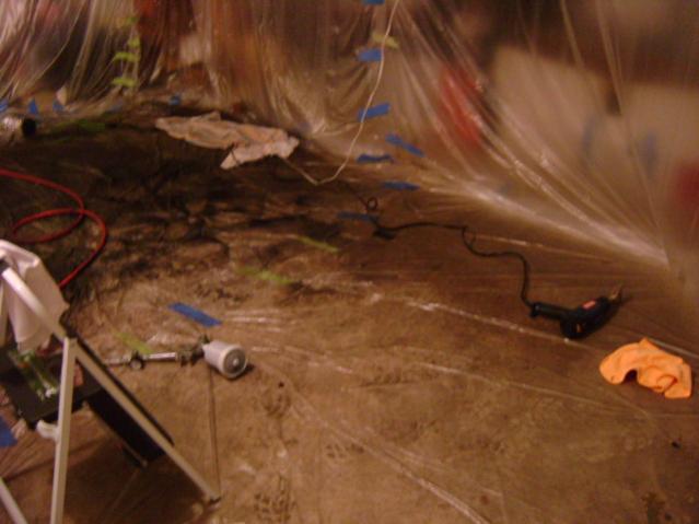

Paint booth is an absolute mess now, BUT free of dust and paint in the air, which is the key so you don't cross contaminate any plastic with the previous spray:
