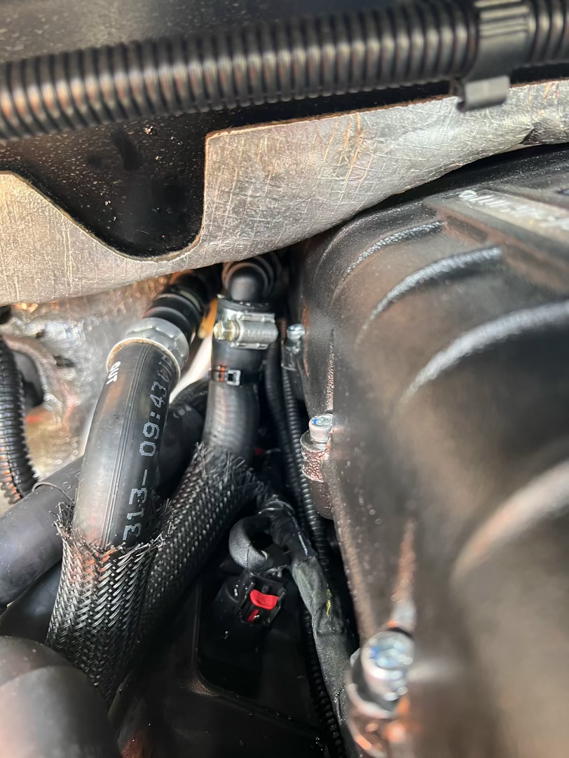

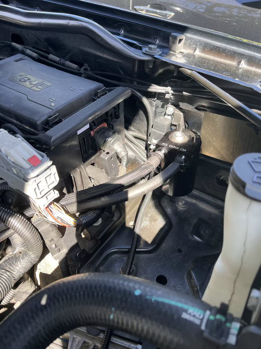

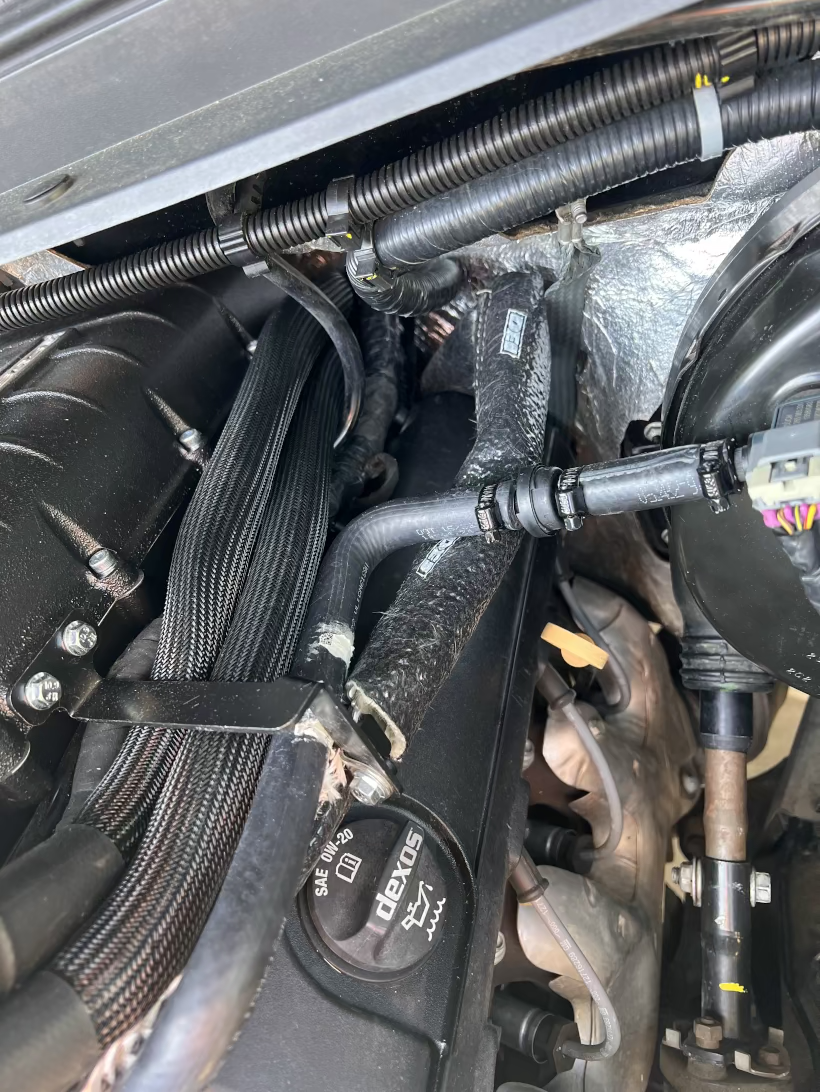

I have mounted a cheap Jungle site Oil separator can on the Driver side fender. The picture with the heater hoses is where the instructions tell you to bend the inner hose, but you need to bend the outer as we'll. This is after I had it all done but kept smelling coolant after driving so I took these hoses off and bend the outer pipe also to get clearance. As you can see its a very tight fit to the firewall.

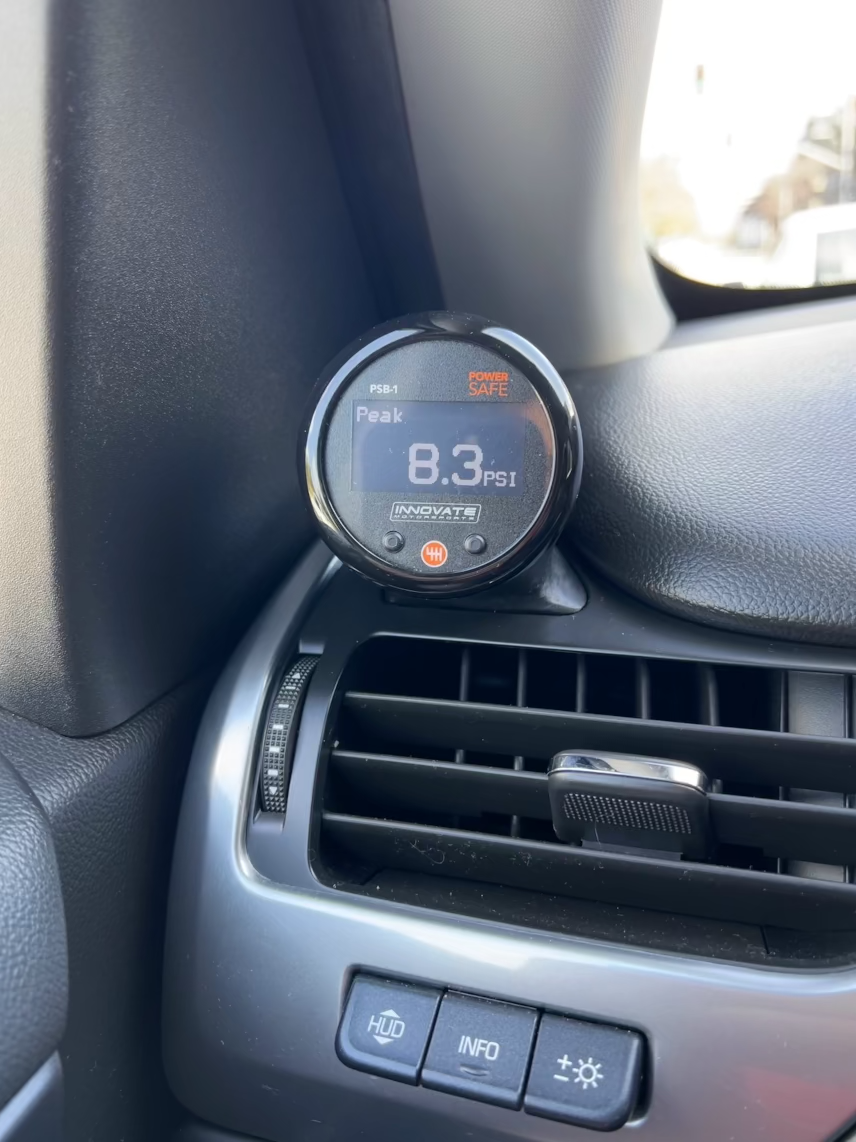

I have seen 8.3 PSI max so far. wonder how much its suppose to make with stock pulley.
