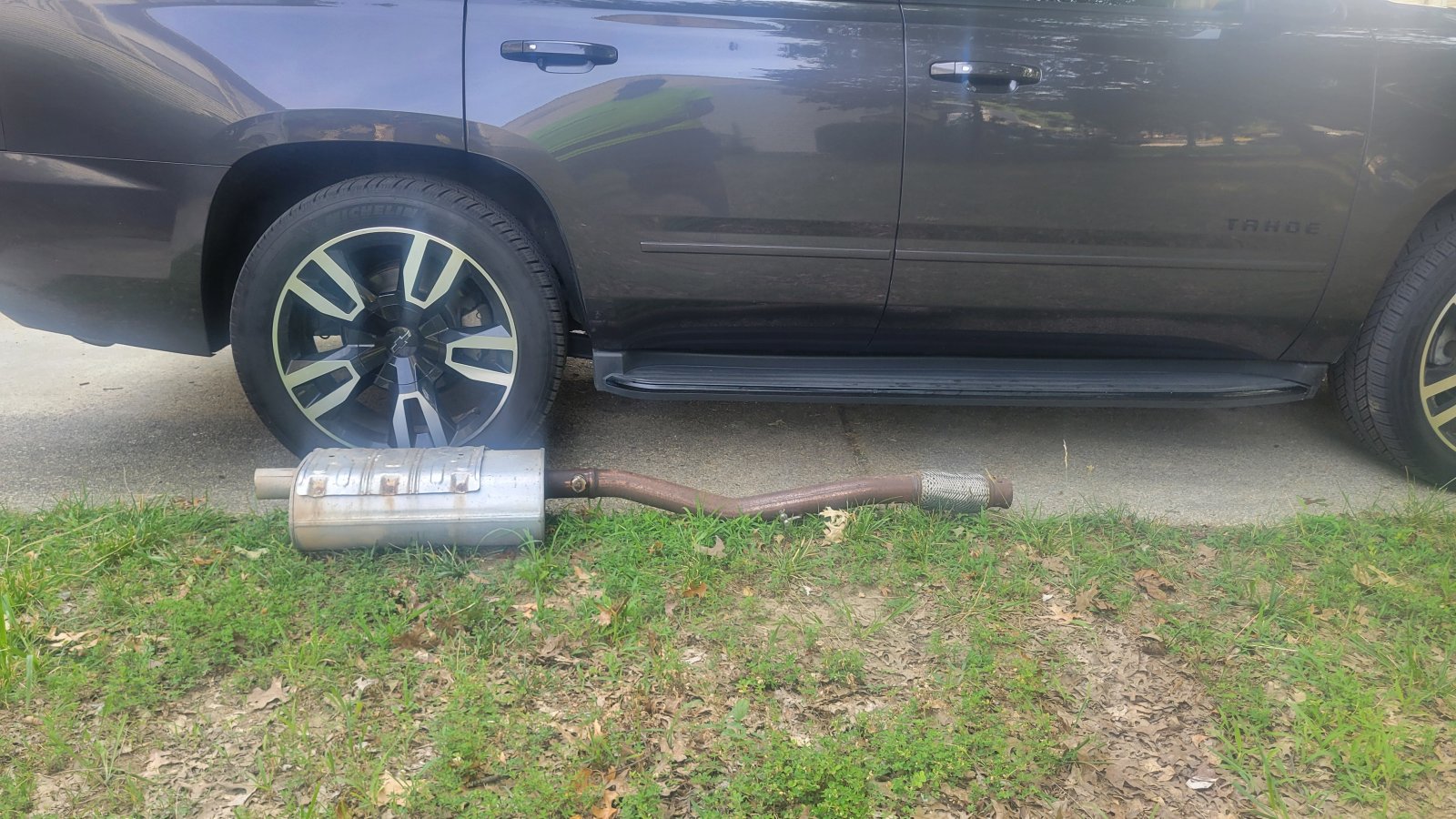

The silverado version is longer. I picked up a silverado oem catback to modify(and retain my stock exhaust to swap back one day) and it's noticeably longer than what's on my 2018 Tahoe.
I'll try to get a picture of it next to the truck in-line with where it mounts up to the y pipe for reference...
Silverado catback seen here would def hit the rear axle unless shortened
