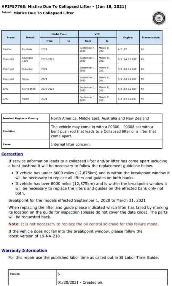

So far I haven’t had any issues but I’ve only got 5k miles on it. Also the TSB talks about lifter issues between Sept 2020 and March 31, 2021 build dates so I’m hoping that maybe I’m lucky and won’t have an issue.

Would be interesting for everyone to post the build dates and mileage of their vehicles and where you are located to see if there is a pattern. It looks like the very early builds had issues. Watch this video this guy says he got info from a tech friend of his that this issue is happening for build dates between Sept 1 2020 to March 21,2021 on sierras and silverado's but don't know if that is across the whole GM brand. I seem to see a lot more of the chevy's have this issue, at least on this forum.
Also here is the info the dealers get about the issue and what to do .
