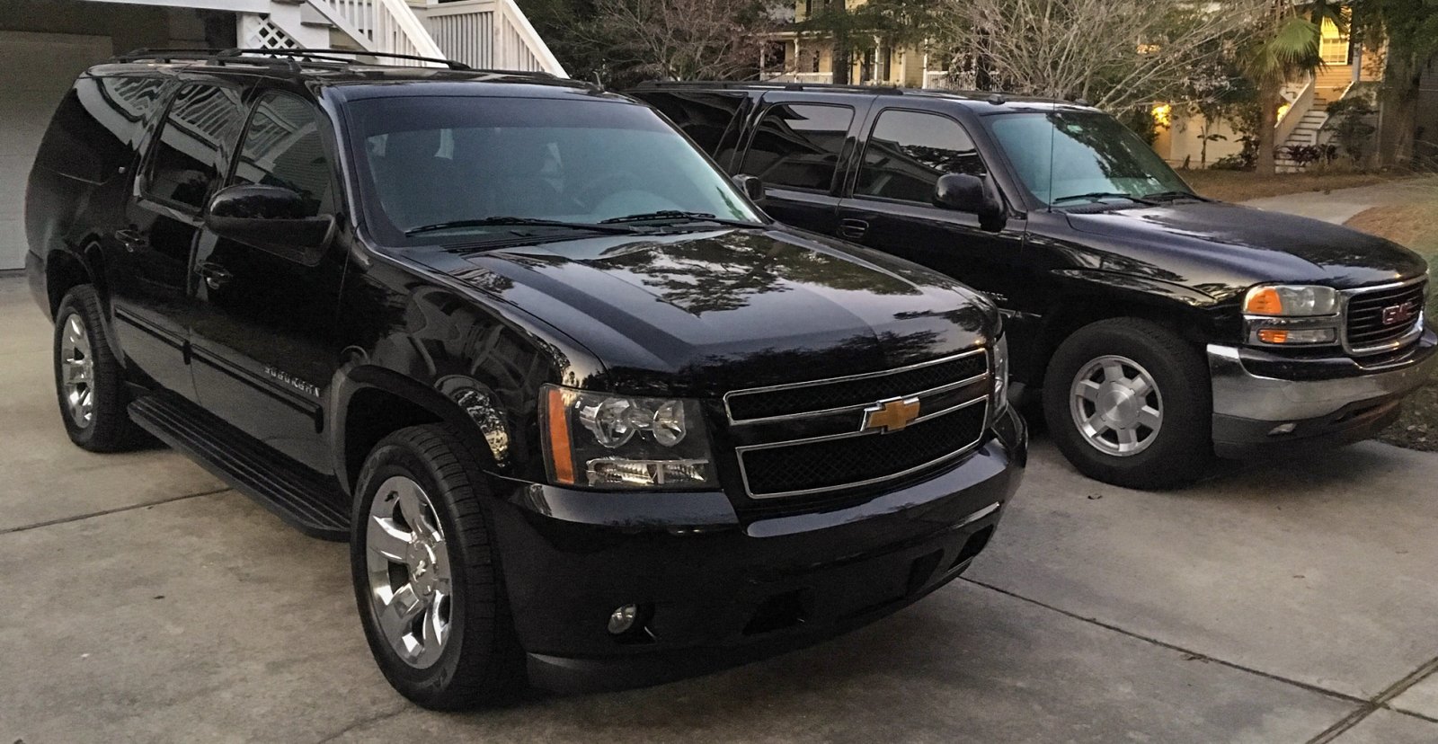

Thanks for the feedback. Makes me a little more confident that I buy this 2014 LT I can replace the wheels with 18" rims and better tires for an improved ride - not sure it will match the 2005 ride of course. (I have a line on new factory 18"x8" wrapped in Michelins at a local tire shop. The tell me a client 'upgraded' a new Silverado with 22" wheels.)
These suburbans are better in a straight line than canyon carving for sure (I have another car for that) so a smooth quiet ride is preferred.
