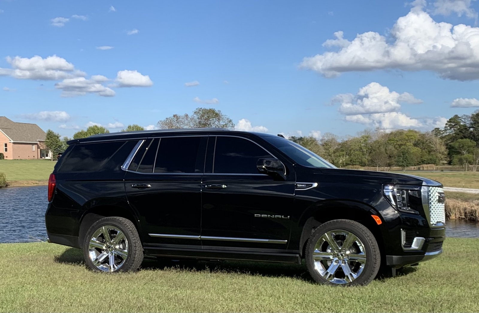

285/50r22 on 22” +24 offset. No level. Had one ready to install but did not need it.

Looks nice. The 285s are a little bit bigger than the 275/50s that are stock on the Denali. I'd love to put 305s without any mods like my 2018 if anyone has gone bigger yet.

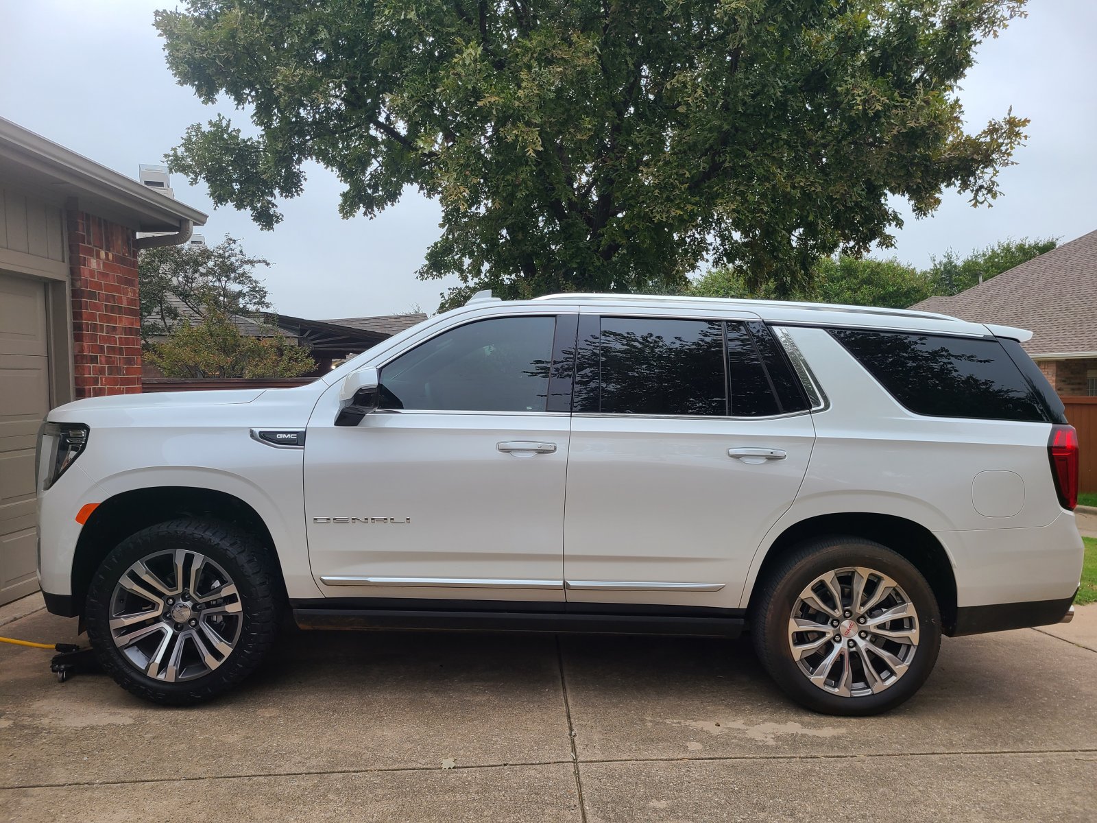

I tried mounting up my wife's wheels today just for a test. As Tricky1 noted the calipers on the '21 are much thicker and will hit the 2018's wheel. It probably would need at least 1/2"-3/4" of a spacer to use those wheels. Her 305s probably would have cleared or at least with the heat gun mod on the wheel liner trick. They do not hit any suspension hard parts like the 2018's sway bar.
The 305s did not stick out of the wheel well much more than stock and would probably be ok. They look soooo much better than the stock tires.
I'm still on the fence of whether I like the stock wheels or not, so I may wait to pull any trigger. I hate just basically throwing brand new tires away. Hopefully some others will post up more options as time goes on and we can learn what will work or not.

Does this have 2” level in the front? Looks high?... or is it just up in the jack?

It's still on the jack in the photo. The wheel was touching the caliper and I didn't want to tighten the lugs and scratch the zinc plating.

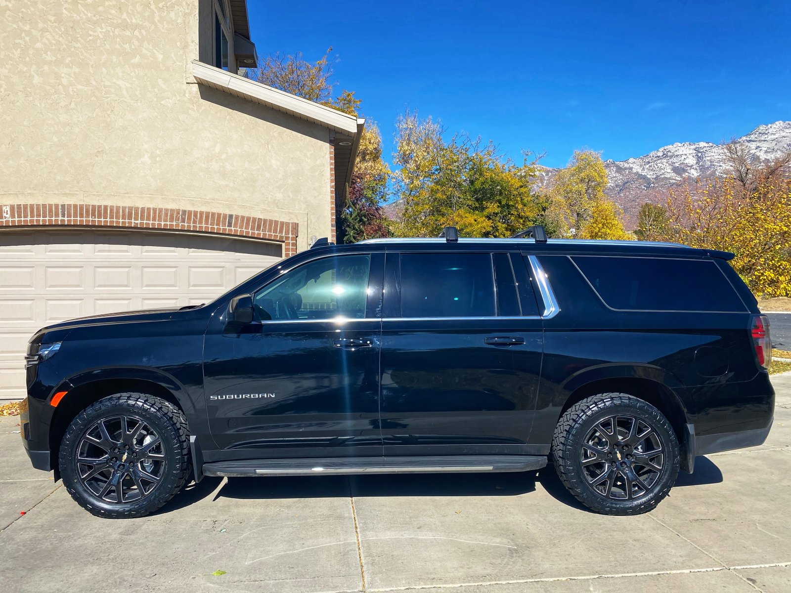

Looks fantastic! I just added 285/50r22 Grapplers to my 2021 Suburban. I am waiting on black trim and rails for the build to be complete, but I am wondering what the ride quality has been for you and what tire pressure you are running? The ride quality has definitely been worse than the stock Alenzas. I've wondered if that will improve as the sidewalls soften? I have been running 36 PSI as rest and they hit 43 hot when at 90mph on the freeway. The tires cause the vehicle to float and bounce over bumps in the freeway and the car dives into the corners.

BTW, my Ridge Grapplers on my '18 ride great. If firmness is your issue, then drop it to 34 and try it. Unfortunately, sidewalls on tires don't change their characteristics over time, so air pressure is your main control. I think they do make different load ratings in them. It's possible you got the max load rating. You might be able to swap them out since they are so new. Best of luck and the truck looks great.
Thanks! I do absolutely love the look of the these tires. I have stock mudguards and when I back up with the wheels turned completely, I do rub slightly on the plastic...
Thanks!
Paul
Looks good! No doubt the ride is a bit rougher than the Alenzas, but I am used to it. Have run these tiers on my last 2 vehicles. Its to be expected with a more aggressive tire and the 22's. I run mine at 40psi and have gotten over 60K miles on last 2 sets. I have not ever had any issues with mine floating or bouncing, that seems odd to me.
I think I am going to add a 1" front level to mine to get of the rake.
