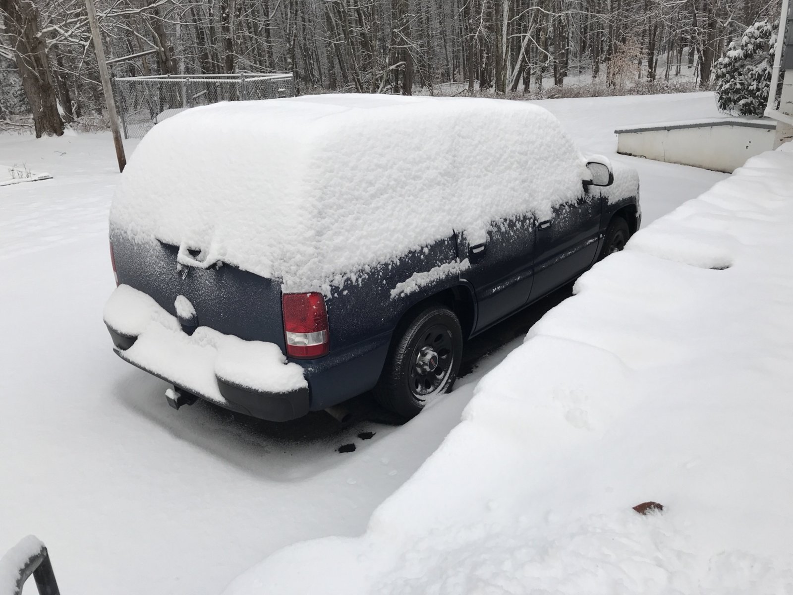

i did new brakes all around yesterday. last owner looks to be a pad slapper for 121,000 miles.
ordered up some bilstein shocks cause i also got them Nivomat shocks and they be shot. those get done first acceptable day for out side work.
also ordered up wheel paint and body color paint, billet grills, to bad none of that will happen till i get warmer weather.
hey and it snowed for Christmas for the first time in idk, decades dare i say.

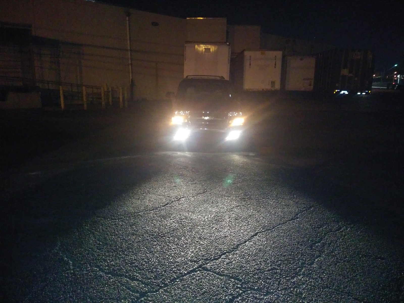

I need to do this. What is the best way to do this?
on the bottom of each light is a large wing nut type adjuster nut.
i went into a darl lot aimed one as far out as they would go matched the other one. then took it to a wall bout 10 feet off it and fine tined the cut off line so they were both even. took a walk out in front of it and was not blinded by them. called em good.
i could drive with no head lights if need be pretty much. lights up the road pretty good.
