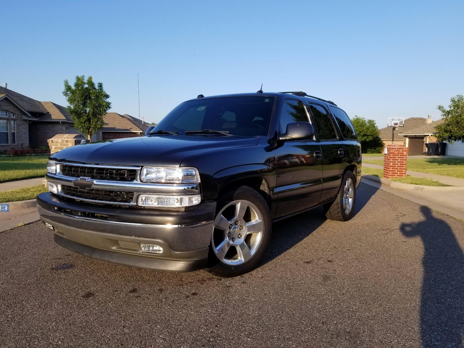

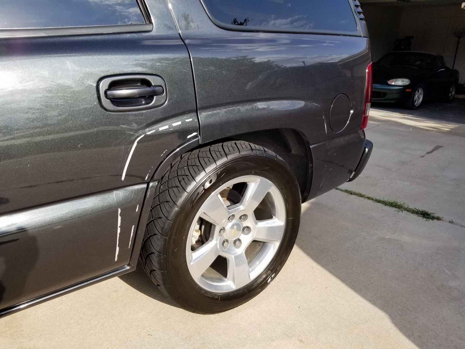

I took some of my holiday free time to pull the fender flares off the Tahoe. I was expecting paint damage and I definitely got it.
I had to give it a wash before I removed all the adhesive.
I broke out the DA polisher and went to work. It's not perfect but it's a good 10-15 footer now at least. I love the way the truck is turning out and hopefully soon I'll take it to have body and paint work done for real.

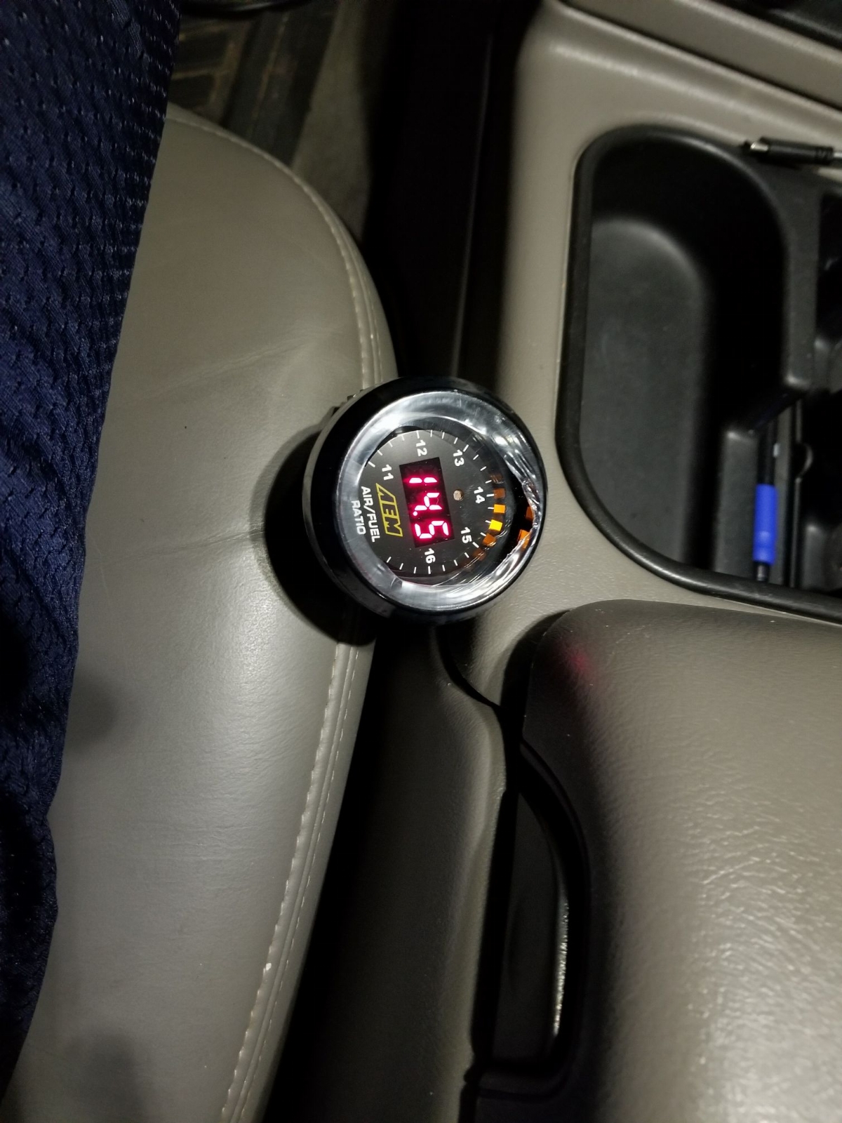

Friday night was wideband time. My boss finished welding in my O2 bung and on his request I'm not showing you guys because it looked awful and he's embarassed BUT it works and by, "it works", I mean that there was only a small pinhole leak around the bung and I just slathered on some copper RTV sealant and it's probably totally fine... :D Anyway, here is the gauge in it's temporary home until I find it somewhere to live during tuning.

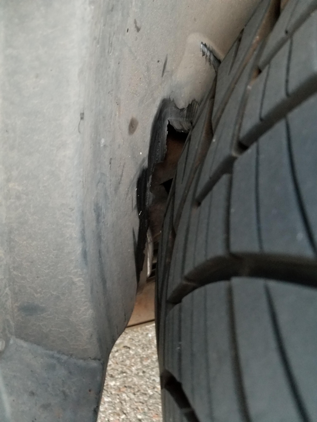

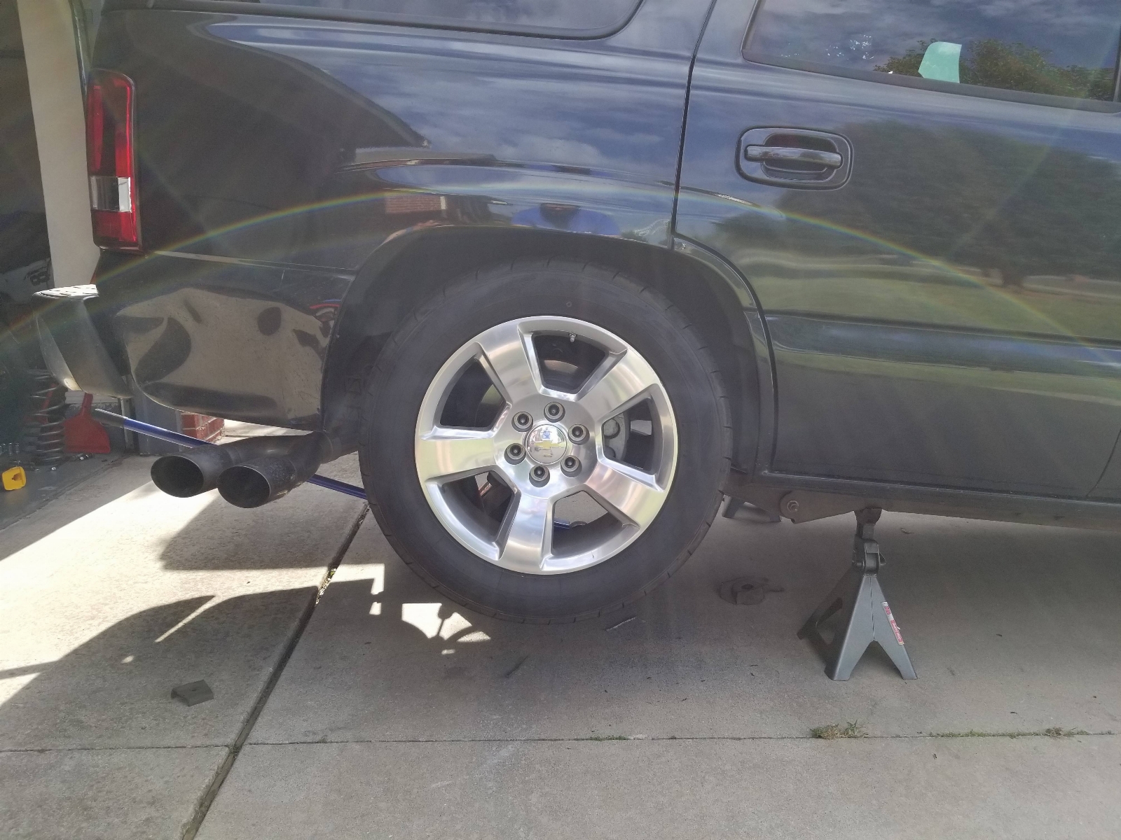

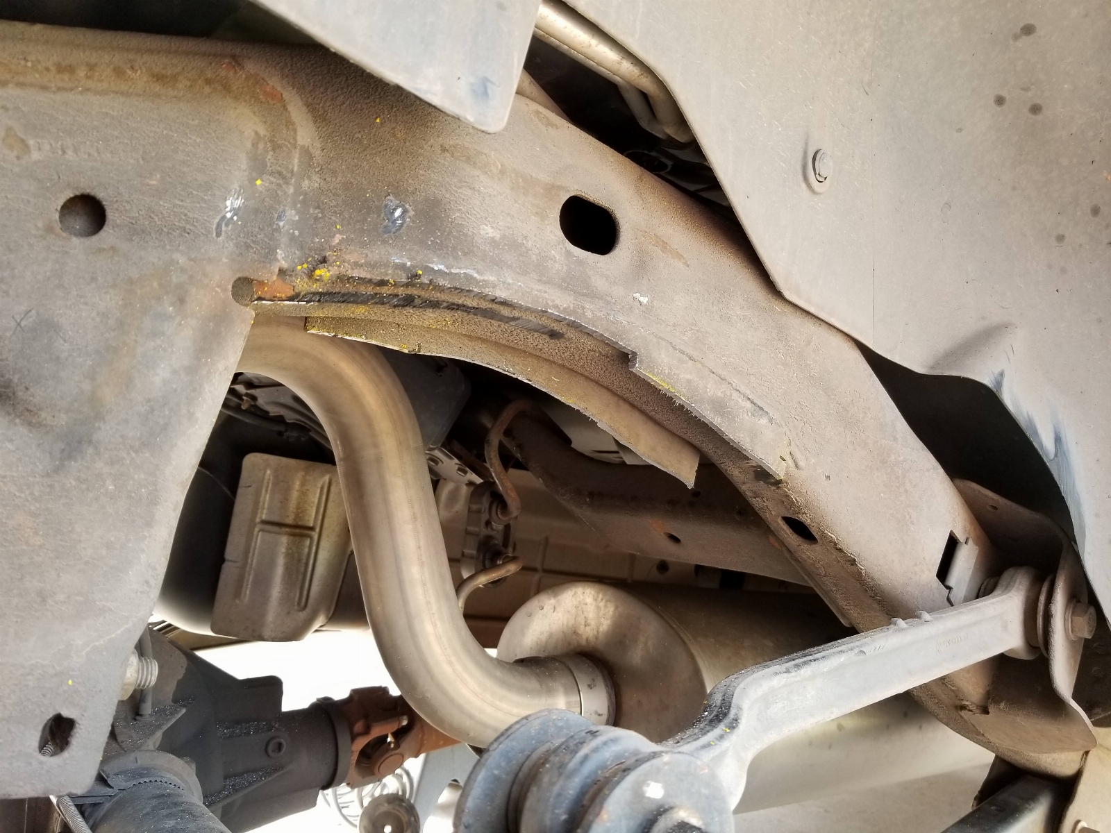

After that I decided it was finally time to do some annoying work. When I did the suspension work before and lowered the Tahoe I completely forgot to do the free travel mod so I jacked up the Tahoe and dropped the suspension. Look at my pretty springs! My friend noticed after I pulled the spring on the passenger side that it was actually contacting the frame where the bump stop bit was welded on and since we were cutting all that off anyway we made sure to clearance it on the inside of the frame so alleviate that issue.
Here's one of the offending pieces.
And first cut done.
Of course I didn't take any more pictures of what I was actually trying to accomplish because that would be silly. Luckily for you guys I'm sure there are a hundred other build threads around with better shots. What I did do though was check my suspension travel and verified that my rear inner tires are rubbing the fender liners when near full compression and I saw marks that led me to check that. This means I'm likely to put a 1/2" spacer on the rears to get rid of that.

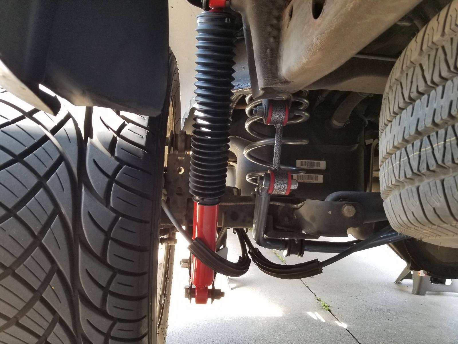

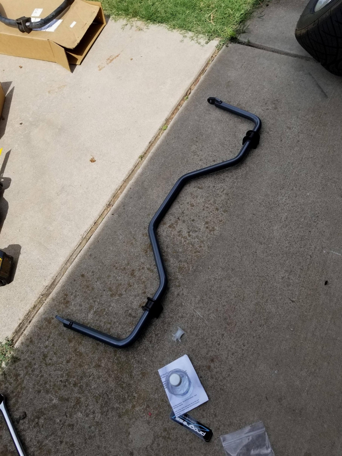

Finally as I was putting it all back together my friend remembered that I never installed my new sway bars so we at least broke out the rear and put it in. This thing is a BEAST. It is a solid bar, not a tube...
In the end, the Tahoe rides significantly better in the rear over bumps. Is it as good as factory? No, but it's a hell of a lot better than before. I think the rear is in for new shocks to match the front before I go to Colorado in August and I want to get my SS brake lines done before then as well. If I get those two things done along with actually tuning my truck I think it should be a good trip to test it all out.

Which sway bar did you go with? I have 305 45's in the rear , that had the same issue--making contact when suspension was compresding. I hit the inner plastic liners with a heat gun and it was good to go. I was hitting the plastic that was covering the upper part of the shocks.

I got the DJM sway bar set, they are beastly. Mine is rubbing towards the front of the vehicle on the plastic liners and I could just modify the liners or cut them but I like the look with the rears matching the front track and these trucks always have a wider front.

You can see here why I was so interested in getting them on. This is the driver side on the front of the wheel and it has chewed up the liner a LOT and you can see the bright spot where it's been rubbing against the frame where the upper arm is mounted.
Next was replacing the rear shocks to try and get the last bit of ride quality I could out of the rear. I went with KYB MonoMax shocks since I like how they ride on my lowered Duramax and they do more than I thought they would to help smooth out the ride over rough terrain and they look great in red matching the rest of my aftermarket suspension components.
Front sway bar was last for the weekend, it is a real beast like the rear but it's not 3x heavier than the factory bar like the rear was either. Very easy swap.

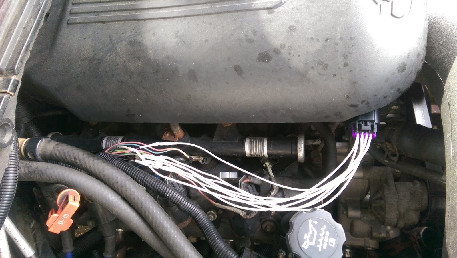

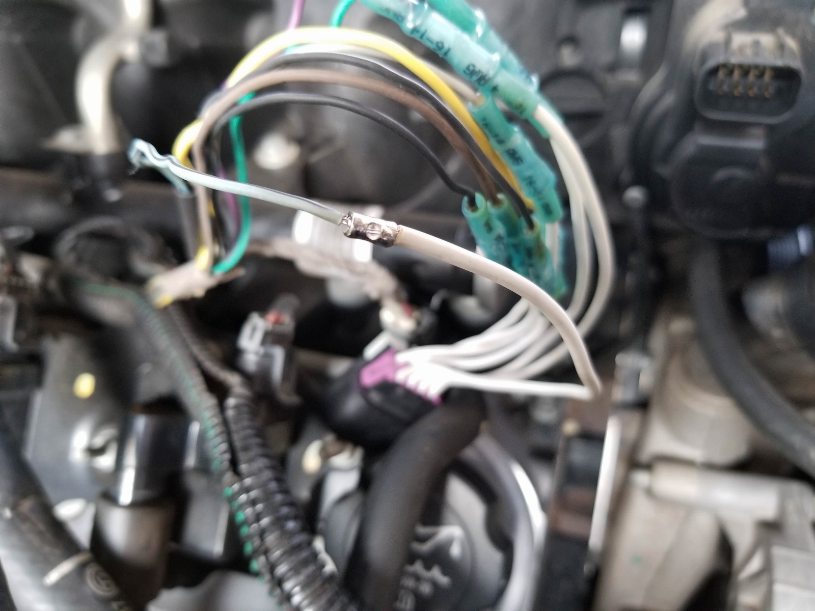

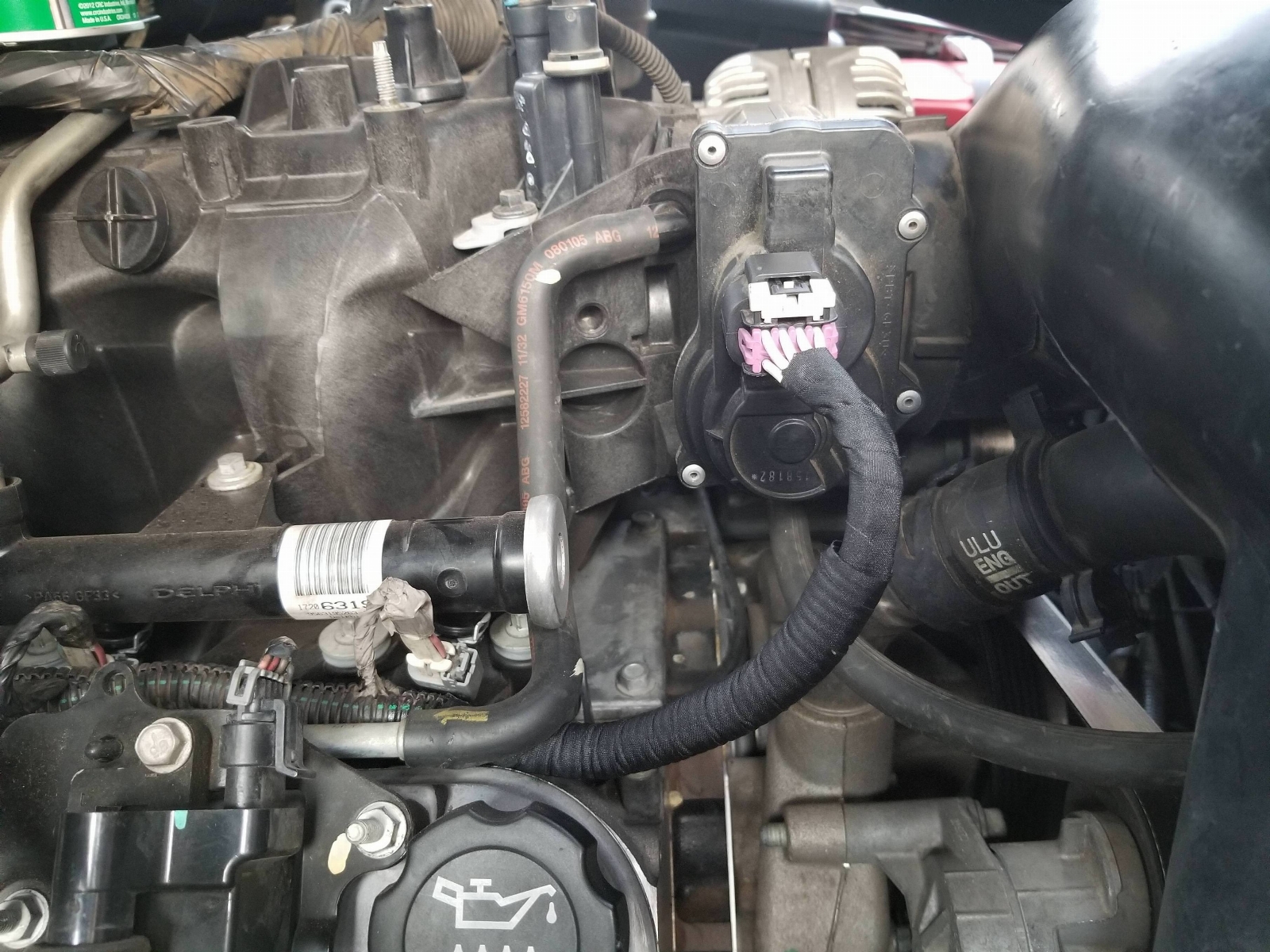

Well the Tahoe stranded me yesterday just as I was about to merge onto the highway at 4:40pm :thumbsup: I saw Reduced Engine Power and the a/c went hot as it slowed to a crawl and died. It would barely stay alive at idle with the a/c off and if I even pressed the brakes it would die. My wonderful new engine covers prevented me from accessing anything that I wanted to check on and of course my tool kit that I keep with the Tahoe was in the garage at home.
After AAA towed me home I found that the pigtail harness for the throttle body that was replaced on warranty was only connected with butt connectors and wasn't done how GM specified and doing nothing but fiddling with those I got it to start up and run perfectly again. I will be re-crimping and soldering all of those connections this weekend hopefully because that will not be the reason I am stranded again. Since I was already a little dirty I went ahead and re-routed the wiring for 12v for my wideband and re-routed the 5v and ground to be easily accessible to my HPtuners VCM so I can have it all nicely hidden when I'm not logging or tuning.

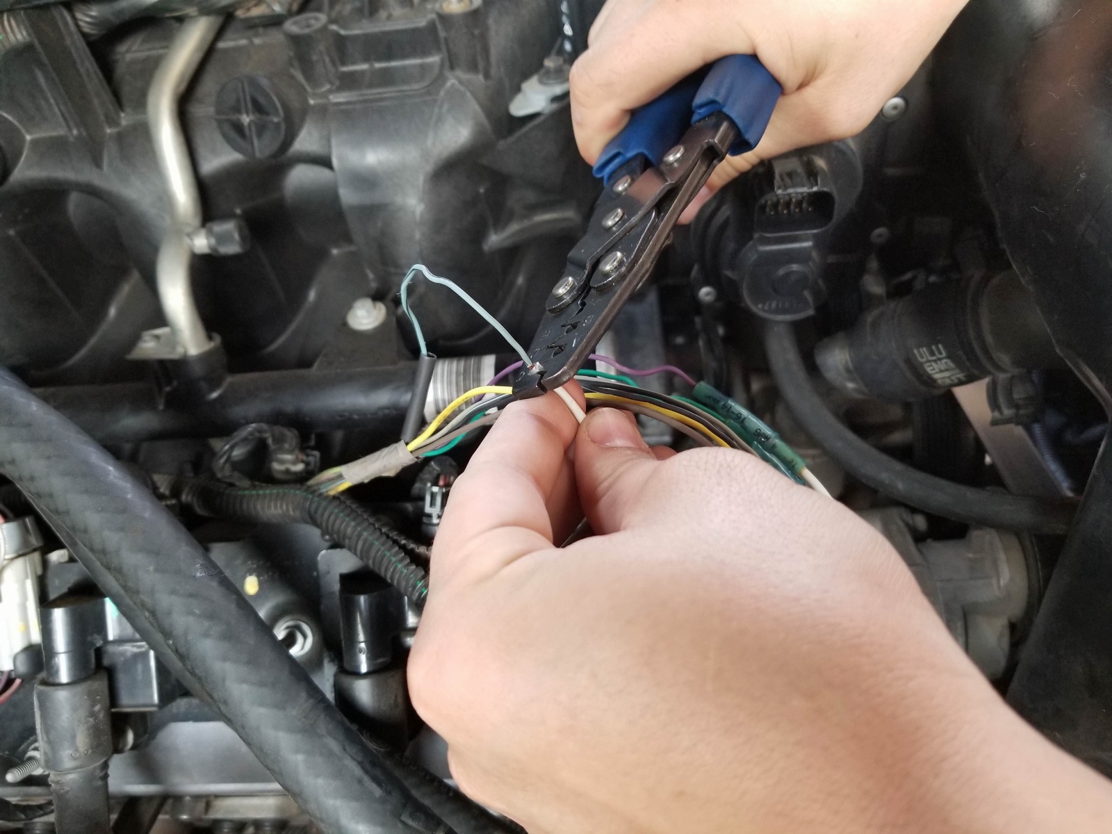

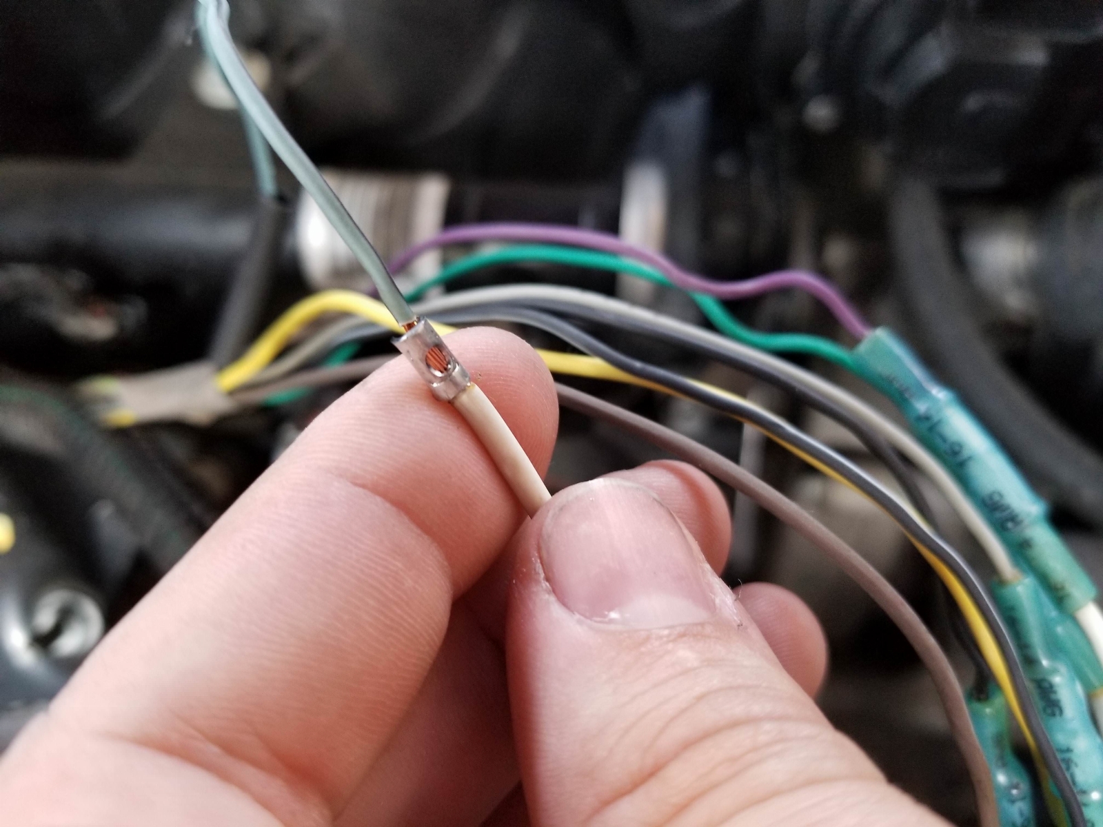

Pigtail redone and it might just be in my head but I swear the pedal is more responsive. I know that these are very sensitive to resistance so it's totally possible but who knows.
First we remove the crappy crimp connectors that were oversized for the wiring and didn't hold it very well in the first place. Then we strip and crimp with the new GM crimp connectors.
Then solder and heatshrink.
Finally we wrap it all up with the super fancy fabric electrical tape and plug it back in!
I think the original tech that did the repair put each crimp at a different length so that there wouldn't be a giant bulge of crimp connectors in one spot so I just went with it instead of making them all the same, and then much shorter overall, length. Either way, I now feel much better about this truck making it to Colorado and back in a week and a half. Coming soon is panhard bar, front upper control arms along with an alignment and hopefully SS brake lines all before the trip.

Normally do that when splicing stuff in, fits in wire loom better and less chance of things shorting if they come loose somehow.... not that yours will, but generally a good idea if you you have the slack in the wire to do it that way.
I like to as well. I guess I should have said that the original tech attempted to do this but it didn't turn out so well.

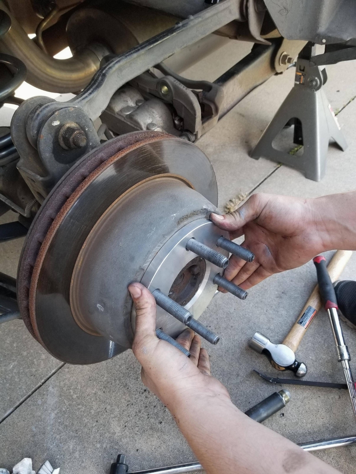

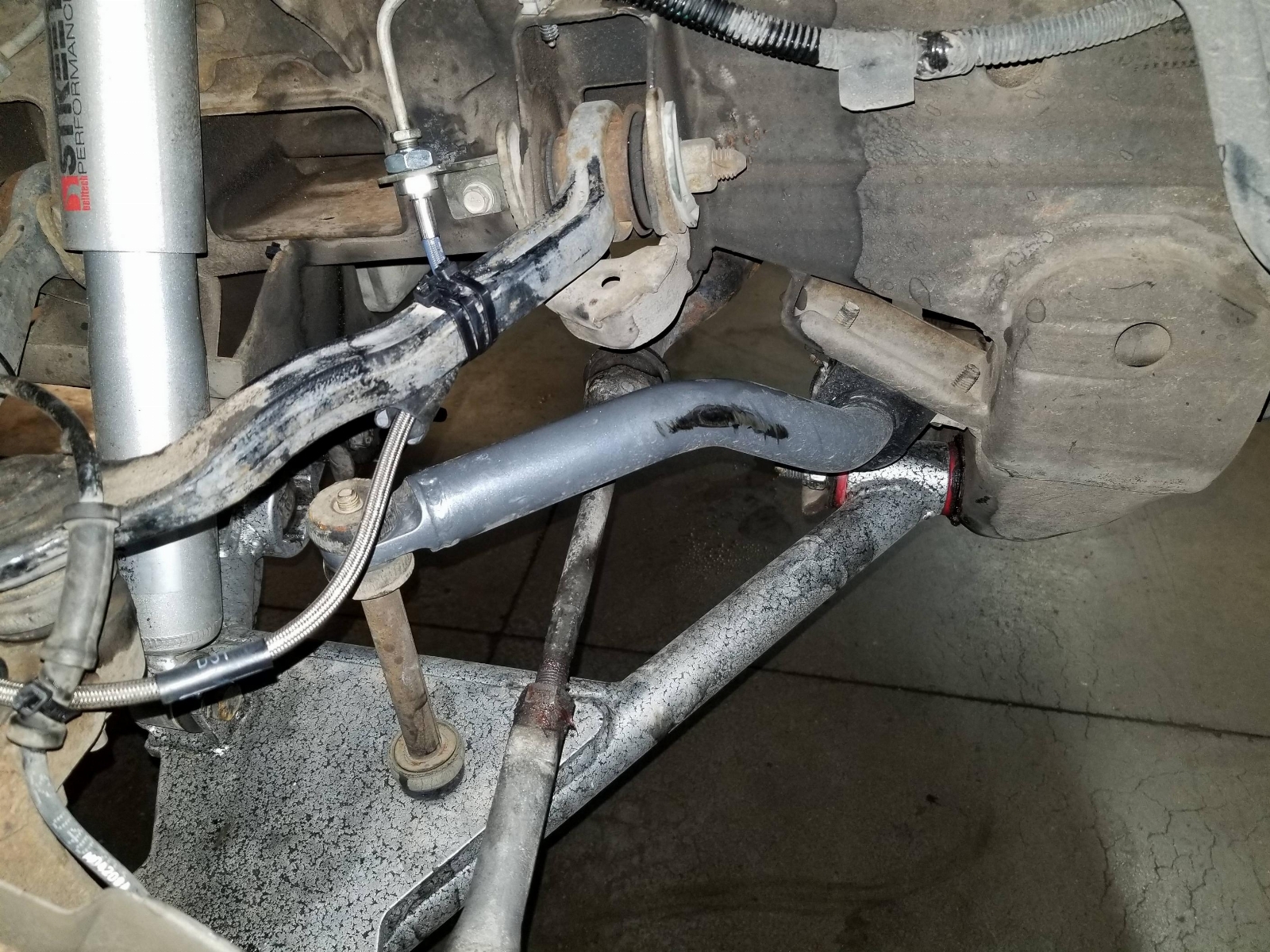

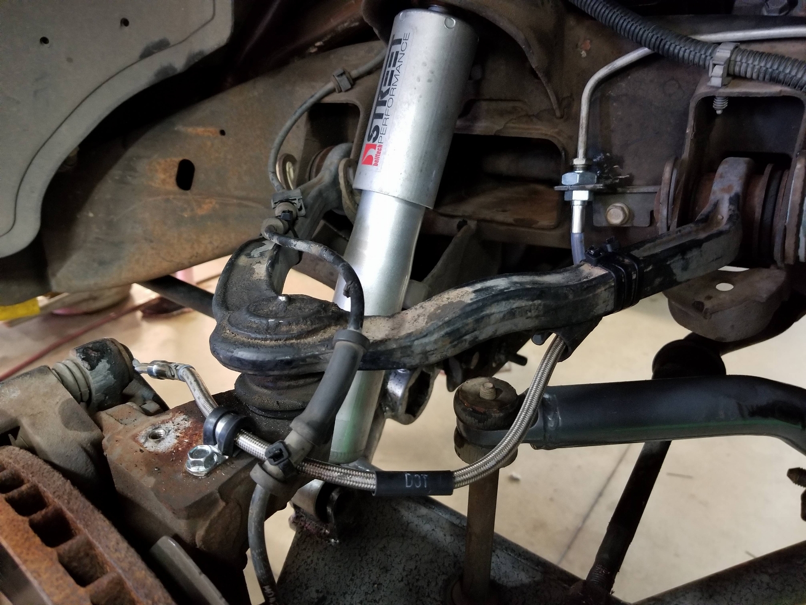

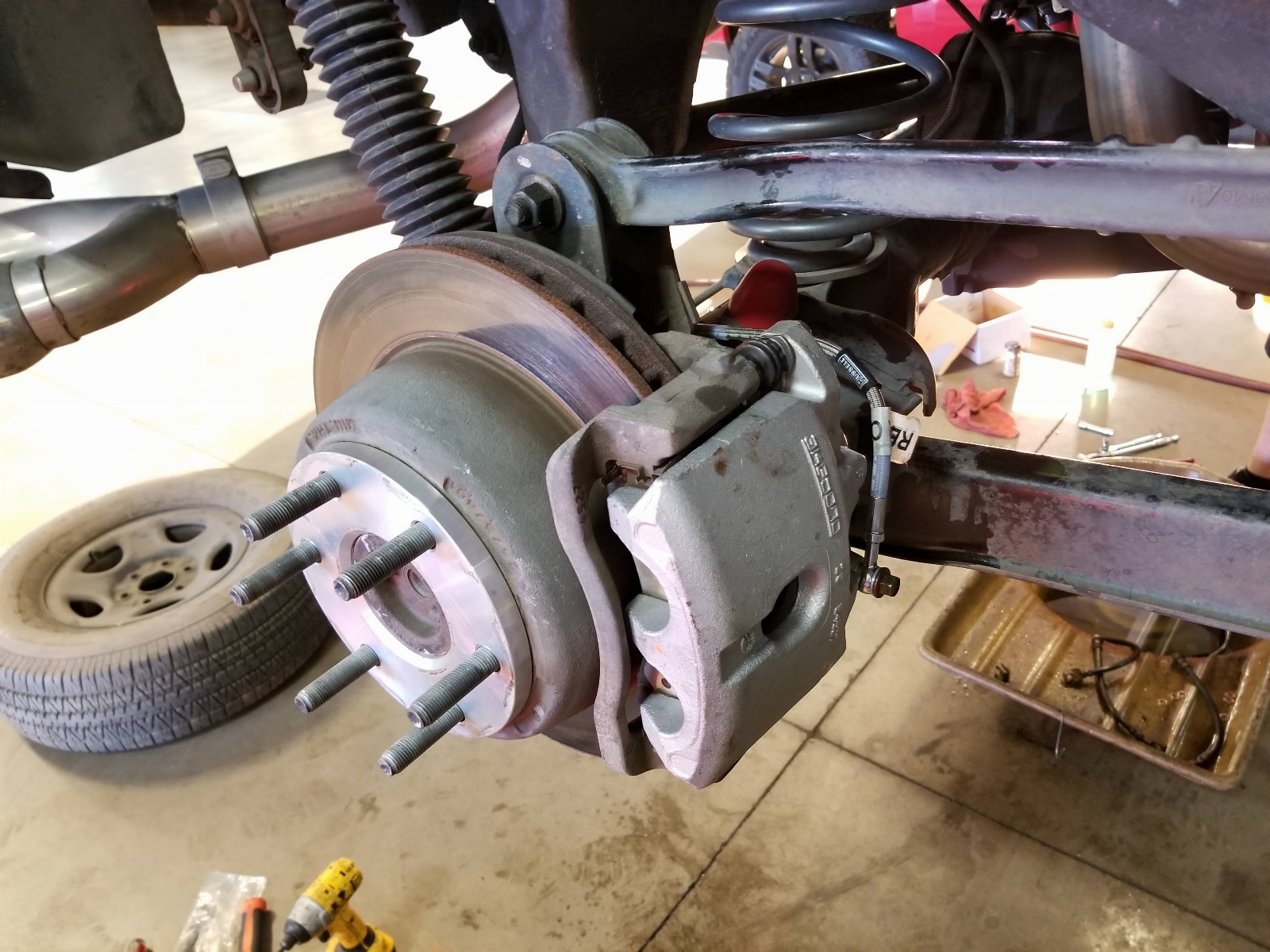

So while the Tahoe was with my roommate at the dealership he went ahead and started to put my SS brake lines on as a surprise and then my surprise turned out to be a text saying that my fronts were done but the rear caliper bleeder screws had both snapped clean off.
So off I went after work to O'Reilly's to get some reman calipers to replace them.

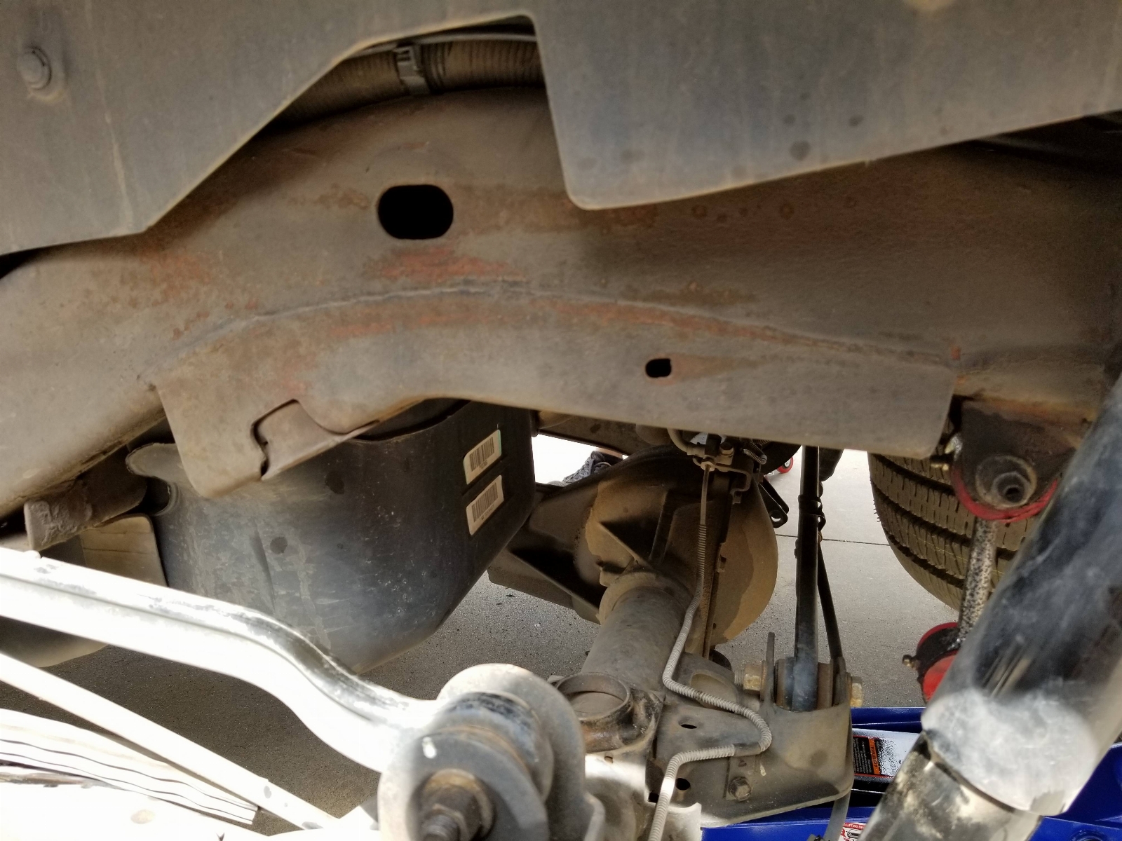

While I was poking around I noticed a couple of things. 1: I still haven't put my new front end links on my new sway bar and 2: My tires rub my new sway bar and probably the old one so I may try a 1/4" spacer up front since I don't plan to change to a wheel with a different offset.
Still to come this week? Panhard bar, more tuning, a good interior clean and if I get really saucy then front UCAs and an alignment to match.

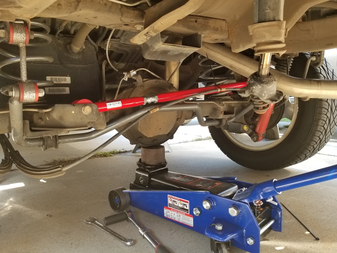

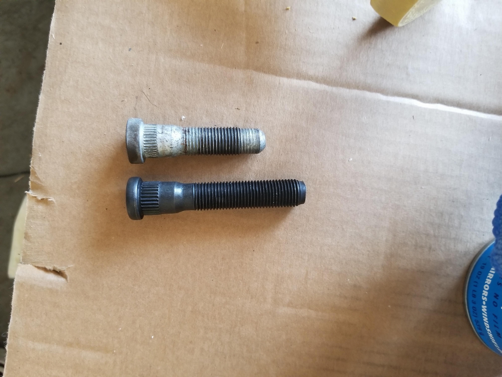

Didn't get a lot of pics today because I wasn't planning on doing most of what I ended up working on and I was covered in grease pretty much the entire time BUT I went out to swap my panhard bar after getting the correct one in the mail and got that installed. Very easy job for anyone wondering and adjusting it is very easy as well.
Then I decided to put the 1" spacers on the rear that came with my lowering kit to see if it would improve the ride in the rear even more and it REALLY did! I didn't get any pics but it's kind of boring seeing 2 plastic donuts get put on springs. This also gave me back the raked look that I love and while I was doing that I had to pull the wheels off. While doing that I decided I would rotate the tires since it had been too long since that needed done anyway and while doing that I decided I'd just go ahead and install the new DJM front upper control arms.
They look good, they seem to work well and overall the Tahoe does feel much better now. I want to talk some shit on DJM though because one of the control arms was not powdercoated very well, it was already flaking off in multiple spots NOT from poor handling in the box and during install a lot more came off so I just hit it with black spray paint to keep it from being exposed bare metal. In addition to that both the lowers and uppers all had powdercoat in the threads for the grease zerks which makes for a lot of unnecessary work to clean out the threads just to you can install the part when someone could spend 5 seconds putting something in the hole to prevent it in the first place.
