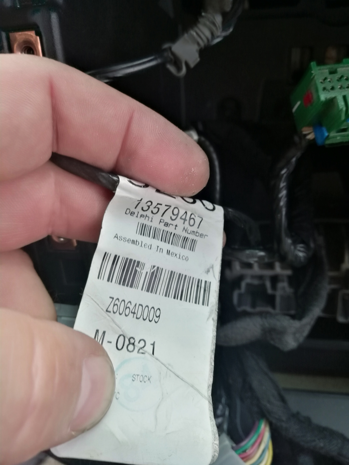

For a month now I am the owner of a Tahoe LTZ with a third seat in front. That means my Tahoe has no center console like many others. Look at my pictures.
I noticed that my speakers in the back doors are not sounding. So today I dismantled the panels and removed the original Bose speakers. Many say that moisture can break these speakers very quickly.
I will convert JBL in the front as well as in the back and also replace the tweeters in the front with JBL. So far no problem. I have many car stereo systems built into German cars as well as my Chevy S10 Blazer.
Now I also plan to replace the radio with a double Din radio with touch screen. There are many interesting videos on YouTube. Now I have upgraded the original radio and found that below the radio this Bose amplifier was placed.
I suspect that can not be. Because if you look closely, the crossbrace bends very strong here. So this amplifier would have to sit somewhere else.
Also, I found a wiring harness in the drive bay you see below in the picture. He has a sticker with a Delphi original number on it. I have absolutely no idea what these plugs do and where they belong.
I suspect that here at the delivery of the car possibly a different radio was installed. But I can not test that. Or do you experts have an idea what these 4 plugs have for a function and where they belong?
You can see the carpet marks where that vehicle use to have a center console. In that center console the amp use to sit.
And what is that comic dome in the middle of the dashboard. Is this the remote control antenna?
That's the sensor to turn on your headlights automatically
Thank you for this first information. I have to look closer because there is an small floor mat where i think the third person step wit the Feed on it. It should be there somewhere because the wires are not to long i think. I have too proof.
But what was the reason to place the amp there where it now is in the Dashboard, I have no idea what sense would stick behind this installation.
