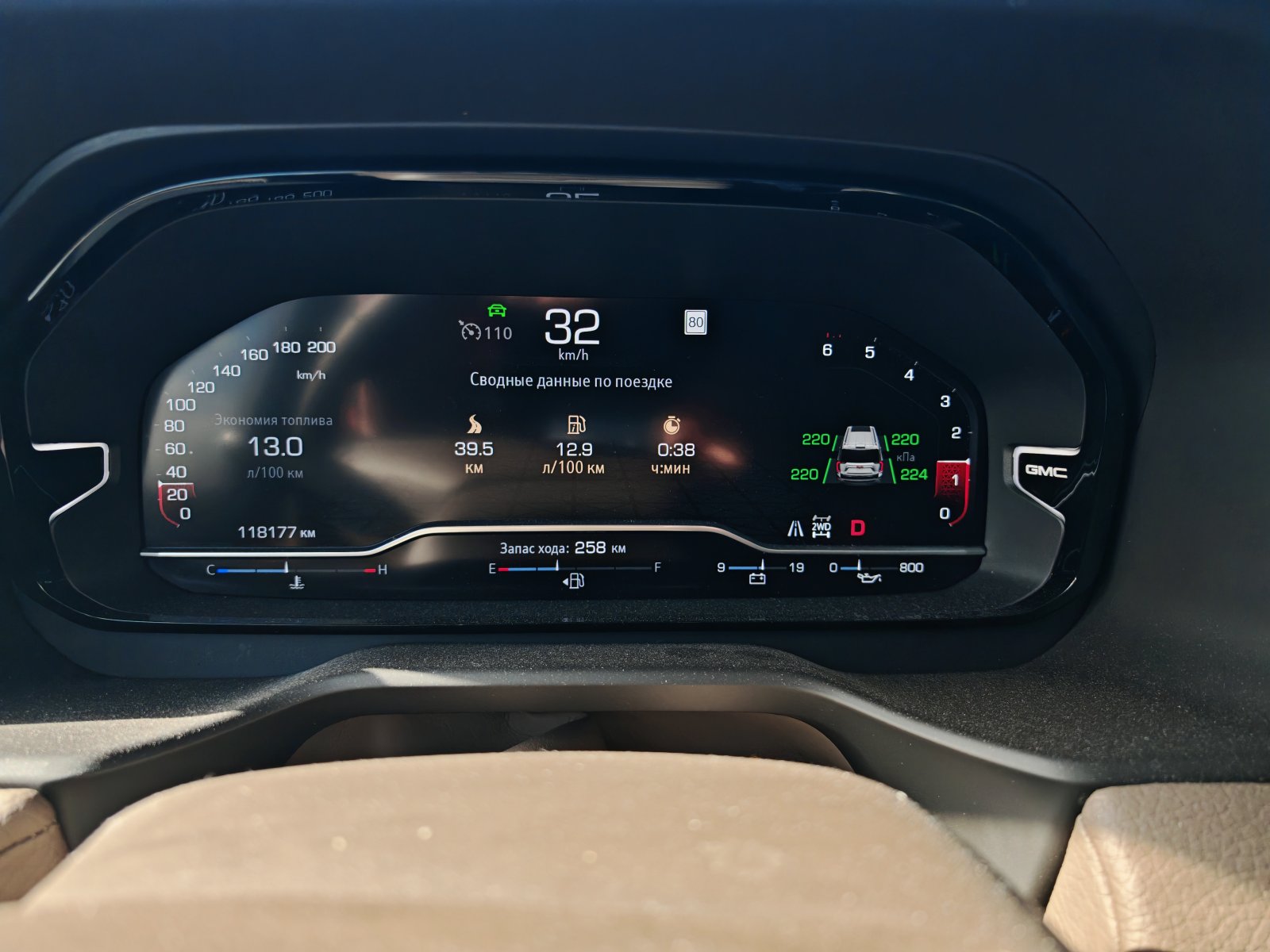

I'm not talking about my Yukon, the guys at the service did oil analysis when changing several cars. There is some significant amount of fuel there. We also have traffic jams in Moscow, and the average speed in the city is 15-17 miles per hour. I use my Yukon every day, I take my children to school in it every day, and I drive to work.
Yes, I try to avoid traffic jams by changing my schedule, for example, taking my children to school, I arrive at work an hour earlier than the start of my working day, and after work I usually go to the gym and work out there for 2 hours until the traffic jams disappear. Therefore, my average speed in Moscow is 22-23 miles per hour. This is very fast for a metropolis.
Also, our government is building expressways that go through the city, allowing you to drive 69 miles per hour, basically through the city. This is a great solution, greatly increasing the average speed. So there are days where I get to work in 40 minutes, driving almost 40 km, at an average speed of about 60 km / h, or 37.5 miles per hour.
having received an average fuel consumption of 18.23MPG in the city of Moscow)
