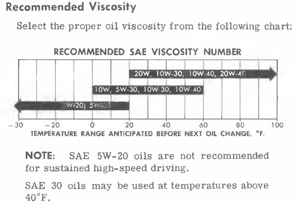

Anyone here have access to factory service manuals? That ought to clarify things a bit more
Examples from old GM manuals
My Tundra manual looks alot like that--exceptions for 0w20 based on ambient and load.

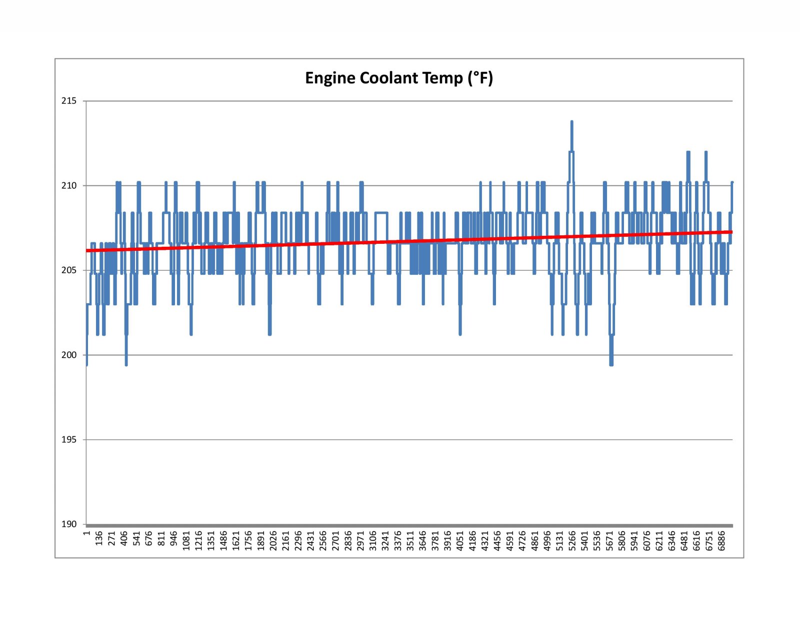

Engine temperature 224F? Are you confusing it with oil temperature? Our engine is cold, compared to 6.2 on K2. There the operating temperature was 100C, 212F, and on T1 the operating temperature was 93-95C, that's 200-203F. 224F engine temperature is a lot, it could be engine overheating.
Good catch. No confusion, was supposed to be Engine Oil Temp, my mind was operating faster than my fingers. Corrected the prior post.
The problem is this vehicle is even optioned with the Max Trailer Towing package which is has a larger radiator, but unclear if the internal oil cooler is any larger or more efficient than the standard radiator. Interested to see what happens to the oil temp temp once the outside ambient get in the upper 90F to 100F and the asphalt roadway is in the 130F range after baking in the sun all day and I am driving for 6 hours straight.
I do not have one of these trips schueduled yet, but in the next few months the weather conditions and ambient temp will be getting higher so I will likely have data for at least a 2 hour plus drive to see what happens with the oil temp.
As for Engine Coolat Temperature, I think the current genration vehicles operate a bit higher in temperature than you state. While I have seen in the low 200F's around town, on the highway, this is the graph for the same run where my Oil Temp topped at 226F.
The average Coolant Temp was around 207F with a peak around 213F.

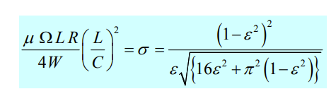

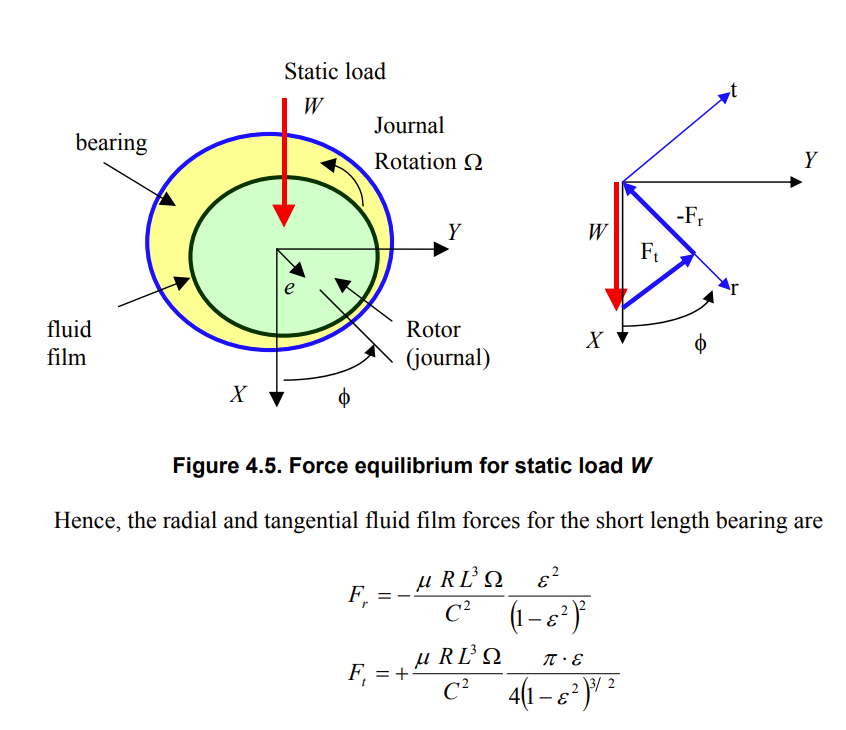

Oil viscosity is related to rotor eccentricity. Too much eccentricity and you have metal to metal contact. Too little eccentricity and you get high bearing temps and vibration problems (the kind you don't feel in your seat but will wreck a crank and bearings nonetheless).
This is all connected via the Sommerfeld relation:
Eccentricity term is on right hand side. Sommerfeld number is on left hand side.
u is viscosity, omega is rpm, W is load, L is bearing width, R is bearing radius, C is bearing clearance.
You can see there is an L^3/C^2 term here where eccentricity is suuuper sensitive to clearance and width. This isn't an issue in this discussion about viscosity.
What is left is viscosity, Load W, and RPM.
Through iterative approaches the following can be said.
Any term in numerator that increases will reduce eccentricity.
Any term in denominator that increases will increase eccentricity.
So...by only increasing rpm, the eccentricity is reduced. Therefore reducing viscosity will counteract this and induce eccentricity. So if your application is constant high rpm it would actually favor lower viscosity. Oil cooling will need to be tightly controlled to keep this situation under control.
Increasing load will increase eccentricity. Therefore increasing viscosity will counteract this and reduce the eccentricity. So if your application is for towing or accelerating uphill or a super heavy SUV, the load is high at every RPM. Therefore, this would favor higher viscosity to reduce eccentricity.
Worst case is obviously high loads and low rpms. This would give maximum eccentricity. The oil wedge reaction force against this is dependent on the viscosity.
This is a "use case" that is very typical of SUVs and trucks but also drag racing. So with high loads and low rpm the viscosity must be higher to keep eccentricity managed.
Downside to running viscosity too high (SAE 50+) in these situations is cold oil...therefore the mutli viscosity grades are helpful in giving a range of viscosities keep eccentricity from getting too low and causing vibration if there is extended low load, high rpm situations while oil is cold.

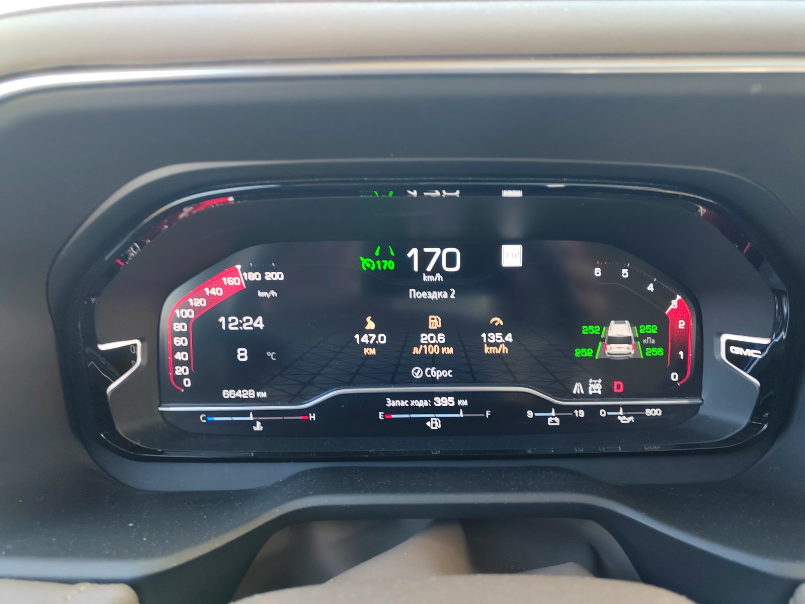

It seems you drive you vehicle very differently than many of us here in the USA. There are few places people can drive constantly at 90-105 MPH on the highway without being quickly followed up by traffic enforcement and at these speeds you can and will lose your drivers license and the insurance prices may increase and/or you may be canceled. I woudl say most drivers in the US depending on the local posted speed limit may only travel 5-10 MPH higer than than the posted speed. So this typically at most wil be maybe 80 MPH, more often I would expect the "Average" speed most are traveling on the US roads is between 65-75 MPH because many Interstate posted speed limits are 55-65 MPH, some are higher but it is more "State" dependant as there is really only a "National" 55 MPH mininum speed limit these days. Many years ago, the US had a "National" 55 MPH speed limit maximum.
So this being said, a the engine RPM you are operating at is in a better range with less low RPM "lugging". Additionally with the higher RPM and oil temperatures you are likely burning off any fuel contamination in the oil.
I also assume at these speeds and higher RPM that the DFM may be less likely to function unless you have it bypassed. Would also be interesting to see if you are triggering the 2nd stage in the oil pump on a regular basis at these speeds.
Do you typicaly use Trailer Towing mode when you drive at these speeds or when you are towing your trailer?
I also recall you mentioned that you had no problem getting Premium fuel in Russia, is this correct and what Octane rating is typically available?
Do you have any data for these 90-105 MPH drives that you can share?
It is clear that I drive completely differently than the average American)) Fortunately, our toll roads in Russia allow us to move between cities quickly and comfortably.
The photo shows the revs at a speed of 170 km/h, which is about 105 miles per hour
But you just said above that it is fast driving under load and in the heat that kills the 0-20 oil. Well, it doesn't kill anything. The oil works fine. I repeat, I have 75k miles, and I change the oil every 7500 miles, without resorting to early oil changes. The only thing is that I change the fluid in the automatic transmission and transfer case and axles every 30K miles.
Yes, and I fill up with petrol grade 95 in Russia, which is about 91 according to the American standard. So there is nothing unusual, I just follow the regulations prescribed by the manufacturer.

Just curious. What are the average high temps where you live ?
Just like any thermodynamic system, total temp = ambient temp + temp rise from power dissipation. Down here in TX where summer days are 100F and warmer a couple of months, on my old trucks I definitely use the higher viscosity option.
I live in Moscow, Russia, it is a city with a moderate climate, in the summer we have up to 80+95F, in the winter it can be up to -22F. At the same time, I travel a lot around our country, visiting regions in the winter where it can be -50F, and in the summer I go to the Southern regions where 100-115F is not uncommon))) but my main place of residence is, as I said above, a region with a moderate climate.
