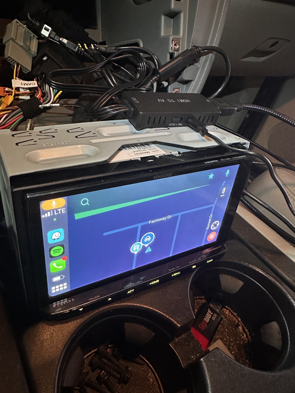

Okay confirmed it doesn’t have dual output but I don’t really care about that because it allows display to the rear screen while having car play up front
I simply had to use the av in and not the hdmi in

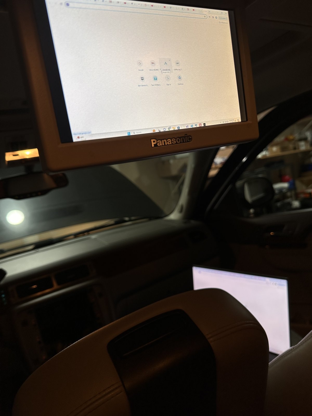

CarPlay in front and my laptop to the middle screen
I will just need to wire up the rear screen now and I think I’m good with this head unit it fits my needs
