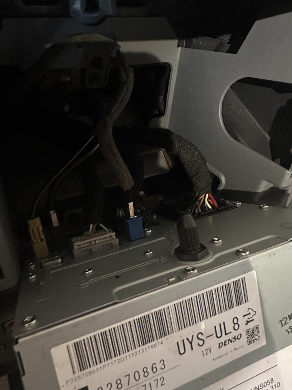

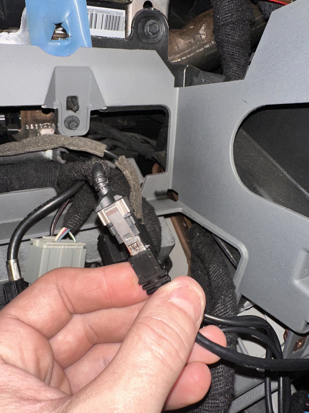

What does the blue connection do?
ls1frc
Aug 10, 2019
923
1,352
Identified all the others but not sure what this blue one is for

If this is the amp I’m not sure how to connect that with my maestro and other harnesses
L
ls1frc
Aug 10, 2019
923
1,352

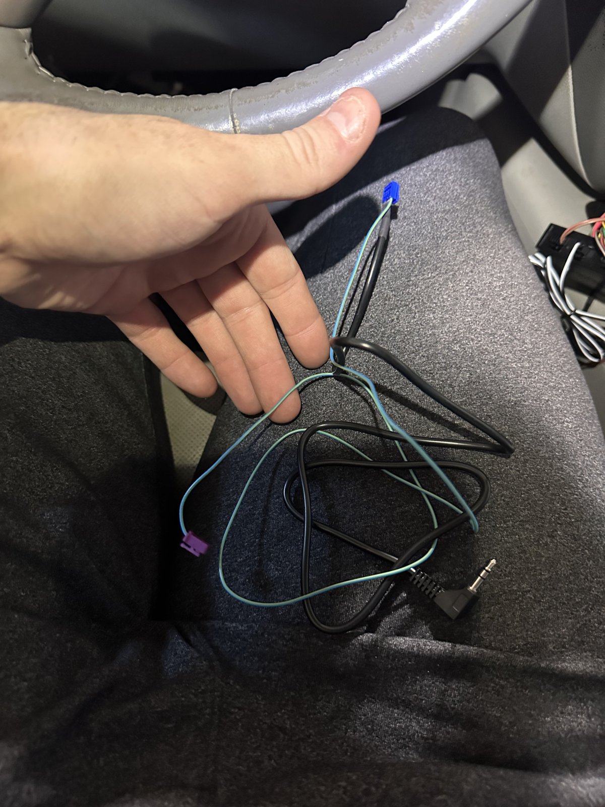

Okay it must be this. I lost it in the sea of wiring somehow. But that still doesn’t connect this factory blue connection
mikez71
Mar 9, 2023
3,220
3,985
Is it a coax cable? GPS antenna or something with rear entertainment maybe?

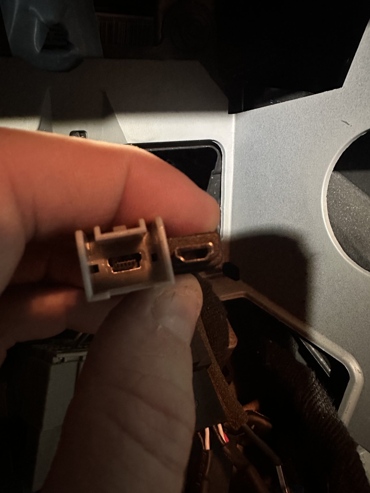

Now just to figure out the factory usb it seems I got the wrong adapter
L
ls1frc
Aug 10, 2019
923
1,352
Yeah shape is all wrong. It said a mini usb to usb would fit

30,546
47,996
I bought this one
It just looks like the metal shape is different
it's just mini usb, the plastic part is what is stopping it from inserting all the way, but the adapter you bought should work
not a big deal for now just goes to the center console

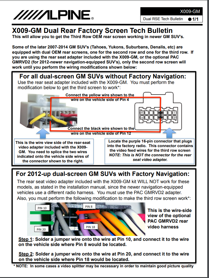

if you have the 3rd row drop down screen that is a seperate issue, 2nd row and 3rd row video have to be patched together to make the 3rd row work

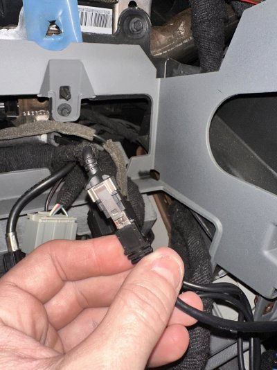

So I got the usb to work. The metal contact was definitely not the right shape. I removed the plastic from the adapter and forced it on. The metal reformed to the shape of the connector and it works now.
This is my next test. Gotta find a mini hdmi device I can test this

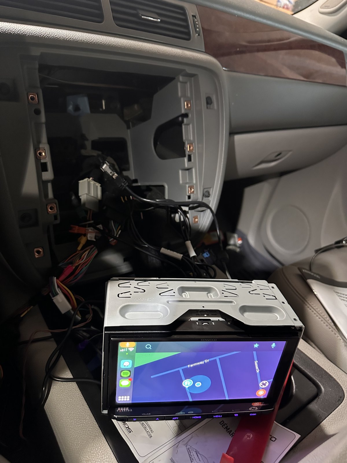

So I got my laptop displaying on the front screen but nothing on the rears. I am not sure if it will only work from the RCA input from the rear of the center console or something. I dont have something to test with, Illl need rca to hdmi converter to test

Pretty over my head with this stuff. Here is how to get the rear screen working
What head unit are you installing there?
30,546
47,996
you need to be sure you have a couple things set correctly
1. if using android auto/apple carplay turn off the phone (this just eliminates any phone interfereance for now)
2. play your source media, then select the menu and be sure mirroring is on usually this has to be enabled every time.
3. go to the rear controls and be sure the source is not set to aux, etc you should be able to toggle thru it
4. if you are not using a microswitch to bypass video in motion, then the parking brake should be set (and wire attached)
the reason I say to turn off the phone because it will disable mirroring and will not let you select it, at least on mine it does.
