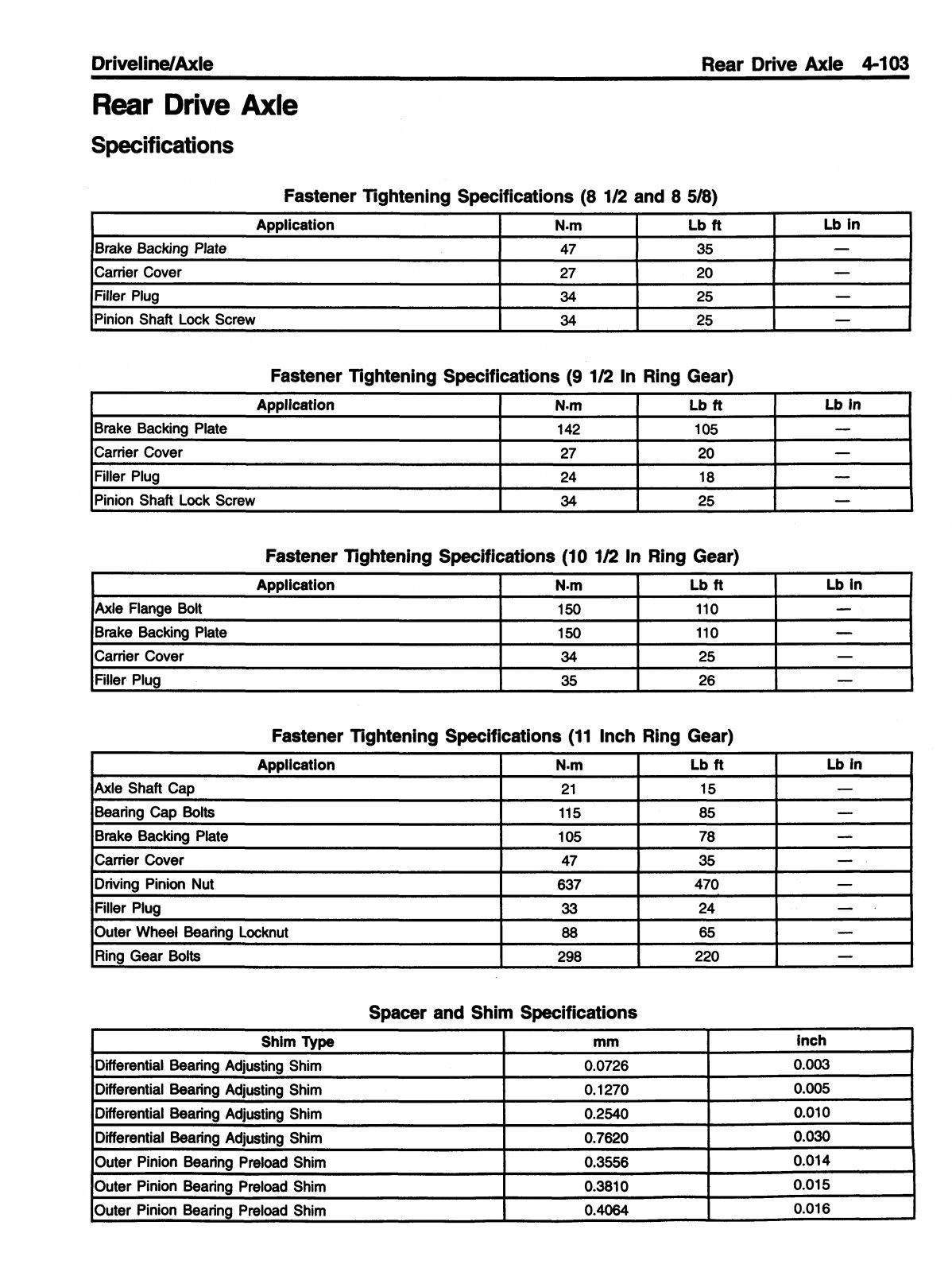

Looks like 20 ft-lb for the 8.5”
(from 1998 manual)

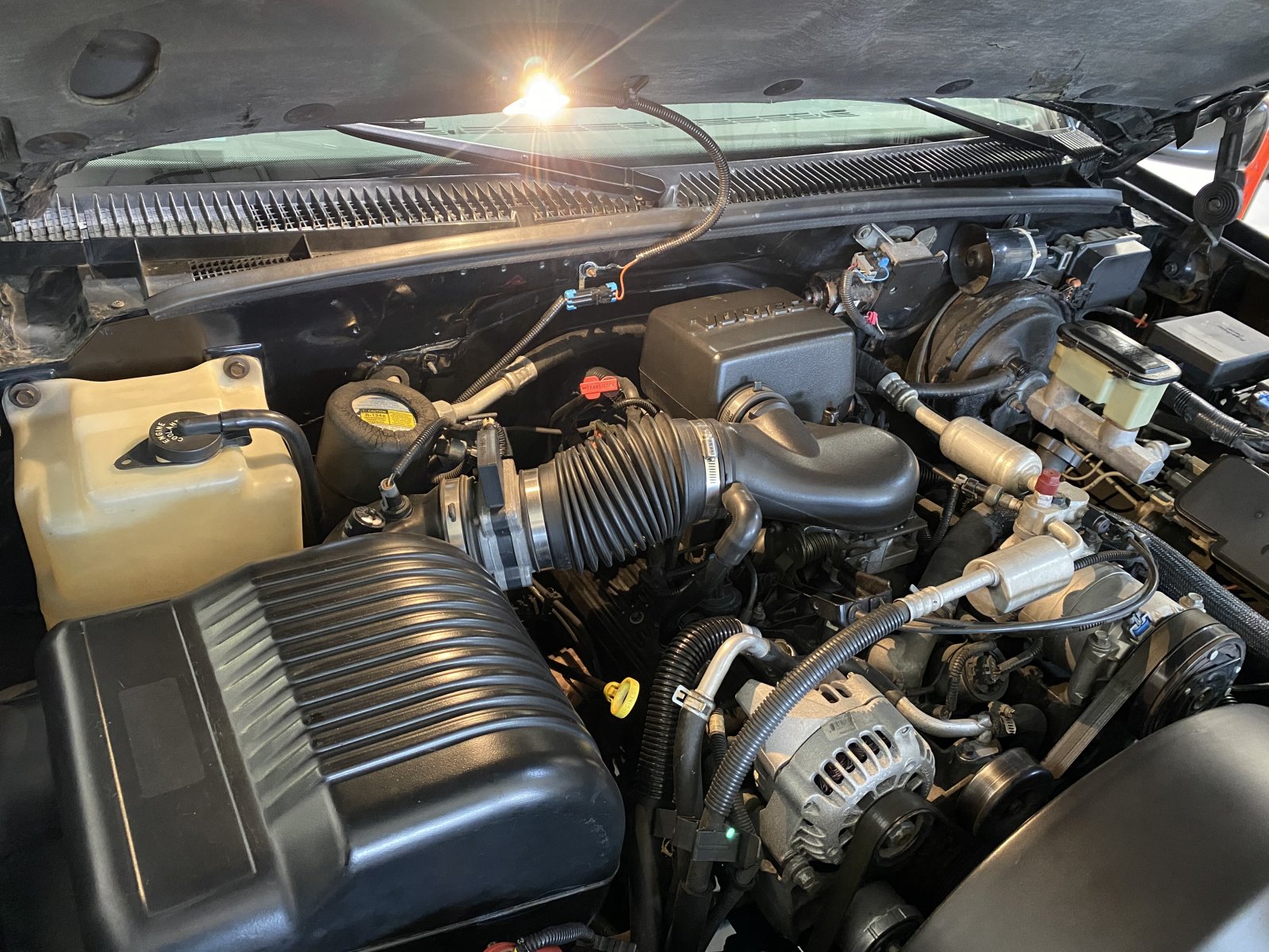

Its was a slow day at work, so decided I would finally try and figure out why my under hood light would not work with a new bulb in it. There was 12v power at the connector. I removed the assembly, and it was a corroded mess. Took it all apart, sandblasted and scotch brited it. Bathed it in ACF-50 corrosion inhibiter, and put it all back together. What do you know, it lit up!

Do you have the light that's on the reel? It's under the hood--sometimes. Comes in handy.
