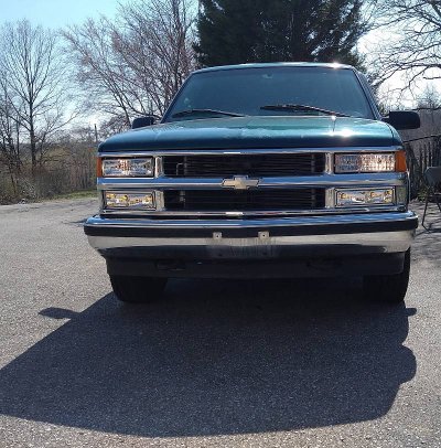

Disco Balls arrived today. First shot is comparison to the old. Second is all four units installed and grille back on.
