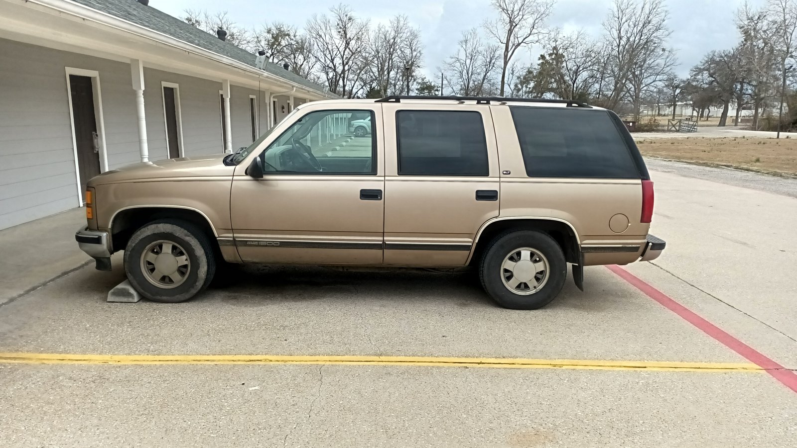

Mechanics Special. I have a 1999 GMC Yukon SLT 2 wheel drive. Started getting antifreeze in oil. Would like to get $3500.​
Best offer takes it. Must sell ASAP.
Very strong Engine, runs really well.
Did not drive it far. Started getting hot, about half way on gauge. Pulled over ASAP. Has not been driven since. I have seen many causes, Head gasket, Intake gasket, Oil cooler in radiator, etc. I do not have the money to repair, was thinking of parting out.
Let me know what you think.

99 Yukon SLT.
2 wheel drive
228817 miles.
Just started getting antifreeze in oil.
5.7 vortec engine.
Still runs and drives.
Trans good.
Front and rear AC.
Upgraded Glass Headlights etc.
4 high mod - all 4 headlights come on when switched to bright.
New Cap, Rotor, and Wires three month ago.
New Tires six months ago.
Tire wear on front right.
Mechanic says no worn suspension components, alignment specs dead on.
Rebuilt AC Compressor around 1 year ago - still around 2 years on warranty.
Rebuilt alternator - O'Reilly lifetime warranty.
CD player still works.
Everything else works, Windows, Mirrors, Heat, AC etc.
Paint on roof just starting fade.
Would like to keep her out of the scrapyard.
By the way this is located near McKinney Texas. if anyone is interested.
