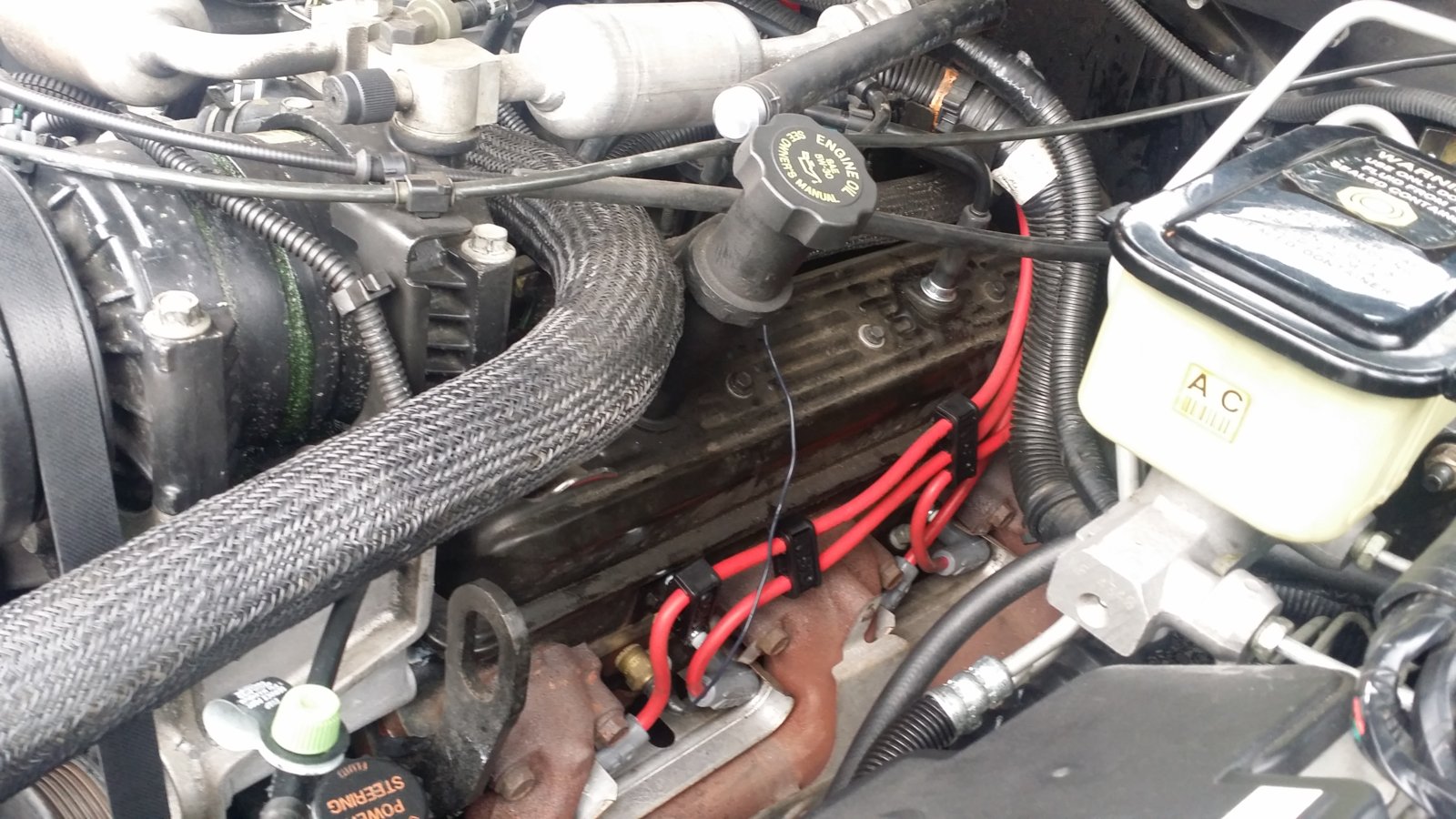

Clean the throttle body (was really gunked up)
New ac delco iridium plugs
Msd 8.5mm wires
Msd cap and rotor (lots of corrosion in the old one)
For sure none of this had been done in the past, all original stuff.
Was not a lot of fun mounting the msd wire clips. I ended up drilling holes in the tabs that held the stock clips and attaching them with m6 nuts and bolts. I'll add a pic tomorrow. Turned out pretty good i think.
Squirrelsmith
Jan 21, 2018
914
790
Was not super impressed with the lengths. Some could have been shorter and some longer, the clamps weren't exacly the perfect assortment either but i made it work
