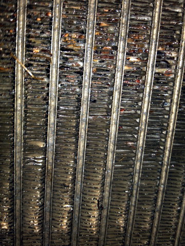

Lets see...Been a busy day here...One thing lead to another...but it had to be...
The evaporator core was a little plugged...

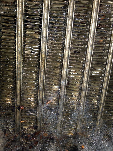

A little simple green and a hose...

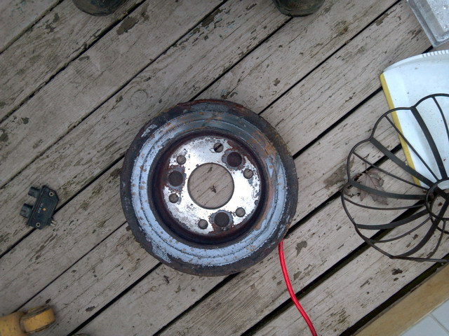

Replace both front rotors, new pads..and was missing a caliper bolt...
Replaced the fronts...didnt have time for the rears.

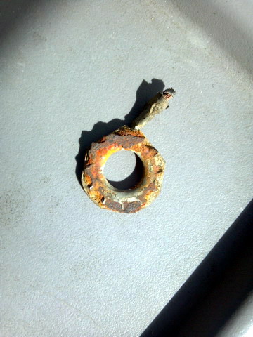

Replaced the fuel pump ground...this was causing intermittent no starts and stalls. Running like a top now.

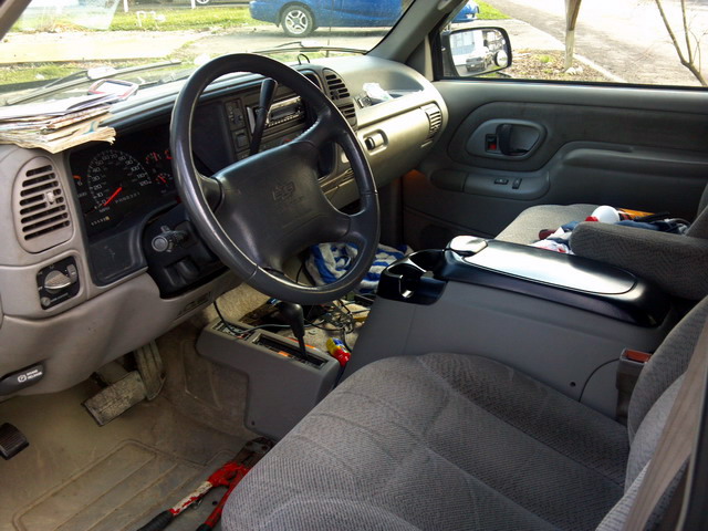

Fit in the new console.
