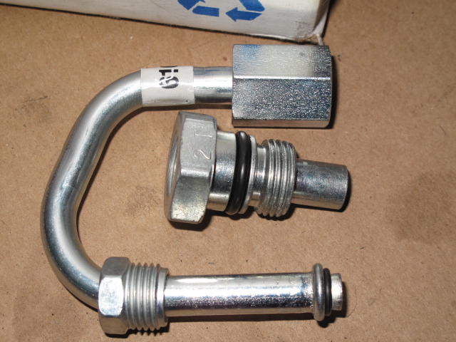

Here is the idea I use. I would pull the components or buy them based on a burb of the same year but built with a hydro setup. You would get the pump (the one you linked looks good.) booster, MC, and related hydraulic lines for the ps system. Brake lines and wheel cylinder would stay the same. As for the Evo most people just put on a bypass piece on the pump for it. However if it is found that the Evo of the burb setup has the same part number as yours then it should continue to work just fine. The abs should function normally. Because the pressure in the brake lines is much stronger I would replace any flexible hose that shows any signs of cracks on the rubber material. I f they look fine then you can continue to use them. I had someone get me a junkyard booster to use but it had a piston seal leak so I used it as a core to get a cardone unit from a parts store.

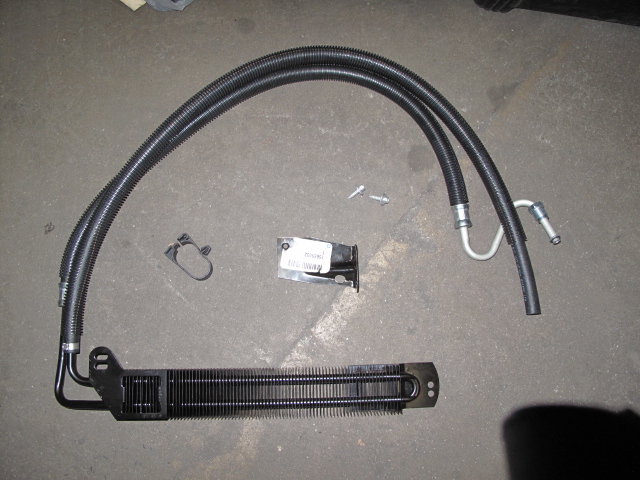

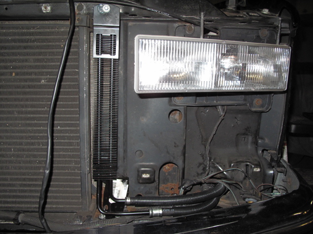

Should also note that the hose from the pump to booster part number is dependent on weather or not the EVO valve on pump stays in place. Either setup runs the line either forward first or backwards first before heading to the booster. And a fluid cooler is required to prevent fluid damage from heat. I grabbed mine from a 3/4 ton burb.

@SunlitComet: Ok, sounds good. I have my laundry list almost done and suppliers identified. Here is the link I found on Amazon for a Universal PS oil cooler. What do you think about it? Or is there something better I could get?
