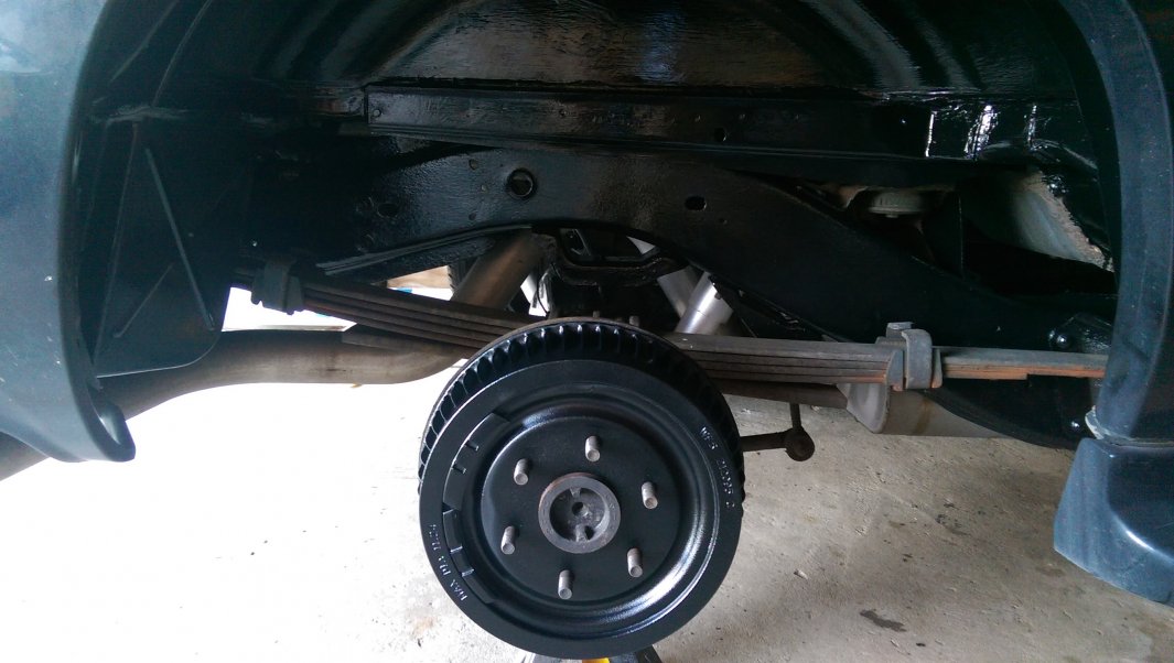

Finishing up on painting the frame/wheel wells/drums
