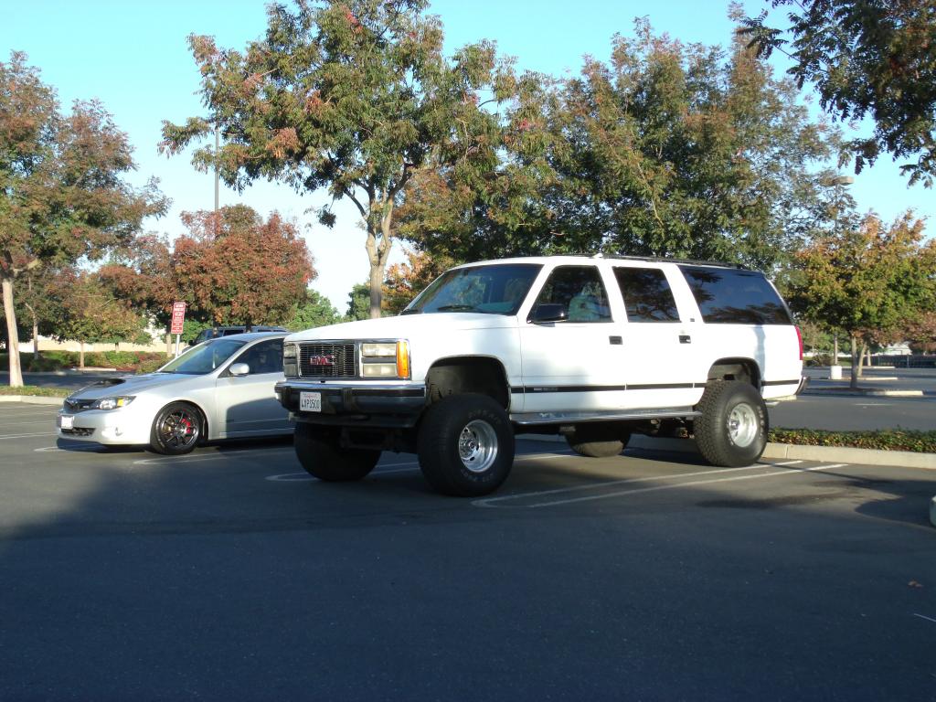

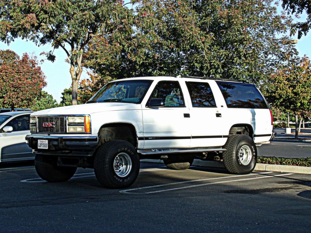

Well, first let me start off by saying.... Looks whose back! Picked up a 1993 Suburban for my Pops and looking at a 99 Tahoe this weekend for myself. Cant wait to ditch my WRX and be back in a Tahoe :)
Here is a pic of my Pops Suburban by my WRX at a local car event

Nice welcome back knew you werent gone. Shoulda picked up the 2dr tho.. you getting another 2dr?
