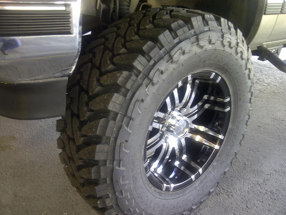

Baby got new shoes.
American Eagle 18x9 wheels and 315/70/18 Toyo Open Country MT's. Toyo said they are 35.7" tall when mounted but not installed on the truck. They were actually 35" even, mounted but not installed (don't know what happened to the .7"). They only squated 1/4" when installed. I gained 1" of height over the 317/70/17 BFG AT's.

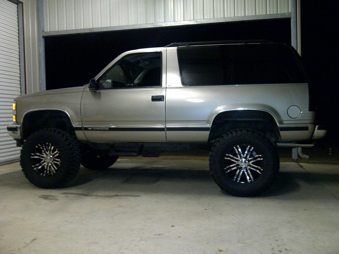

Started the body lifting. Tomorrow gonna lift it and install the hardware. Its not as intimidating but the damn fan shrouds pissed me off.... I accidently hit my new radiator n bent some metal thingies and a brittle vaccume line snapped so i will have to fix it... Who uses plastic for vacume lines that will turn brittle...

SPLmonster13
Sep 23, 2010
317
Texas
Fan shroud pissed me off bad.

Baby got new shoes.
How much lift are you running?

U did the body lift? Anythong i need to know so i dont **** up anything else?

Yeah I did the body lift. The steering extension acted like it was gonn be a PITA but it was actually easy. I'm push button 4WD so I didn't have to worry about shifter linkage. I've heard that's a b****. The shroud gave me the absolute most trouble, that and relocating the rear bumper.

Ok yea im floor 4x4 its just gonna sink a lil not a problem. Howd u get the shrpud back in?

How much lift are you running?[/QUOTE]
6" Rough Country RCX is all I have. The taller tires clear everything easily.

Looks damn good!
I'm about to throw the rcx on top of my 3" body.
I just used the extender bolts it came with, and took my time...

Did u have to remove the clutch fan? I think im gonna have to and i should have to do some trimming i believe
I did have to notch mine for the lines, but I didn't remove the clutch. However, I've known some who have
