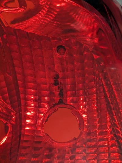

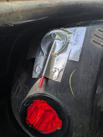

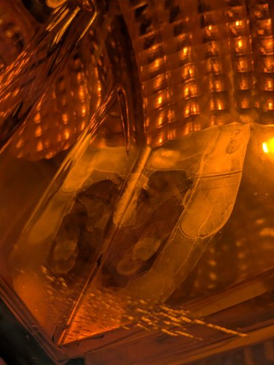

I'd been noticing a teensy bit of moisture buildup in the right taillight, then we had some heavy rain and the teensy bit became a significant amount. I pulled the taillight and set it hole-side-down on the HVAC exterior unit and it was completely dried out in about 20 minutes. It turns out that the "breather" membrane at the top of the upper reflector had come loose and was letting water in, which eroded the silvering below it, as well as at the corners on the bottom where water pooled. I tried to clean off the staining where the water had been resting, to no avail. Then I fabricated a "breather" using a spray can tube and metal foil tape (let's hope water doesn't get in uphill via capillary action). It looks fine from 12' away, but I know it's "disfigured."
(yeah, there's a weird color shift on the one picture, but it wasn't worth it to get out my DSLR to get the colors right)
