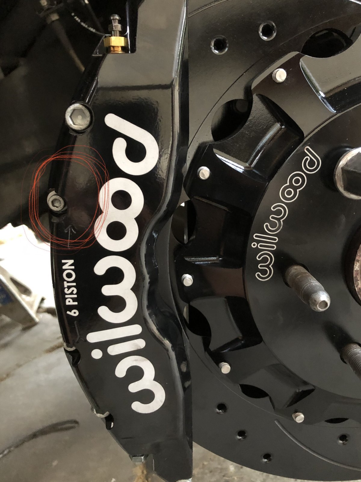

If I remember right, those are done with a 12 point socket. Take a picture and post it. I don't have a good shot, this is the best I have.
The ones on the back side of this pin, I’ll get a better pick tomorrow
