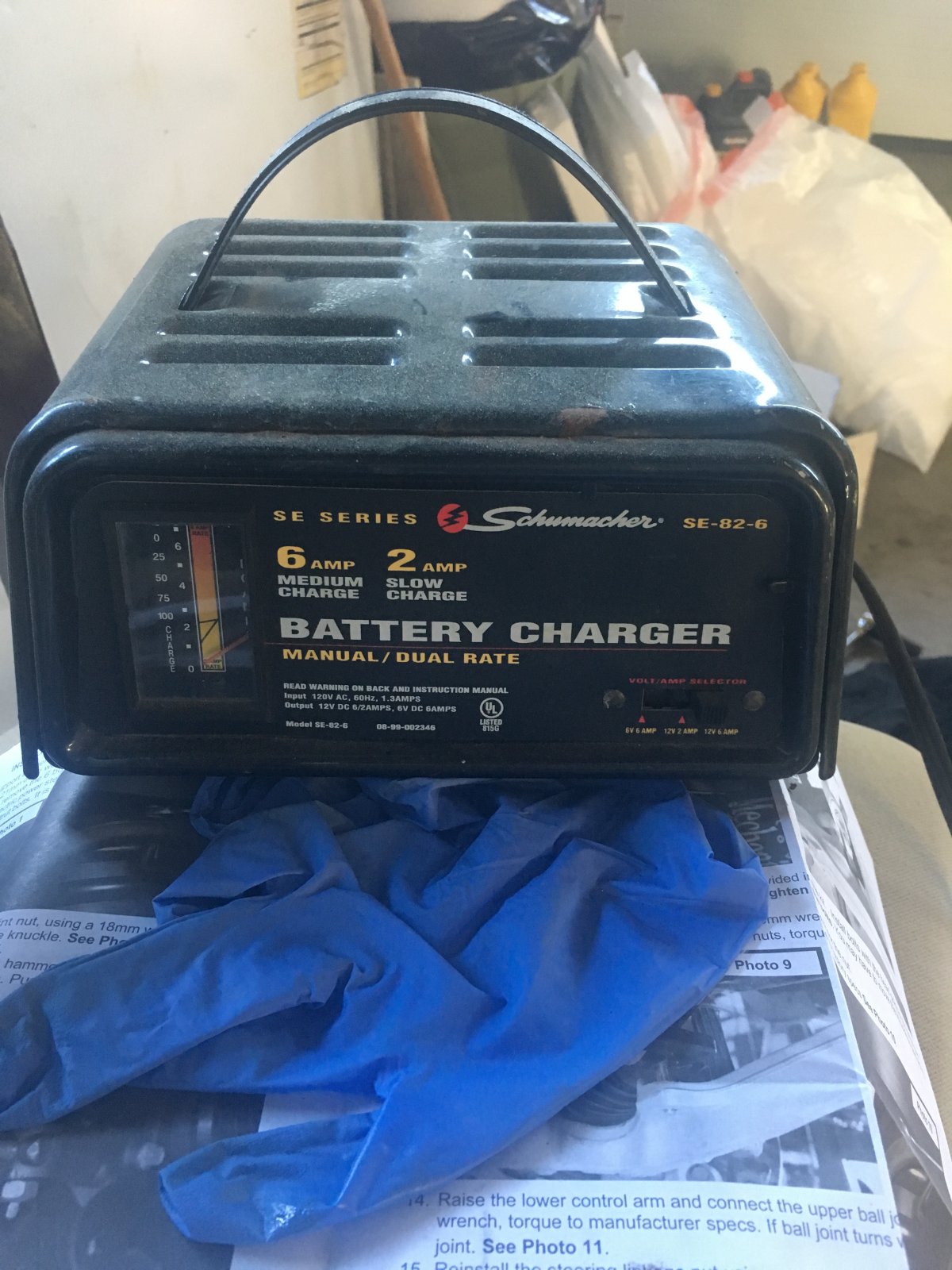

Alright, do you have a charger you would recommend I get?
anything really I like the old school shumacher's, I bet if you poked around on offer up you could pick one up pretty reasonable, I wouldn't worry about there being any new issue's cropped up, it's just that time of year and it sat for several days the alarm alone could kill it if it was already weak.
