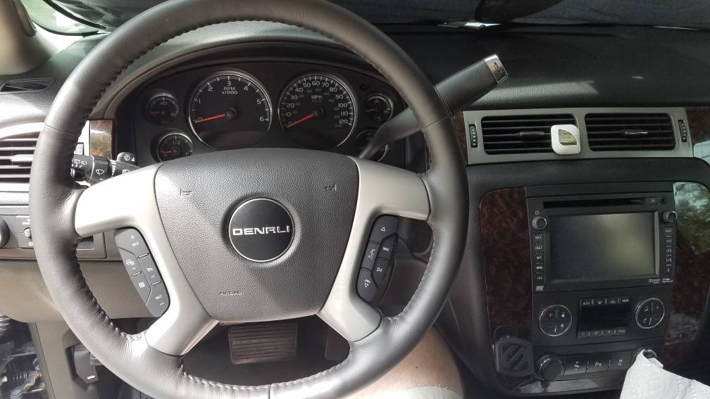

Where’s the pics?
In the steering wheel thread, but I'll post it here also... Lol
