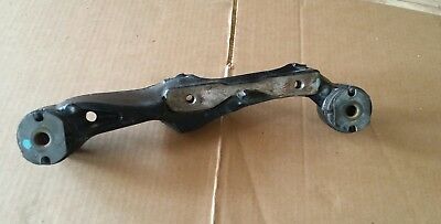

For the passenger side I used a Dorman part # 523-240 (the OEM p/n is 23104735)
For the driver side, there isn't a non-OEM option so I used the OEM one, p/n 23104736.
The driver side mount is a little more difficult to find for some reason, and not sure why Dorman would make one but not the other, who knows. Of the two when removed, my driver side one was definitely more worn out.
Passenger side has two threaded studs that pass through the mount pad on the diff secured by nuts and looks like this:
Driver side isn't as flat like the passenger side, is thicker, accepts bolts that pass through the diff carrier case, and looks like this:
You can buy the four bushings cheaper, but then you have to press them out/in after removing the mounts. A little more expensive, but less work/easier in my opinion to just get the whole brackets.
Not a hard job to do, just a little time consuming (at least for me) getting the driver side bracket out. Less room on that side coupled with a thicker and not exactly flat/straight chunk of metal results in lots of twisting, prying, shifting, raising/lowering of the diff to snake it out. Passenger side is super easy.

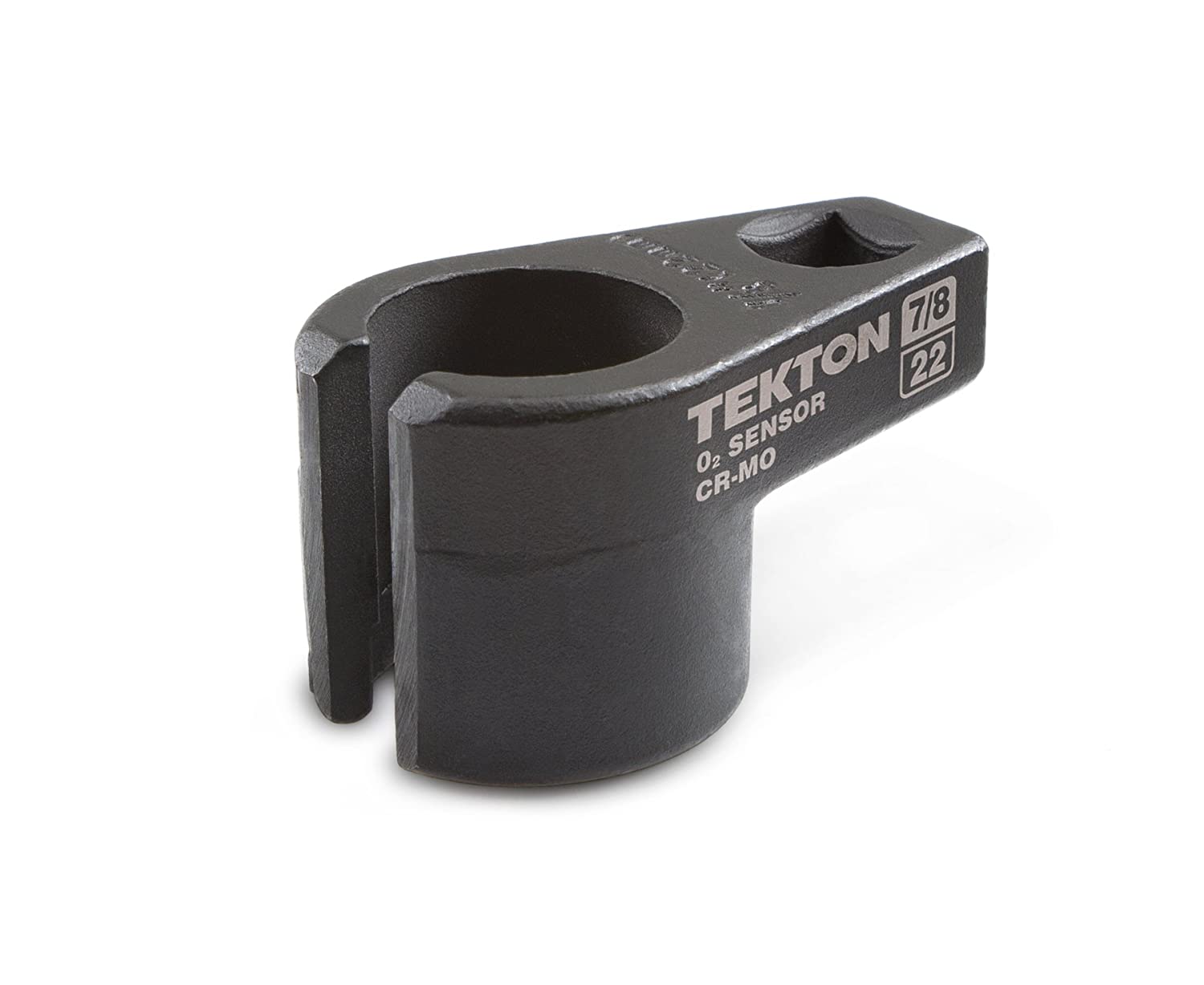

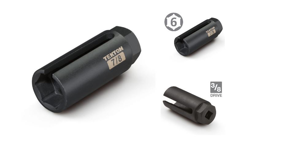

Just changed out the passenger side O2 sensor. Can't get at the driver's side from underneath, will have to go in through the wheel well another day as we ran out of light.
Magnaflow Y-Pipe moved the sensor just enough to make removal all but impossible from underneath even with an O2 sensor tool. Previously, I'd never had a problem with a 7/8" wrench; the engineers always left enough room to get a wrench in there to loosen or tighten them.

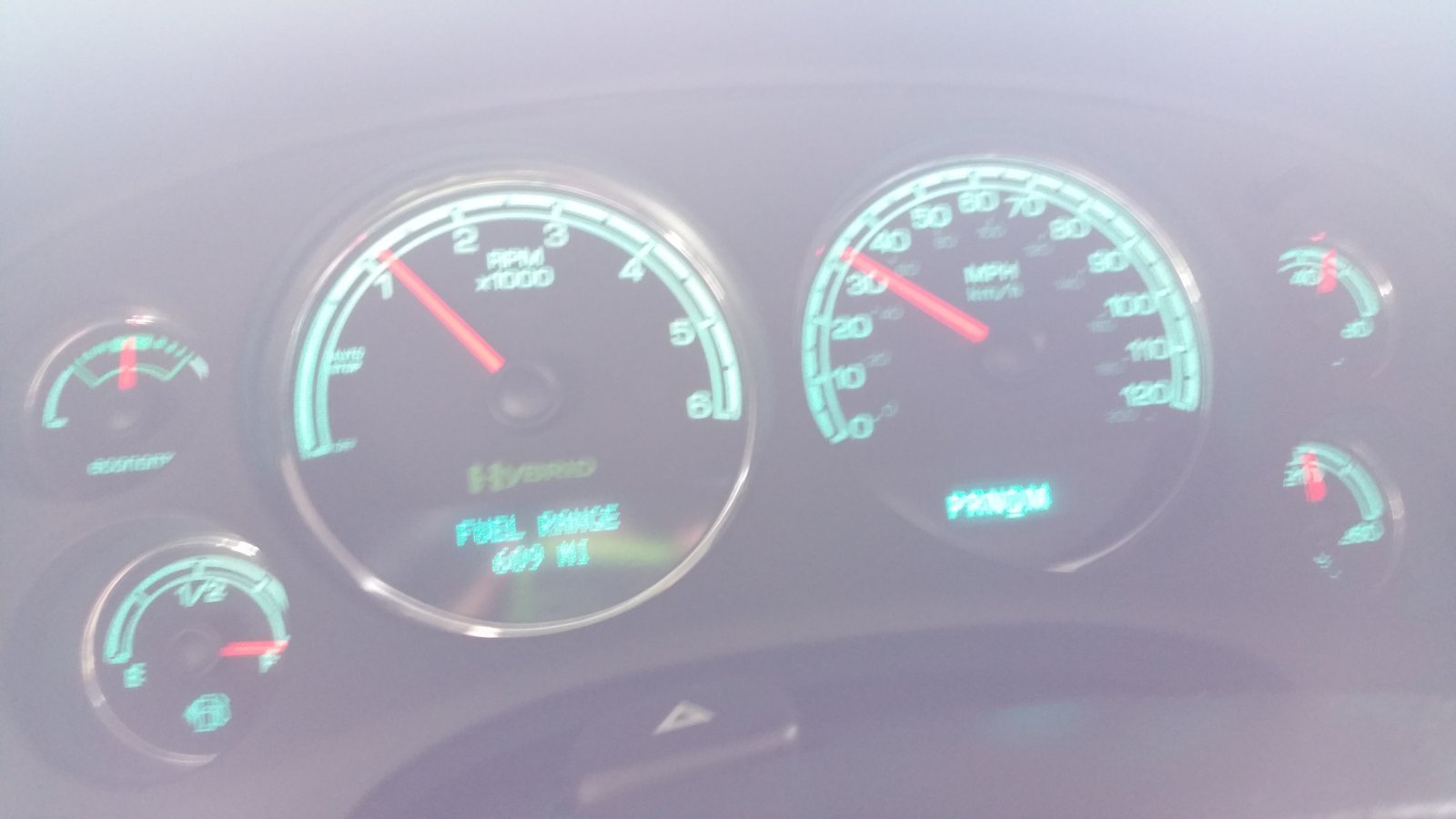

The maximum MPG out of one of these hybrid is 31.2MPG 764.4 miles range :bleh:
on the way to LA I got 31.2MPG :eek: , on the way back 21.1MPG..
Averaged 26.15 MPG
I could have gotten higher maybe 45-50MPG (Those are Toyota Prius Numbers)
if I ran behind a 18wheeler, but that is straight by my self..
Averaged 26.15 MPG
Around the city here I got 48 MPG (Pruis territory)after 24 miles drive it only pumped 0.5 gallons at my normal gas station... with a range of 1,176 miles.
unfortunately it was favorable wind conditions (tail wind there and tail wind on the way back) so that does not really count

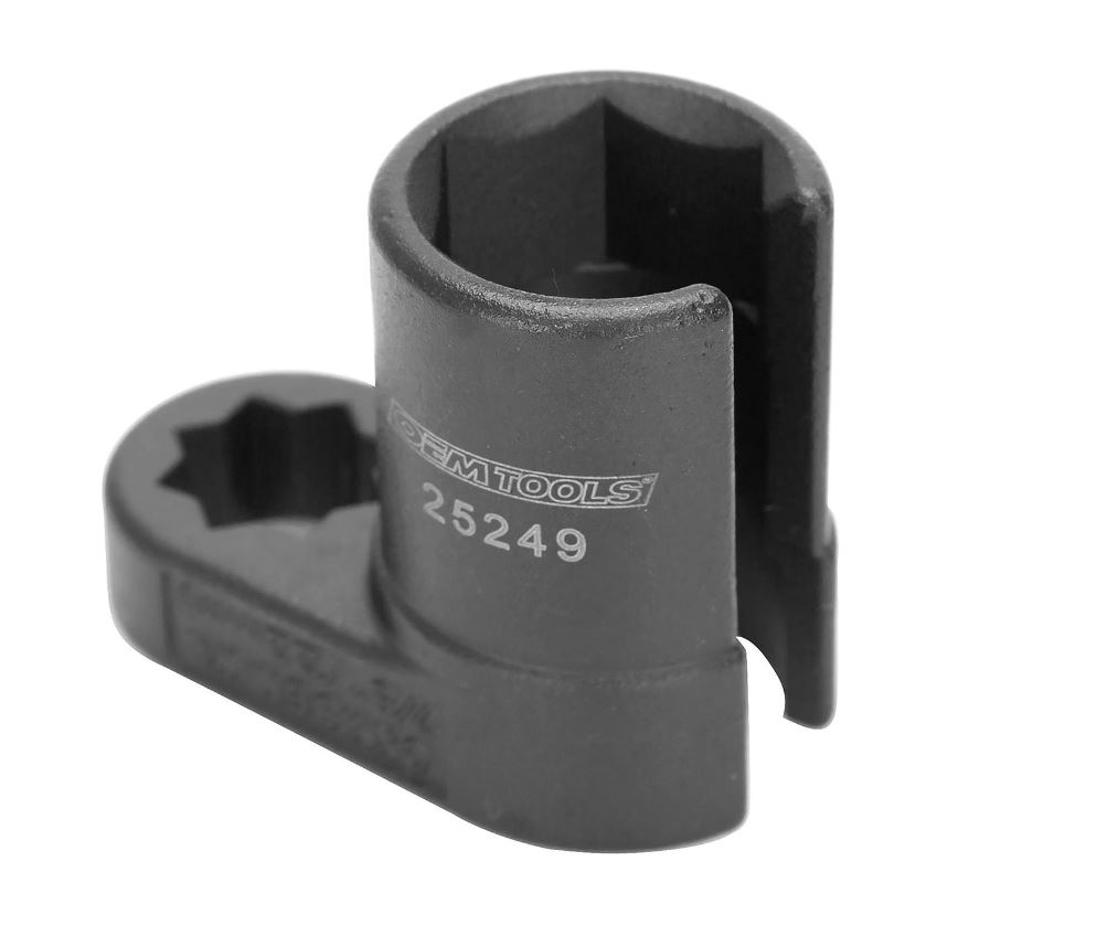

sounds like you might need to use a box end crow foot, or cut a box end wrench in half and hit with a small sledge to break it loose
21,299
30,254
Flare wrench?
No room for a wrench. The O2 sensor socket functions as a crow's foot but there's no room to get a hammer up there to whack it. We did put a swivel and long extension on but the ratchet did not afford the leverage to break it loose. I may try it again with my long 1/2" breaker bar, all we need to do is crack it loose and then remove it by hand. Just need three hands to hold the swivel and extension onto the socket, another at the end of the breaker bar and one or two more on the breaker bar's handle! LOL

I have both of these, kind of had to do a combo of the two putting the drivers upstream back in
